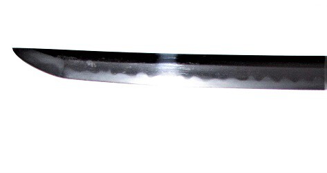

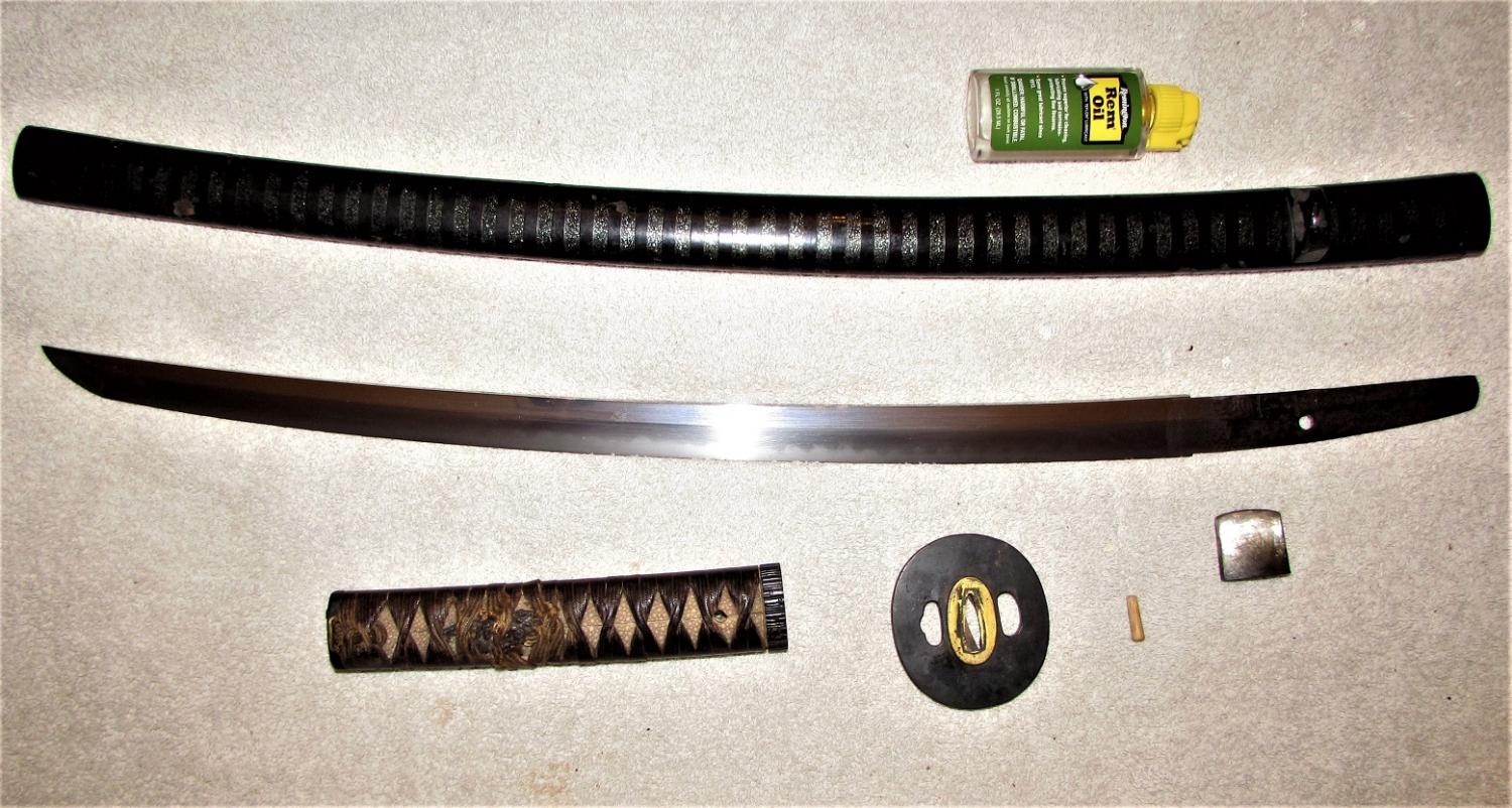

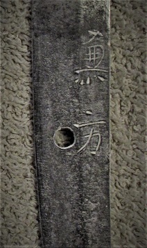

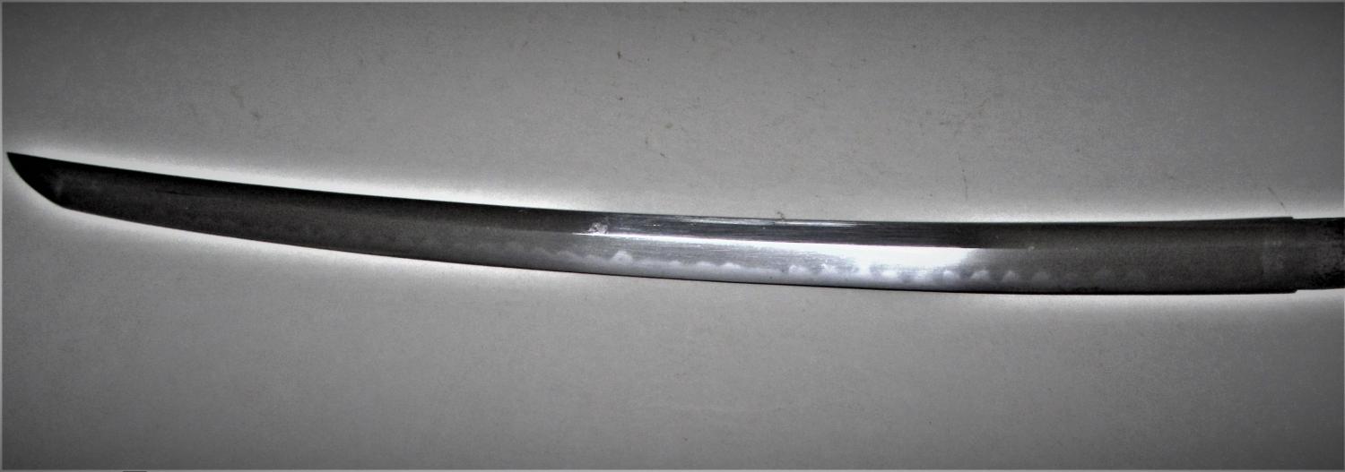

Good Morning to all....  New Acquisition.... Pease see attached as I translated to be Kane Masa.  Cutting Edge is 17 1/2 inches the 1 oz rem oil bottle is for size comparison.  The mounted sword is very petite.   Any ideas as to which Kane Masa and time Period this Mino swordsmith  may associate to?
Thanks
Edward G
Hard to say with so few pics. The shape reminds me of pre kanbun Shinto, but I’m no expert.
What does the sugata tell you about jidai, Edward? Take a look at https://markussesko.com/2015/04/20/kantei-1-sugata-8/-- do you see any that look like your blade? Are the ana drilled or chiseled? Does the hamon pattern continue into the boshi? How many generations of Kanefusa tosho worked in Mino?

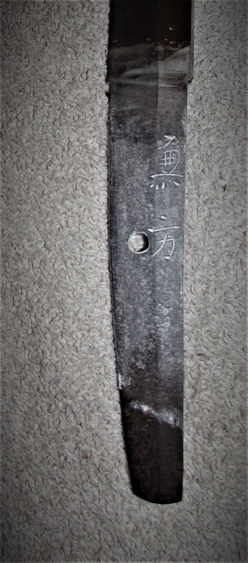

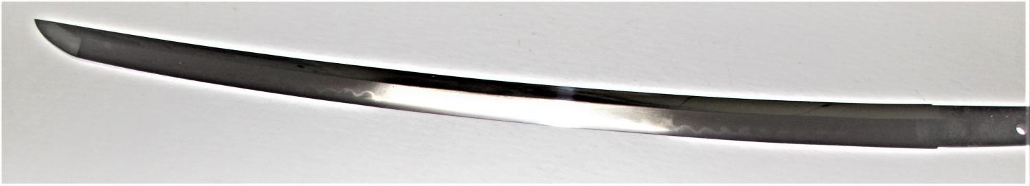

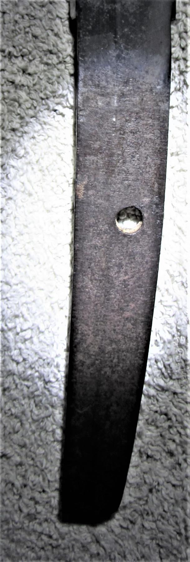

Thanks to Steve M, Ken Goldstein, Stephen C, and Jean Pierre.   I am attaching some additional photos and information, and welcome any comments.  The Mei still looks to me to be KANE MASA as attached information shows.  This sword was acquired from the son of a vet who told me it was stored in a trunk for the last 60 years and he did not know about it until recently, needed money and I gladly purchased it.
Tang File Marks are Kiri...…….Almost completely gone on Mei side
Sword Type Wakizashi Shinogi Zukuri
Sori is 12mm
Cutting Edge is 17 3/4 iunch
Bosi is 25 mm
Hamon is Large Gunome
Mune is Hikushi
Shinogi Ji is 8mm witdth
Thickness of tang at Mune Machi is 5mm
Width of blade at Mune is 28 mm
Peg hole is NOT drilled
Hada is Munji
Noi & Nie are present

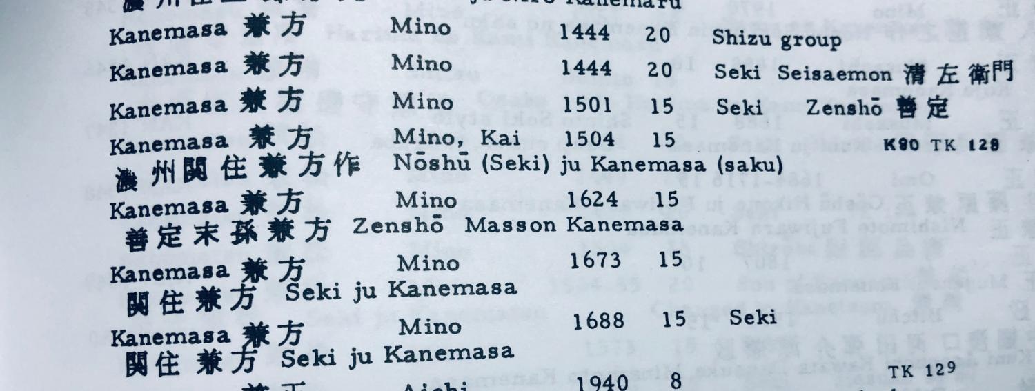

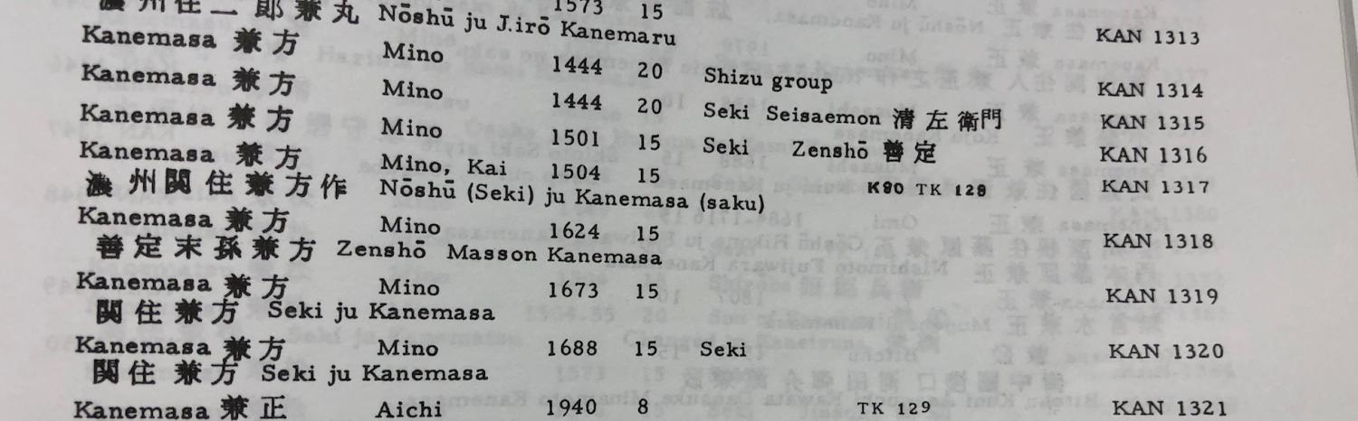

My guess is one of the early KANE MASA listed,  what do you think?
Thanks to all
Edward G
KANEMASA (兼方), Bun´an (文安, 1444-1449), Mino – “Kanemasa” (兼方), Zenjō school (善定), Seki, first name Sei´emon (清右衛門) KANEMASA (兼方), Eishō (永正, 1504-1521), Mino – “Nōshū Seki-jū Kanemasa saku” (濃州関住兼方作), “Kanemasa” (兼方), Zenjō school (善定), it is said that he moved later to Ōishiwa (大石和) in Kai province, this tradition goes back to an extant blade with the signature “Eishō ninen hachigatsu-hi Nōshū Seki-jū Kanemasa saku – Kōshū Ōishiwa-jū Kubota Tōjirō” (永正二年八月日・濃州関住兼方作・甲州大石和住窪田藤次郎, “made by Kanemasa from Seki in Mino province on a day in the eighth month Eishō two [1505], Kubota Tōjirō from Ōishiwa from Kai province”), Kubota Tōjirō (窪田藤次郎) could either be the real name of Kanemasa or the orderer of the blade in question, chū-saku KANEMASA (兼方), Bunki (文亀, 1501-1504), Mino – “Kanemasa” (兼方), Zenjō school (善定), Seki KANEMASA (兼方), Kan´ei (寛永, 1624-1644), Mino – “Zenjō-masson Kanemasa” (善定末孫兼方, “Kanemasa, successor of the Zenjō line”), he lived in Seki KANEMASA (兼方), Enpō (延宝, 1673-1681), Mino –
not sure if its masa but sure looks like it   few in eswords by Sesko
