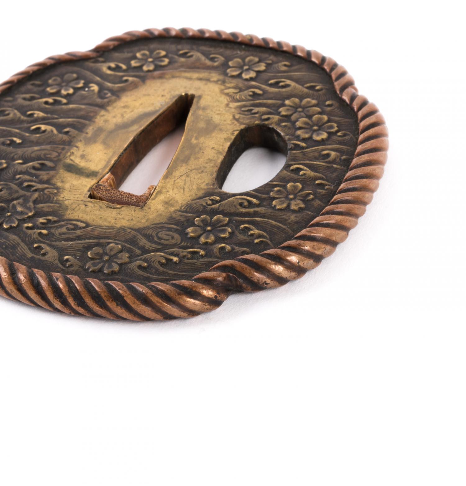

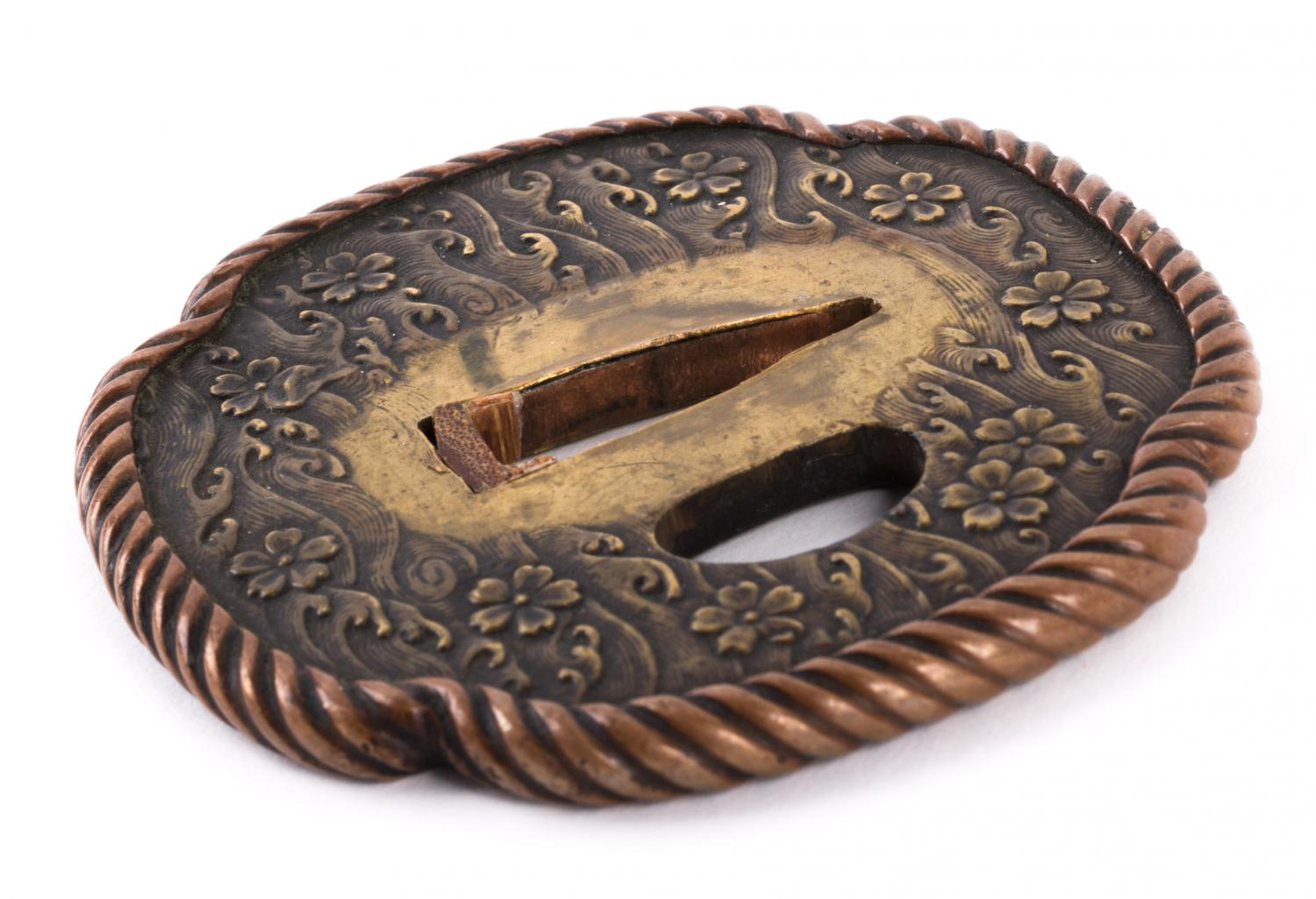

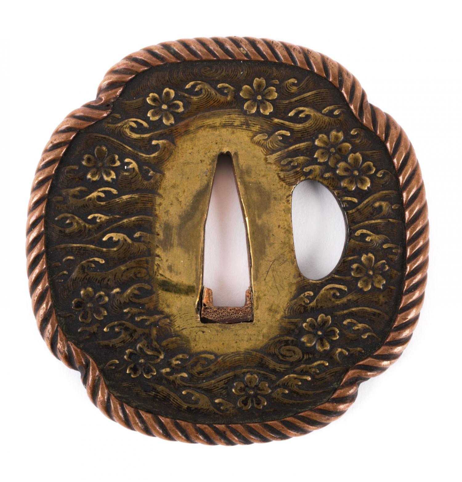

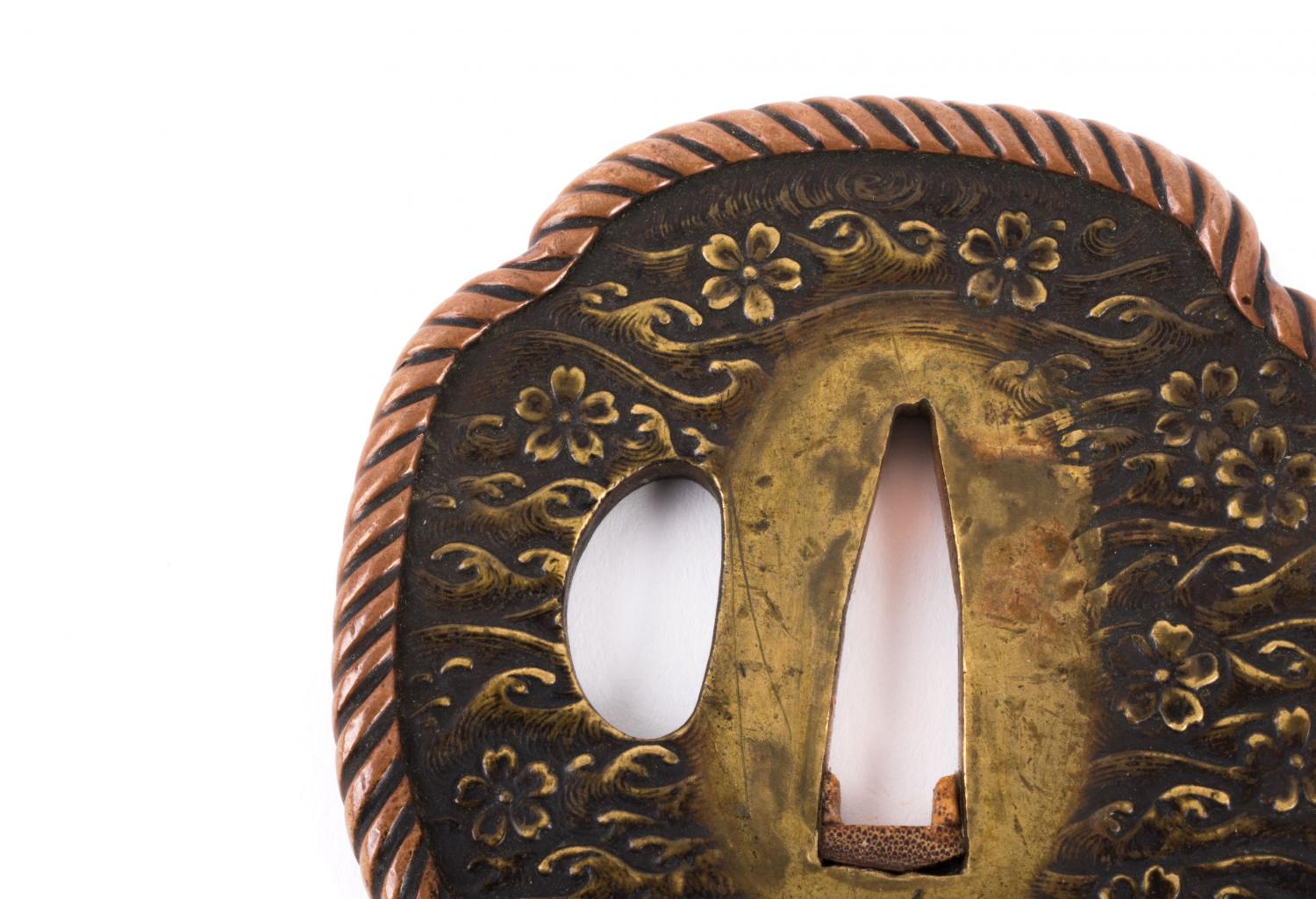

Krystian Posted July 18, 2019 Report Posted July 18, 2019 Hello, I wonder what are your thoughts about this tsuba. Base of this tsuba is made of copper. On both sides thin brass plates where added. In my opinion they carry a lot of artistic value but I don't see any signs of carving. And I learned to be very cautious of kinko pieces ... As always thank you for all your comments. Best Regards, Krystian Quote
Steves87 Posted July 18, 2019 Report Posted July 18, 2019 San mai? Is that a bamboo sekigane? Following thread 3 Quote
Krystian Posted July 18, 2019 Author Report Posted July 18, 2019 Yes, san mai and bamboo sekigane:) 1 Quote
Soshin Posted July 18, 2019 Report Posted July 18, 2019 It is three layer construction (sanmai) and not a reproduction. Many kinko tsuba were made using this method as early as the Momoyama Period. Here is a tsuba made with yamagane sanmai. The core is made of copper. 2 Quote
Krystian Posted July 18, 2019 Author Report Posted July 18, 2019 Thank you David. Do you know what method was used to make decorative outer layer? Quote
Brian Posted July 18, 2019 Report Posted July 18, 2019 Punched from the back..it is a thin layer. 3 Quote
TETSUGENDO Posted July 18, 2019 Report Posted July 18, 2019 Repoussé, rarely with a bit of chasing. -S- Quote
vajo Posted July 18, 2019 Report Posted July 18, 2019 As Brian said these are two layers. The rim hold the layers on the plate. Quote
Surfson Posted July 18, 2019 Report Posted July 18, 2019 How collectible are sanmai construction tsuba? Some of them can be quite old and attractive. Do they have a following and a market? I have run across one recently. 1 Quote
Steves87 Posted July 18, 2019 Report Posted July 18, 2019 Im wondering similar things, I was recently gifted one which seems quite different to most. Quote

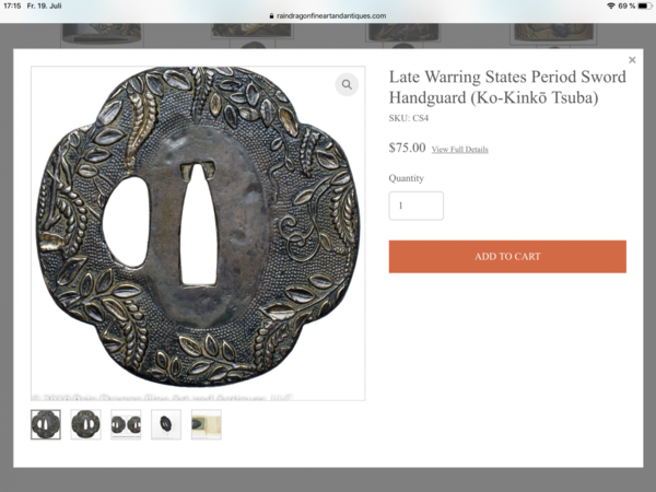

Ford Hallam Posted July 19, 2019 Report Posted July 19, 2019 Might I suggest that commercial interests refrain from posting images and links to items they're currently, or have previously, offered for sale? I find that commercial interests invariably muddy the waters of pure academic research and study. 6 Quote

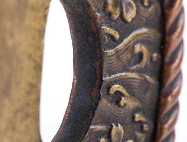

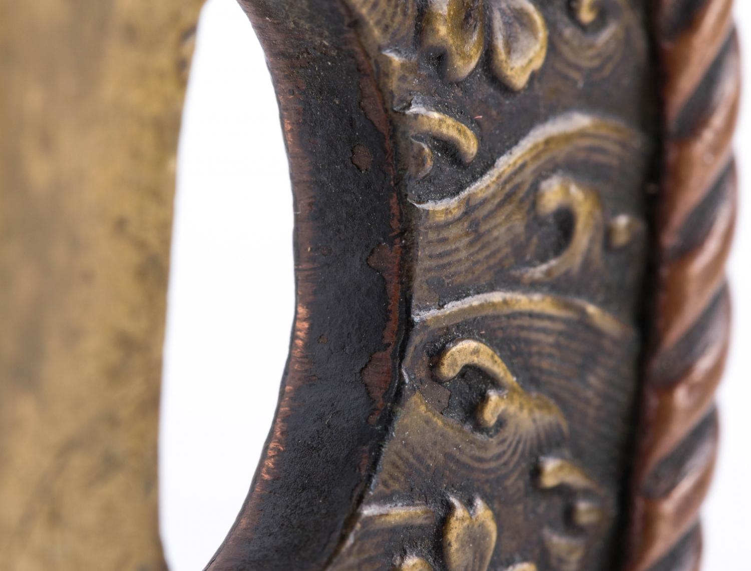

Krystian Posted July 19, 2019 Author Report Posted July 19, 2019 Again thank you for the comments. Just one more thing. Do you know how plates where connected to each other? There is black lacquer inside kozuka ana. So I wonder If it was used to cover sanmai structure or to make the connection stronger. In nakago ana on ura side there is a space between copper base and brass plate. Inside I see nothing that connects those two together. So just heat? Robert and Stephen. I bought It for around 350 $ and would do it again. 1 Quote

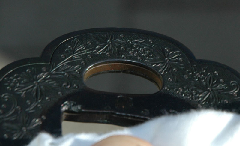

Steves87 Posted July 19, 2019 Report Posted July 19, 2019 Krystian, I can give simple answers to those questions, but I think there are infinitely more experienced people who will be better answering for you. Instead, Id like to share with you the Tsuba I was gifted for some simple CAD work. 1 Quote
Krystian Posted July 19, 2019 Author Report Posted July 19, 2019 Dear Ford. I am sorry but I do not exactly understand? I have not offered this tsuba for sale and I am open to all comments. I understand that sometimes when financial matters are involved the party and hand might be skeptical about criticism of an item. However as we just saw in a different post criticism will still occur and we will all learn either way. And learning is what this forum is all about? Quote
ROKUJURO Posted July 19, 2019 Report Posted July 19, 2019 Steve,although your TSUBA seems to show a three layer construction, I don't think it is a SAN-MAI TSUBA, as these were constructed this way for decorative reasons which is not the case here. AKASAKA iron TSUBA also show the same principle. Your TSUBA could have suffered from having been in a fire which caused the outer plate to come off a tiny bit.But this is just my impression from the photo and has to be verified by an expert (which I am not) in hand. 2 Quote
Guido Posted July 19, 2019 Report Posted July 19, 2019 Krystian, Ford probably referred to this tsuba: 1 Quote
Krystian Posted July 19, 2019 Author Report Posted July 19, 2019 Steve, the reason why plate came off a bit on nakago ana is most probably result of widening it with a file. There are clear signs of file use made not long ago. 1 Quote

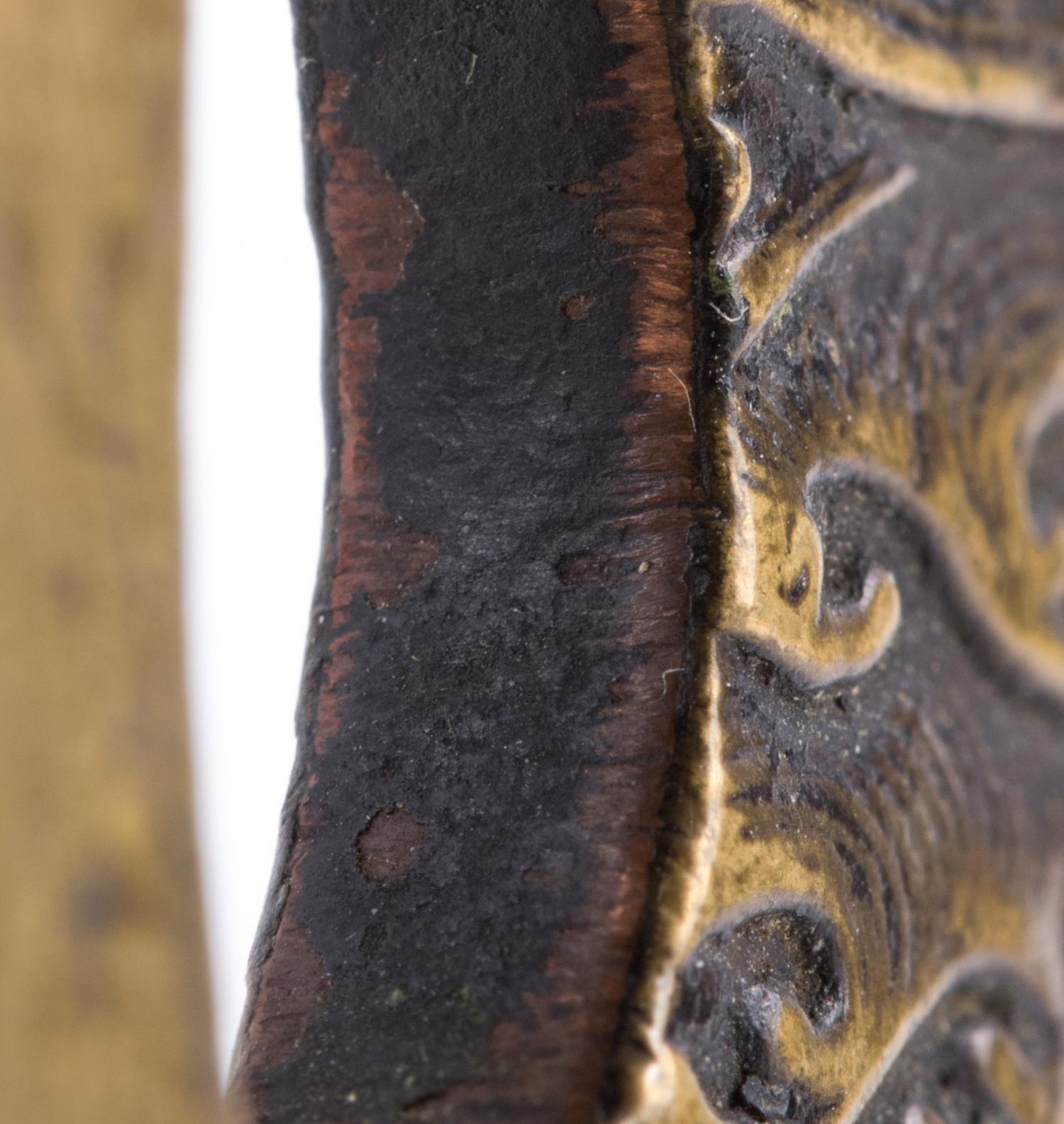

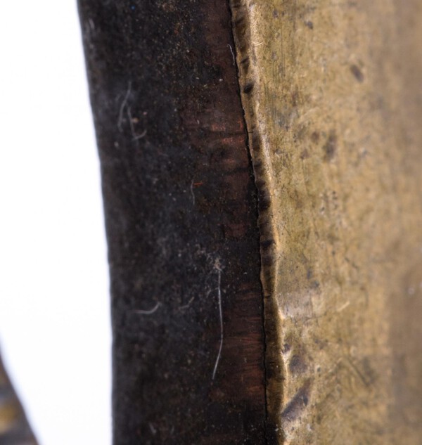

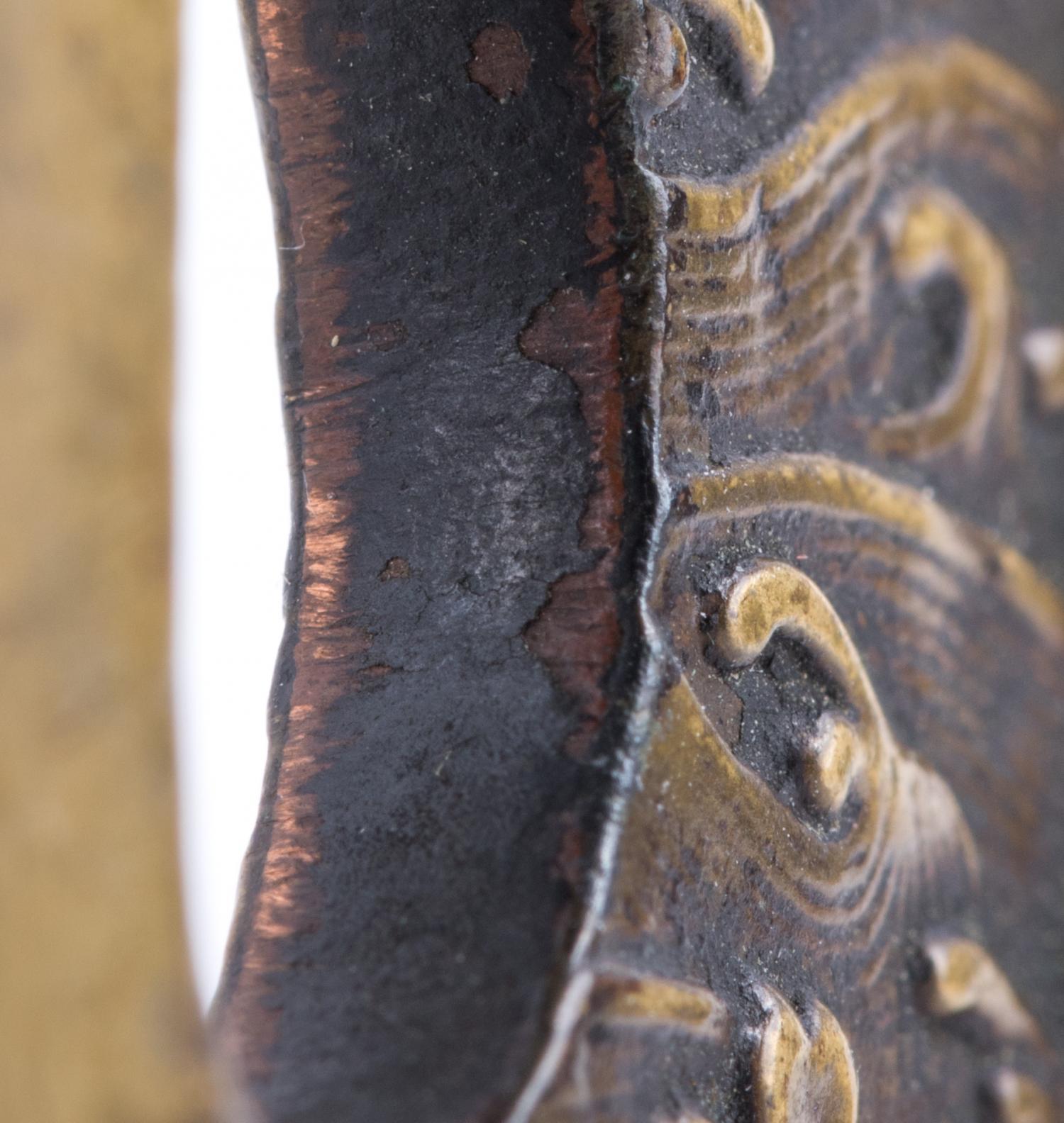

Krystian Posted July 19, 2019 Author Report Posted July 19, 2019 And some close ups of inside kozuka and nakago ana. 2 Quote
Soshin Posted July 19, 2019 Report Posted July 19, 2019 All of your comments are of a commercial nature becuase you make tsuba and which are not free or cheap! Talk about a double standard! Might I suggest that commercial interests refrain from posting images and links to items they're currently, or have previously, offered for sale? I find that commercial interests invariably muddy the waters of pure academic research and study. Quote
Brian Posted July 19, 2019 Report Posted July 19, 2019 Enough of this. I am deleting any further posts, unless Ford would like to explain why "that" tsuba description was relevant and misleading. 1 Quote
Surfson Posted July 19, 2019 Report Posted July 19, 2019 Fantastic photos Krystian. That really makes the case better than thousands of words. It seems in some areas that the plate is well fused to the inner core and others are delaminating. 2 Quote
