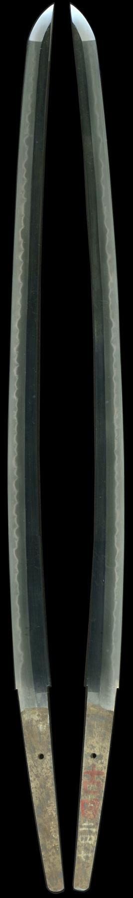

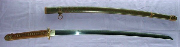

This sword is in gunto koshirae type 98, has a nagasa of 67 cm, the smith should be Yoshimitsu and, despite advertised as Taisho blade, the seller defines it as semi-traditional gunto. Due the presence of the "torokusho" license I understand this souldn't be a mass produced, only machine-made blade, am I wrong?

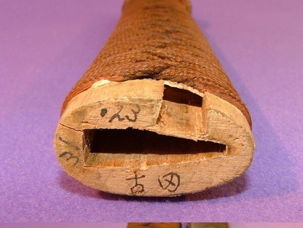

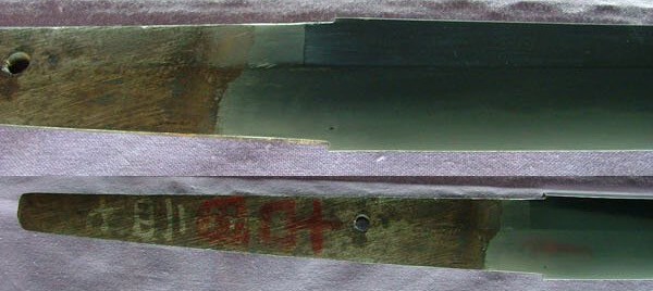

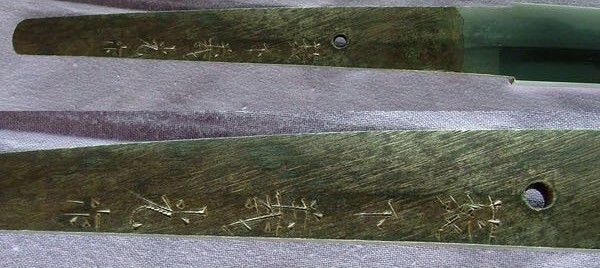

Unfortunately I'm not able to read Japanese kanji's, so would someone of you experts be so kind to translate the nakago's writings? Those painted in red are also present on the tsuka.

Dōmo arigatō gentlemen; any chance to have the nagako translated? Is there any stamping showing the date she has been made?
Yabushita Yoshimitsu 義光 (Yoshimitsu) 藪下 (Yabushita)
A Seki Kaji Tosho.
civilian name = Yabushita Fujio (藪下不二夫)
