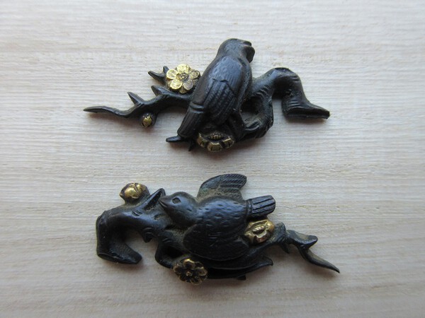

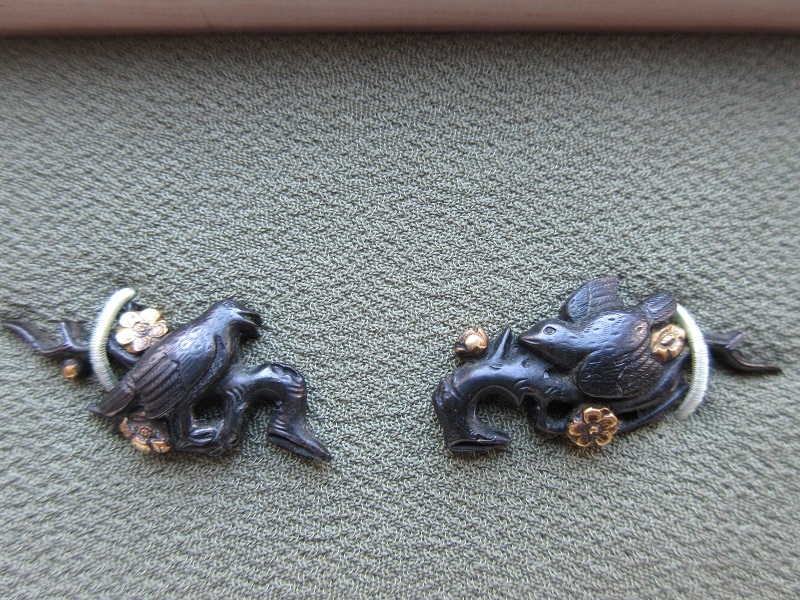

Robin Posted July 3, 2019 Report Posted July 3, 2019 Hello all, Maybe a nice tip for cleaning tosogu: Blu Tack. For those who don't know what Blu Tack is... https://en.wikipedia.org/wiki/Blu_Tack It's sticky rubbery stuff. I use it for decades for many purposes...and recently also for cleaning tosogu. A small piece...knead it for a short moment to make it softer and more sticky and off you go. Rub a surface with it and it will pick up dirt and grime. One thing...since it's very sticky....stay away from any kind of inlay. Before... 3 minutes later... Disclaimer: use at own risk. 2 Quote

Stefan Posted July 3, 2019 Report Posted July 3, 2019 Your are joking. Before intact patina, after a ruined surface. I would prefer a litle dirt in the corners. Stefan 3 Quote
vajo Posted July 3, 2019 Report Posted July 3, 2019 I'm with Stefan in this case. The menuki was looking very good with "the dirt". Now it looks clean and new. But thats in the decission of the collector. Quote

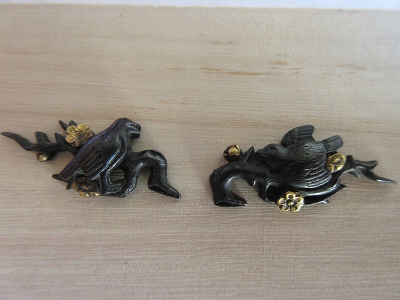

Robin Posted July 3, 2019 Author Report Posted July 3, 2019 I think that's the direct sunlight playing tricks. Nothing happened to the patina. Still black, just clean. A new photo... 2 Quote

Robin Posted July 4, 2019 Author Report Posted July 4, 2019 On 7/4/2019 at 6:13 AM, Brian said: Personally I think nothing wrong with cleaning menuki. They are not the inside of the sukashi in a tsuba or a nakago. We don't use the dirt to date them. This method is non destructive and no worse than washing with water. I assume this is the stuff we call Prestik here. Thank you. I think the first photo was unlucky, because of the sunlight...and even the second photo...the light reflection might suggest wear, but believe me...it's just light reflecting. I tried to take a photo without reflection, but that didn't work....where there is light there is reflection and I can't take a photo without light. I didn't clean the inside. Imho dirt is not part of a menuki (or any tosogu)...it's just dirt obscuring details. This is in fact a very gentle way to clean...it's mechanical, not chemical. Nothing aggressive about it. Flexible kneadable sticky rubbery stuff that can go in otherwise difficult to reach corners....it picks up dirt...nothing more, nothing less. When the result is a clean surface, what's wrong with that? When it looks like new without dirt, the condition of the item is apperently very good. Is that a bad thing? 1 Quote
