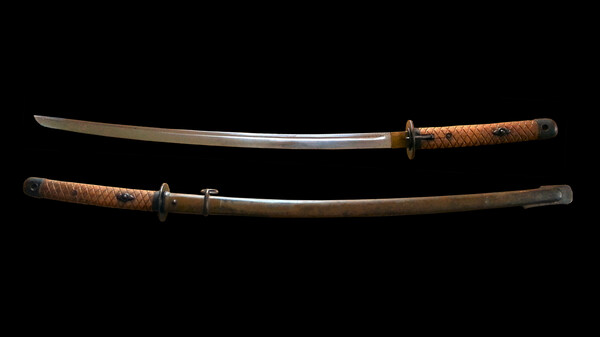

My version 3:

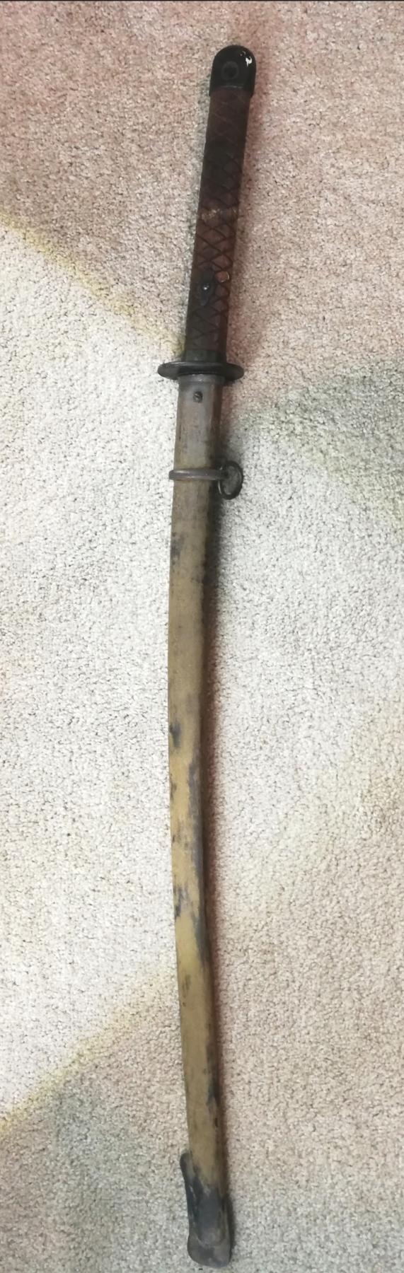

My late war, painted gold, but similar black drag:

Oh, remember that a number of swords were painted gold to celebrate... think it was the emperors birthday... I can't remember details, but pretty sure Nick gave us some info about that.
Also, as is most obvious with copper handle, there were undercoatings and repainting of swords. I believe that all period black saya are repaints of original green/brown saya.

Now I REALLY regret stripping my version 3!!! Crap! Looks like it's wartime paint, just don't know who might have done it. It's just so freaking ugly that it's hard to believe a professional did it, yet they are so identical, now all 3, that I can't see it as random soldier DIY jobs.
As I recall, on the gold, there was gold colored saya glinting in the sun at the emperor's coronation, but that was in 1926, well before the Type 95 was invented. I don't recall a birthday celebration discussed.
