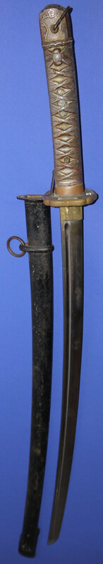

Patina on the hilt is so far off from the saya, definitely a repaint of black, much later than the hilt. Strongly expect there would be the standard paint remaining somewhere on the saya if carefully examined. I wonder if the allies repainted captured equipment to prevent decay until they decided what to do with it. Not a bad theory and as solid as anything else.
Here's a Nagoya sword from a UK dealers site found (current listing so won't post the link)
The black scabbard appears to be  a period paint job, showing nice Patina and old wear from usage IMO.
Closer inspection would help reveal if it is original or a 'period' repaint.

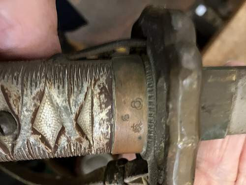

Hello,
         Just picked this one up locally…..Nice dark patina to the Saya which I believe to be period….Sword had those specks of early oil based paint splashed on it when it had been mounted on a living room wall, blade was covered with a really nasty sticky grease….Sword has all the pointers of being well used i.e razor sharp with sharpening marks and plenty nicks and scars towards the kissaki and interesting repair to kuchi-gane..
Regards,
Paul..
