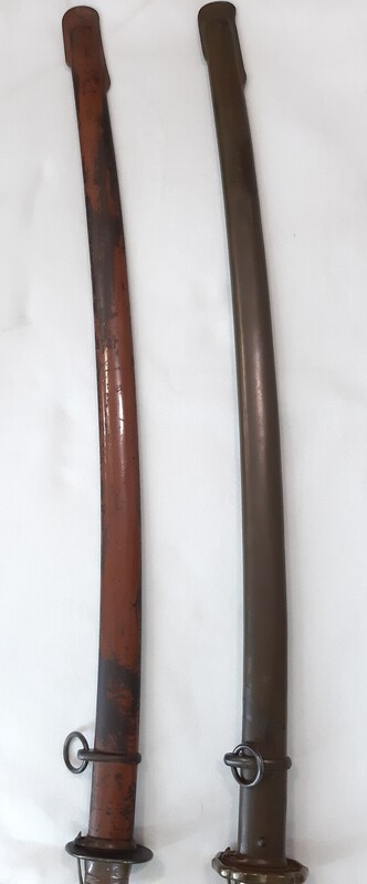

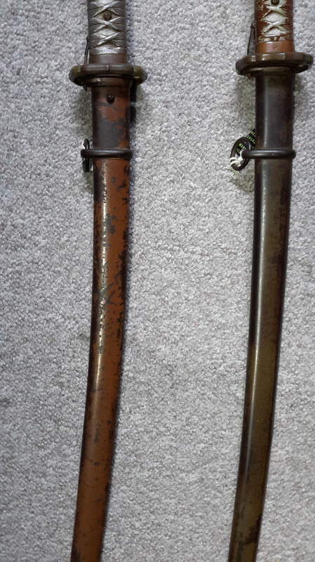

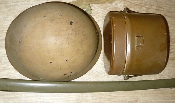

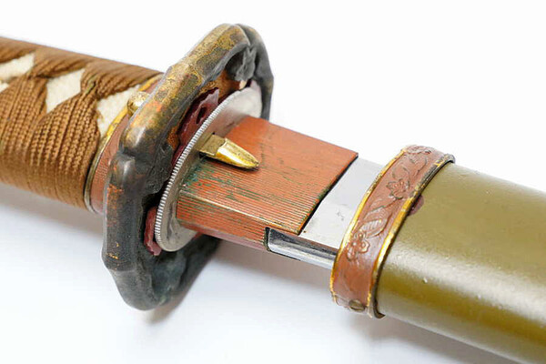

Shamsy Posted March 21, 2021 Author Report Posted March 21, 2021 If anyone is wondering what Red Bean Colour may look like on a Type 95 saya... 4 2 Quote

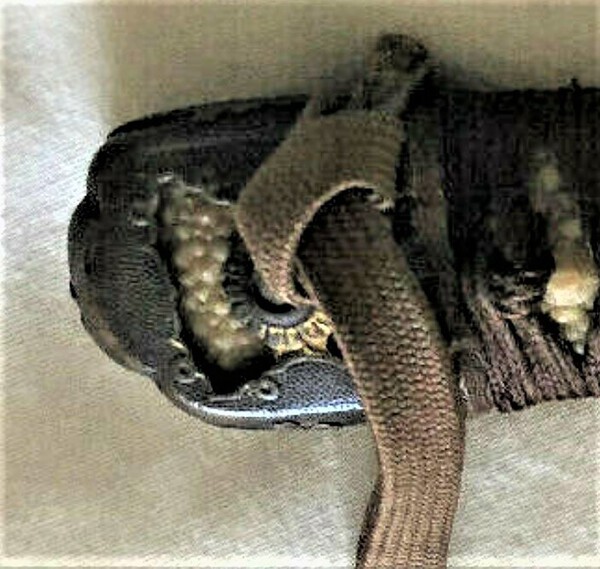

tokashikibob Posted April 17, 2021 Report Posted April 17, 2021 Hello, Picked up some swords the other day here around Camp Lejeune. These were attic pieces. I want to thank Bruce P. the Daimyo of WW2 blades for taking a look at there and recommending a post on them. "Hand Salute" to Bruce. Anyway, these from Bruce's tips and hints this looks to be a black handle NCO. I do not see any other paint under the wear of the black on handle or scabbard. Best regards, Bob 1 Quote

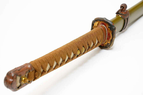

robinalexander Posted April 27, 2021 Report Posted April 27, 2021 Another example of Red Bean Colour with a std (worn) olive drab. Thanks Shamsy, I always thought I had a bodgey job. Rob 2 Quote

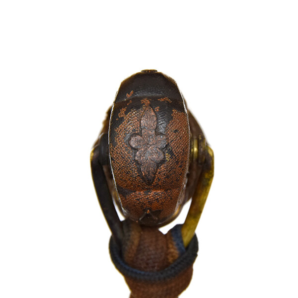

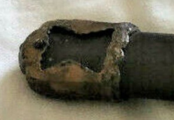

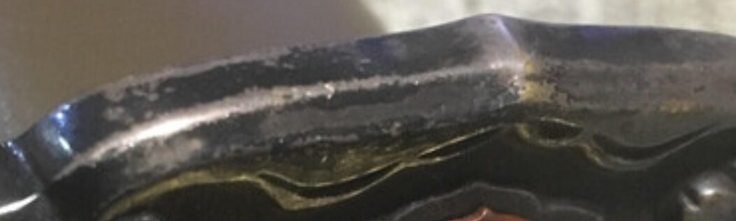

Bruce Pennington Posted May 3, 2021 Report Posted May 3, 2021 I apologize, guys, for hijacking this great thread with officer stuff. But it's the only one going, so hopefully we can work them both here. This one on a '43 Mantetsu Koa Isshin: Bad focus on the kabutogane, but it looks like it was painted black, too, but mostly worn off by now. Quote
Shamsy Posted May 5, 2021 Author Report Posted May 5, 2021 Looks like patina to me, Bruce. Hard to tell though. Quote

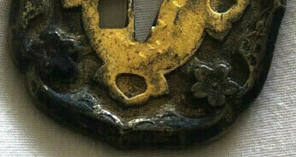

Bruce Pennington Posted May 5, 2021 Report Posted May 5, 2021 Maybe caused by something it was exposed to? I just thought it was painted because of the straight line through one of the sakuras and how it follows the edge of the perimeter so perfectly (except for the sakura): Quote

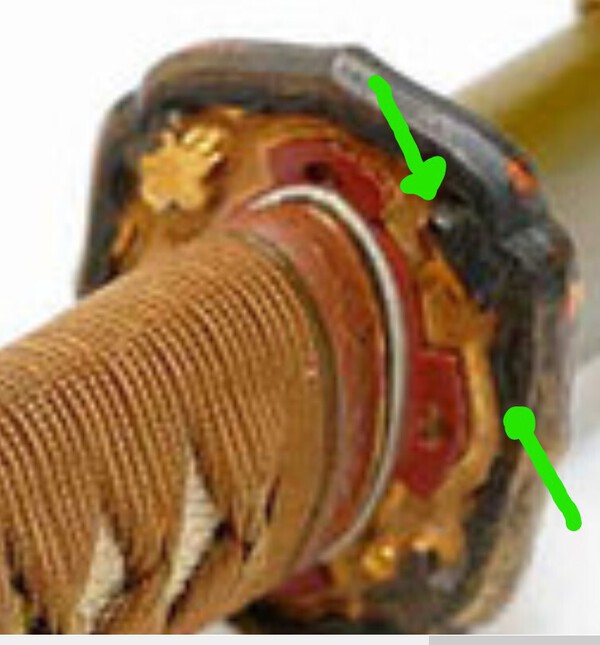

IJASWORDS Posted May 7, 2021 Report Posted May 7, 2021 Bruce, looks like a '98 with blackened fittings that shows sign of age. 2 1 Quote
PNSSHOGUN Posted May 7, 2021 Report Posted May 7, 2021 To me it just looks like regular patina on brass. 2 Quote
Bruce Pennington Posted May 7, 2021 Report Posted May 7, 2021 4 hours ago, PNSSHOGUN said: patina on brass 5 hours ago, IJASWORDS said: sign of age. I would have to first ask a metals guy - does brass blacken with age? If so, why aren't all WWII brass fittings, in our time now, black? Then, if patina, how could it have patinated so fast that the fittings then were dinged and scratched, bumped and scraped, back then to wear through that patina? Doesn't seem likely. Quote

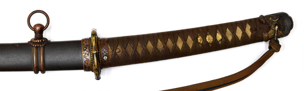

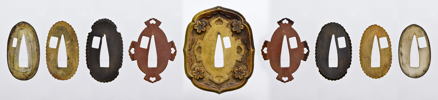

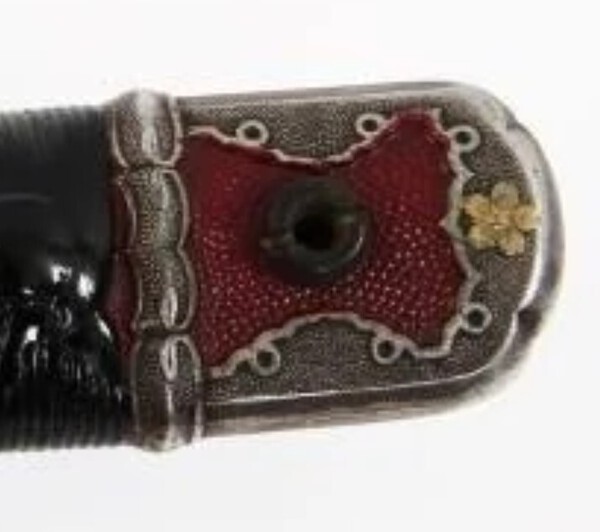

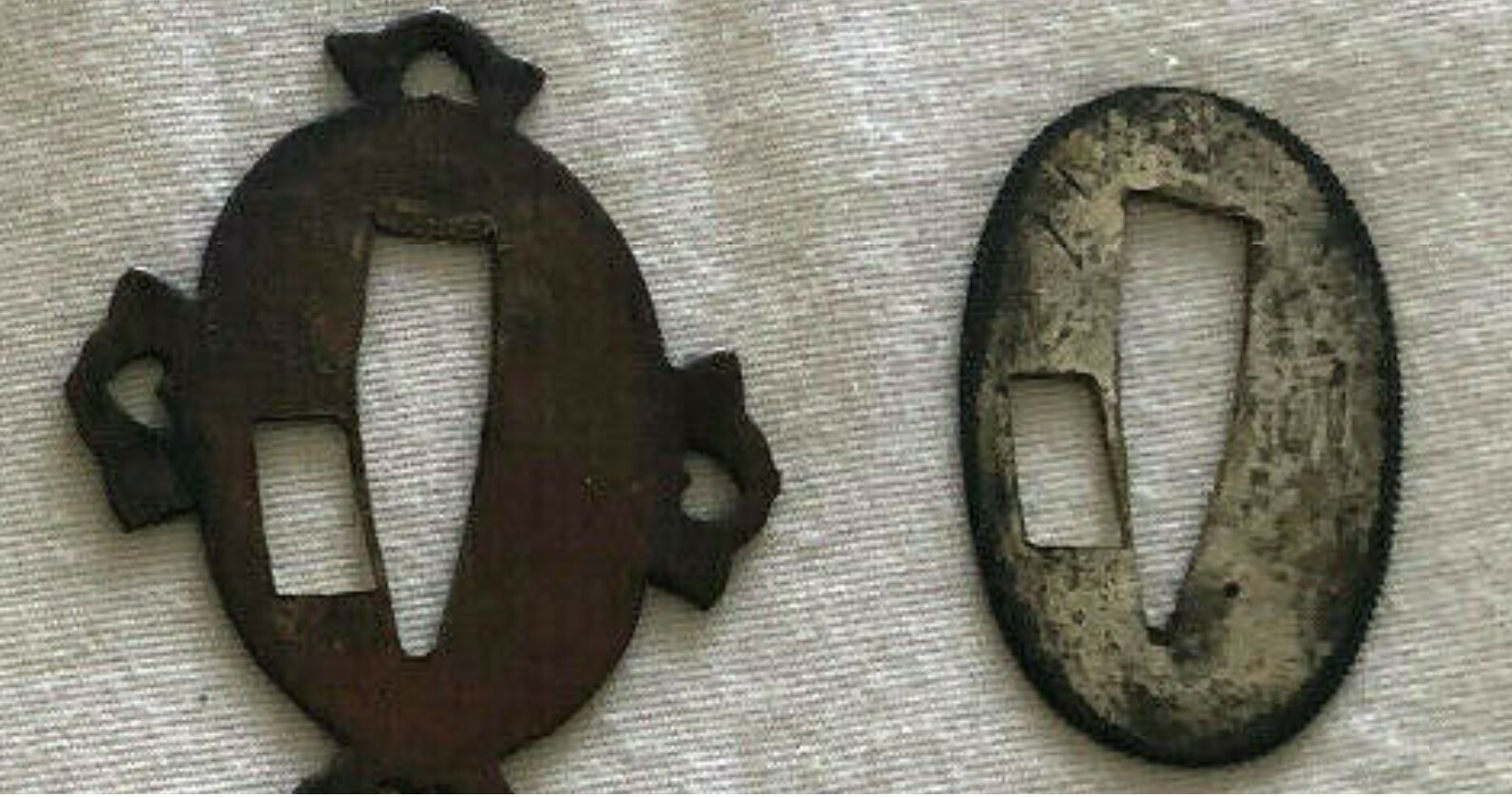

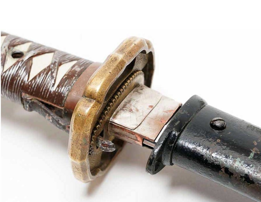

Bruce Pennington Posted May 7, 2021 Report Posted May 7, 2021 So, I just came across this one on fleabay. It might be an example of patination. the metal parts seem to have been exposed to something that blackened the surface. You can see even the "silver" seppa got blackened around the exposed edges. The kabutogane and sayajiri are affected as well. Puzzling to me is the menugi seems unaffected (and habaki, but that could be explained by the fact it was inside the saya and protected). Enlarged, you can see the "staining" isn't uniform like a paint-job would be: So maybe @IJASWORDS has an explanation as to what would do this to brass. But his example I still believe is paint. You can see the layer of paint that was worn off: Quote

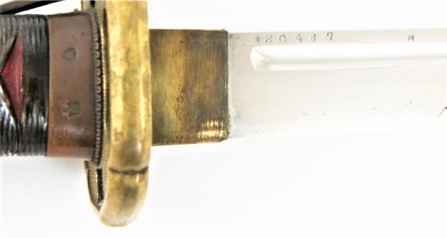

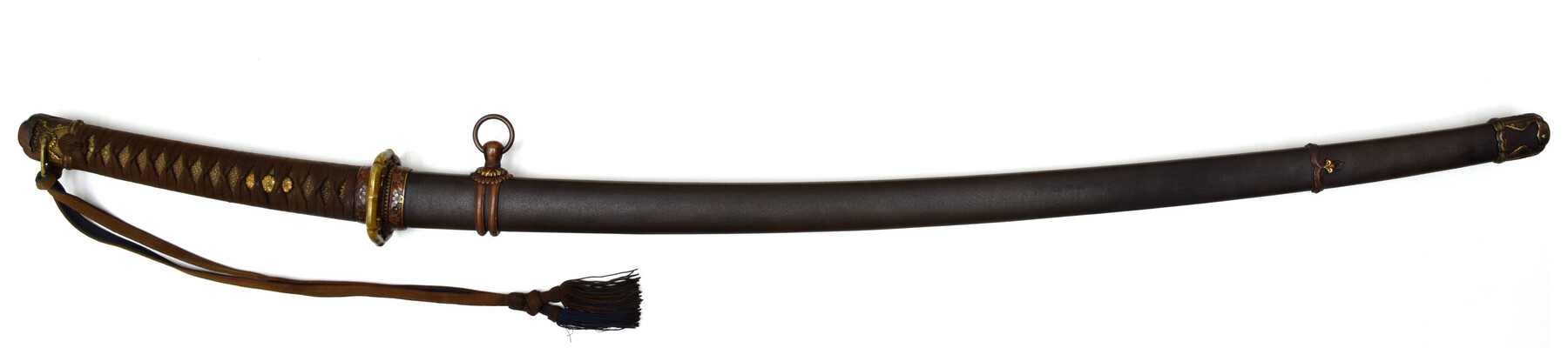

ribendao Posted May 7, 2021 Report Posted May 7, 2021 Came across this early type 95 for sale. Not sure if this is a "bubba job" or something done earlier. 1 Quote
Bruce Pennington Posted May 7, 2021 Report Posted May 7, 2021 That stuff just makes my brain fizzle. The immediate reaction is "BUBBA!!!" But then look at the kabutogane. It looks old and worn. Could it be a Bubba re-paint over an original black? The red and white are Bubba in my opinion though. Yet we've see other discussion about red on yari and other blades that appear original. Quote
Dave R Posted May 7, 2021 Report Posted May 7, 2021 3 hours ago, Bruce Pennington said: I would have to first ask a metals guy - does brass blacken with age? If so, why aren't all WWII brass fittings, in our time now, black? Then, if patina, how could it have patinated so fast that the fittings then were dinged and scratched, bumped and scraped, back then to wear through that patina? Doesn't seem likely. Brass blackens with certain conditions, one of them being sulphur in the air, this would affect worn areas of a tsuba but not the parts still gilded. This is why the menuki would resist patination, they are usually gilded as well. 4 2 Quote

ribendao Posted May 13, 2021 Report Posted May 13, 2021 Just found another type 95 with a black saya on ebay. The blade is without fuller which I find very strange. https://www.ebay.com/itm/234006705243?hash=item367be2f45b:g:maIAAOSwNutgjuDj Quote

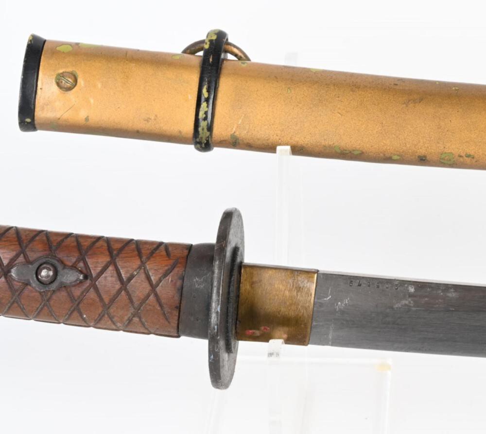

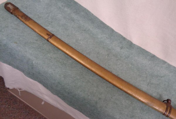

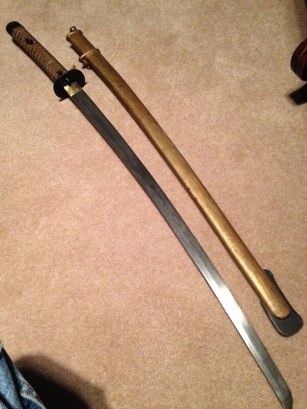

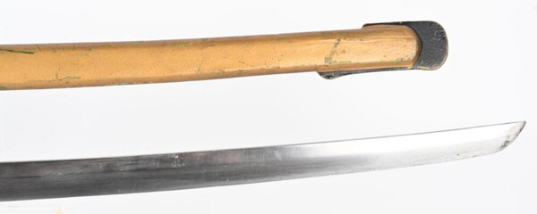

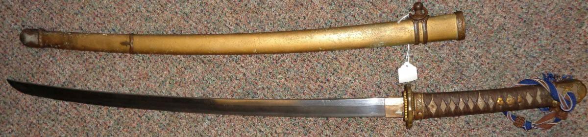

Bruce Pennington Posted June 29, 2021 Report Posted June 29, 2021 Someday I'll start a seperate "Gold Painted Gunto" thread, but for now, this one is acting as a general place to discuss colors and their originality. So I came across another gold-painted saya on a Type 98 on This Wehrmacht-Awards Thread. I've asked for some close-ups to investigate it further: Quote
Bruce Pennington Posted July 1, 2021 Report Posted July 1, 2021 Here are more pics from the owner. Seems to have wear and age appropriate to WWII paint work! Hmmmm...... Quote

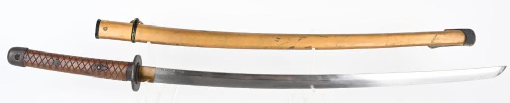

Kolekt-To Posted July 1, 2021 Report Posted July 1, 2021 Here's another example of a gold-painted saya. A 3rd version Type 95 up for auction on 7.17.21 on the invaluable site. https://www.invaluable.com/auction-lot/Japanese-nco-shin-gunto-1945-katana-sword-b7842eda09 1 Quote

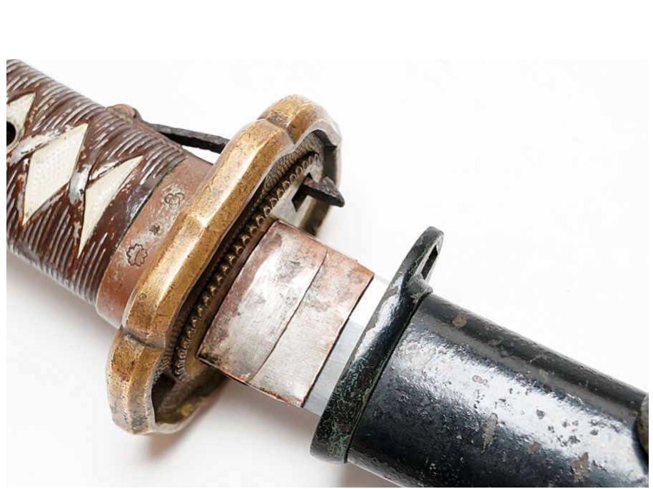

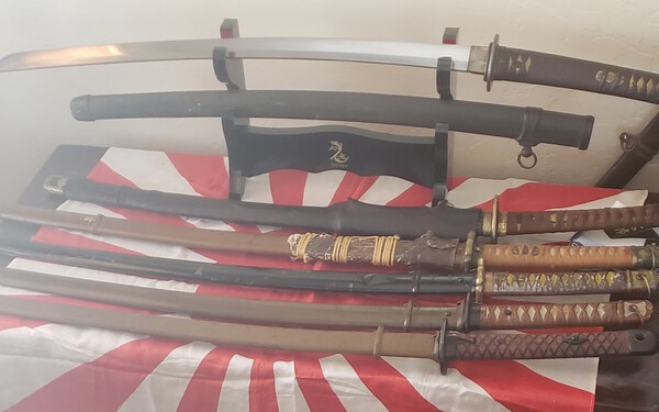

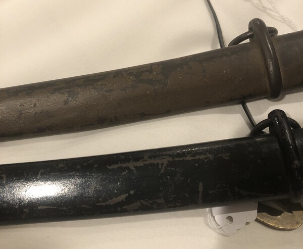

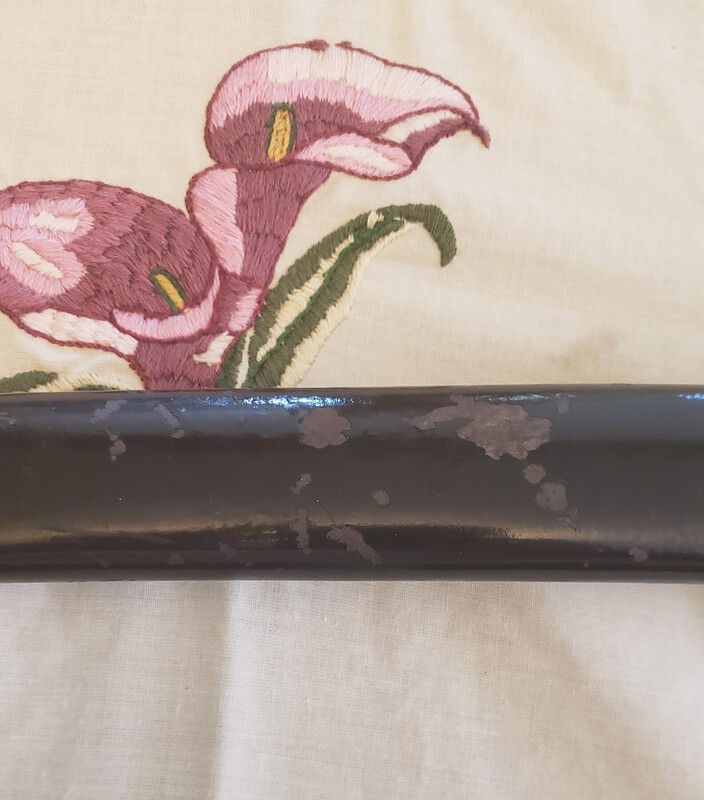

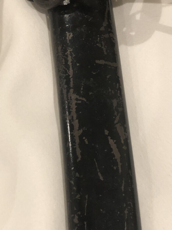

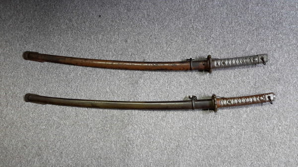

Kolekt-To Posted July 1, 2021 Report Posted July 1, 2021 Here are some photos of my Type 95 with the black saya. In the first photo it is seen in a display with some of my collection where it contrasts well with the sayas of the other guntos. In the last photo the underlying (brown?) paint is visible where the semi-gloss black paint has worn off. 1 Quote

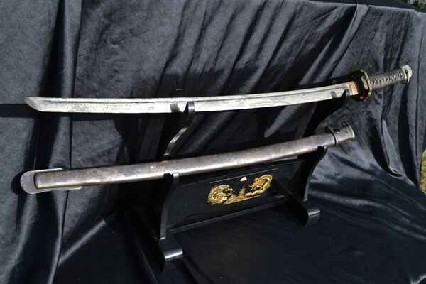

Bruce Pennington Posted July 2, 2021 Report Posted July 2, 2021 7 hours ago, Kolekt-To said: gold-painted saya. A 3rd version Type 95 Thanks Geoff, looks eerily similar to my late 95 before I stripped it. I really regret doing that. Here are some pics. The auction ones will expire in the future: Compare to mine: 1 Quote
