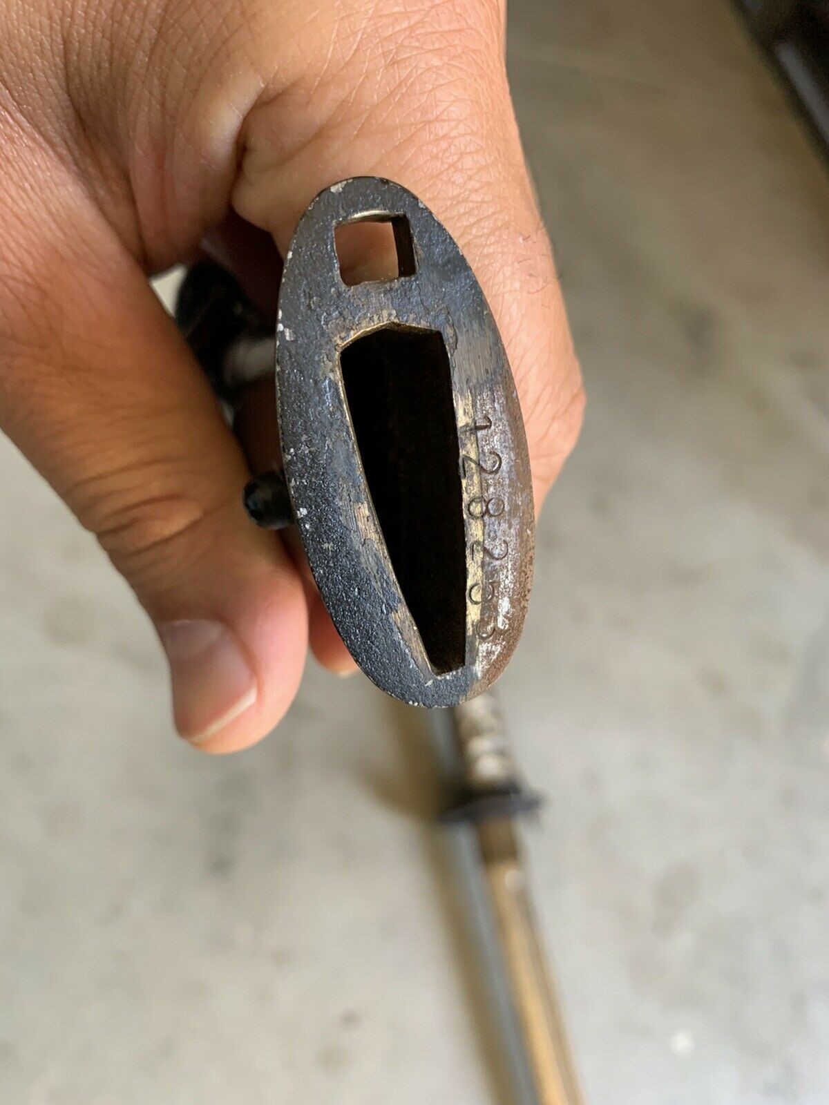

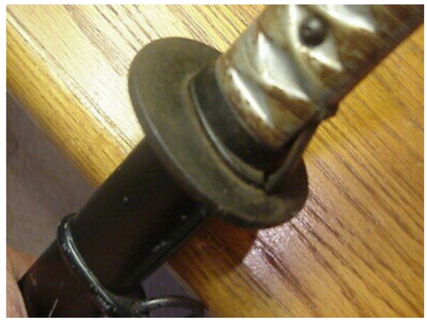

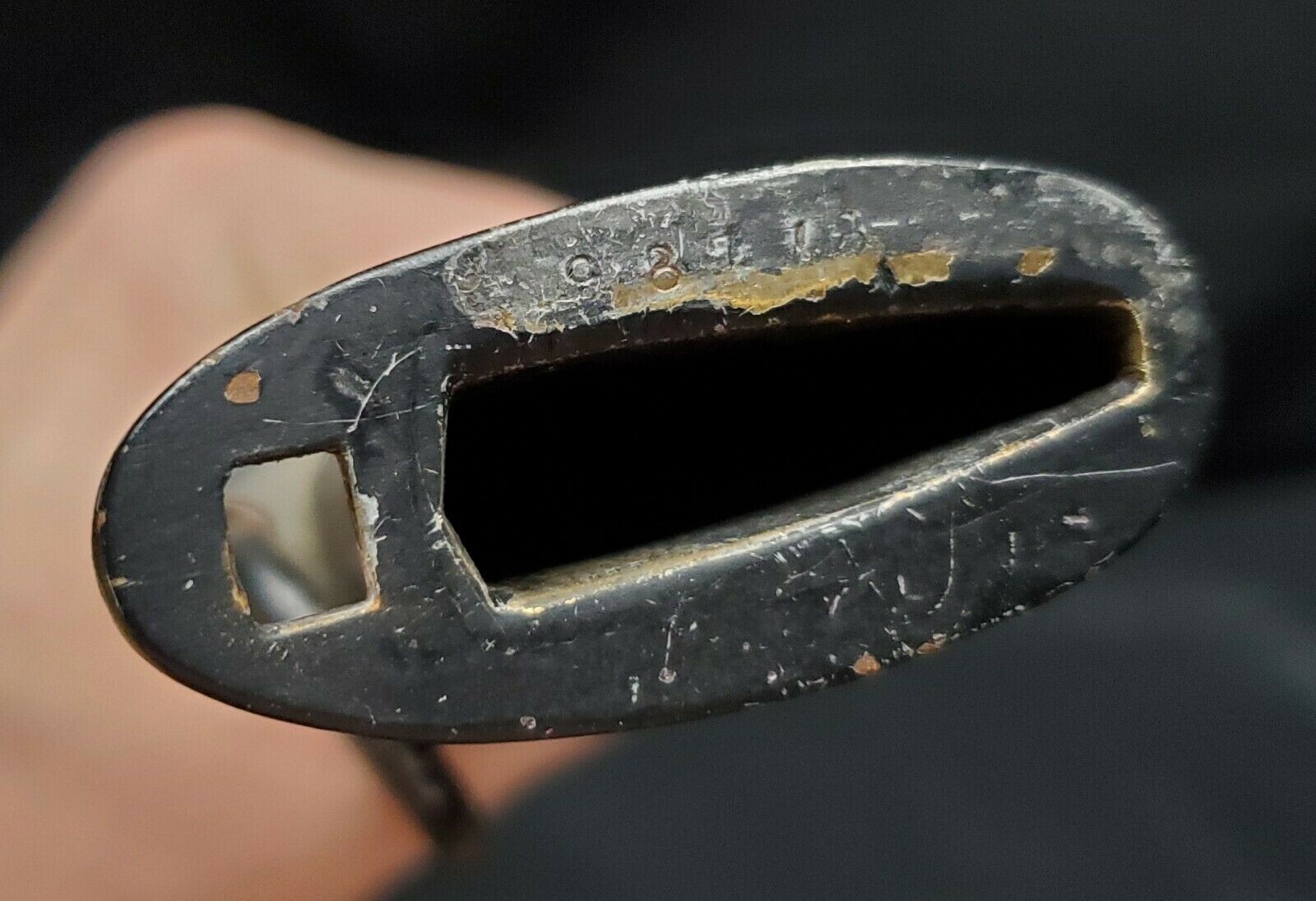

Here is another 95 with period, but not original, black paint on the saya. This one had faint traces of green/brown around the saya throat (externally).

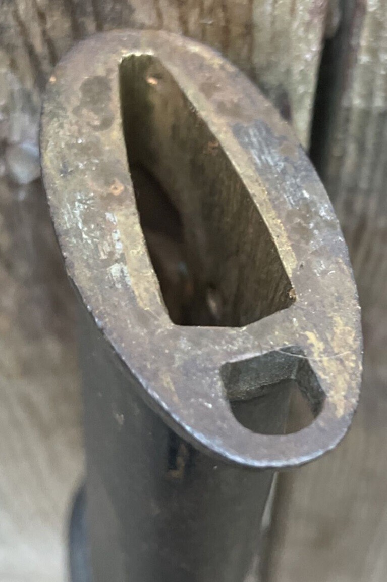

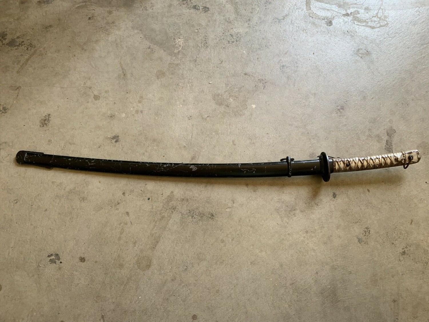

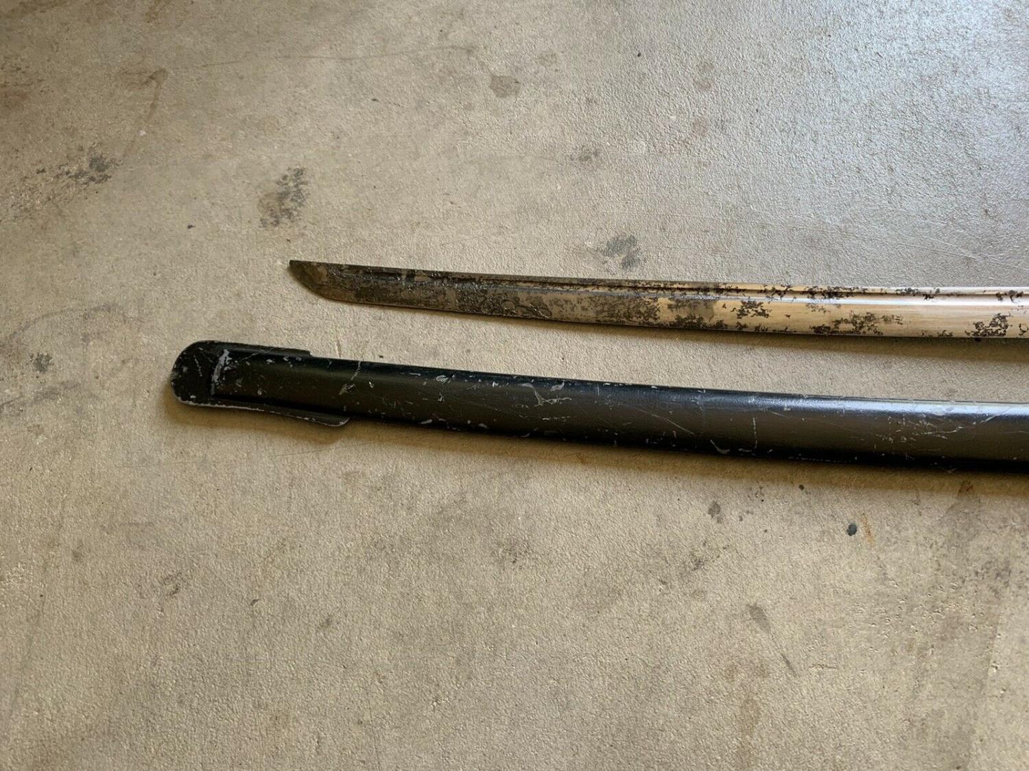

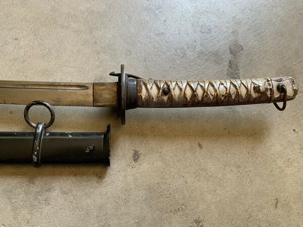

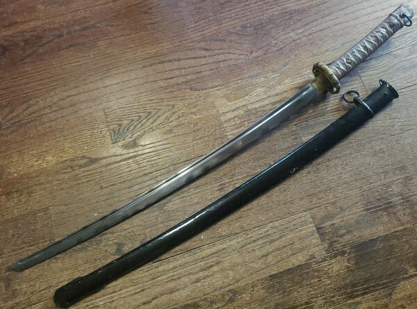

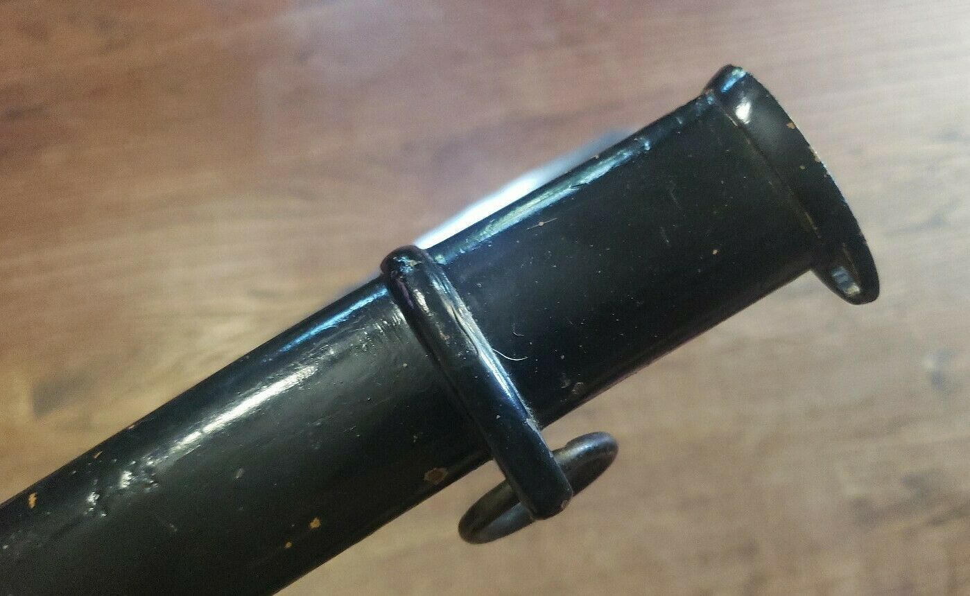

Another example just popped up on eBay. 95 with period, but not original, black saya. Note the telltale spots of original paint on the throat in two pictures. You can also clearly see that the paint is not even, as all genuine, period examples I have seen have been crude refurbishment without much care for removing the original paint.
 Something that may or may not be relevant, black paint dried faster, which was why early Fords only came in black. If you were doing a quick repaint in the field for scabbards that had been banged about enough to need one, black would have advantages over other colours.
Thanks for the insight, Dave. It's really only conjecture on my part based on experience and a number of samples I've seen and continue to see and will add here. Post war repairs to black tend to be clean, smooth and lack patina. The examples I can find with genuine patina all seem to be crudely repainted, without properly being stripped and with paint that seems to be semi gloss and usually pretty rough. I'd say either poor preparation of the saya or perhaps poor quality paint.

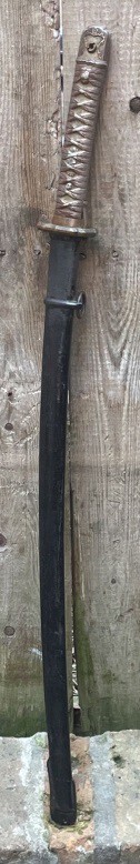

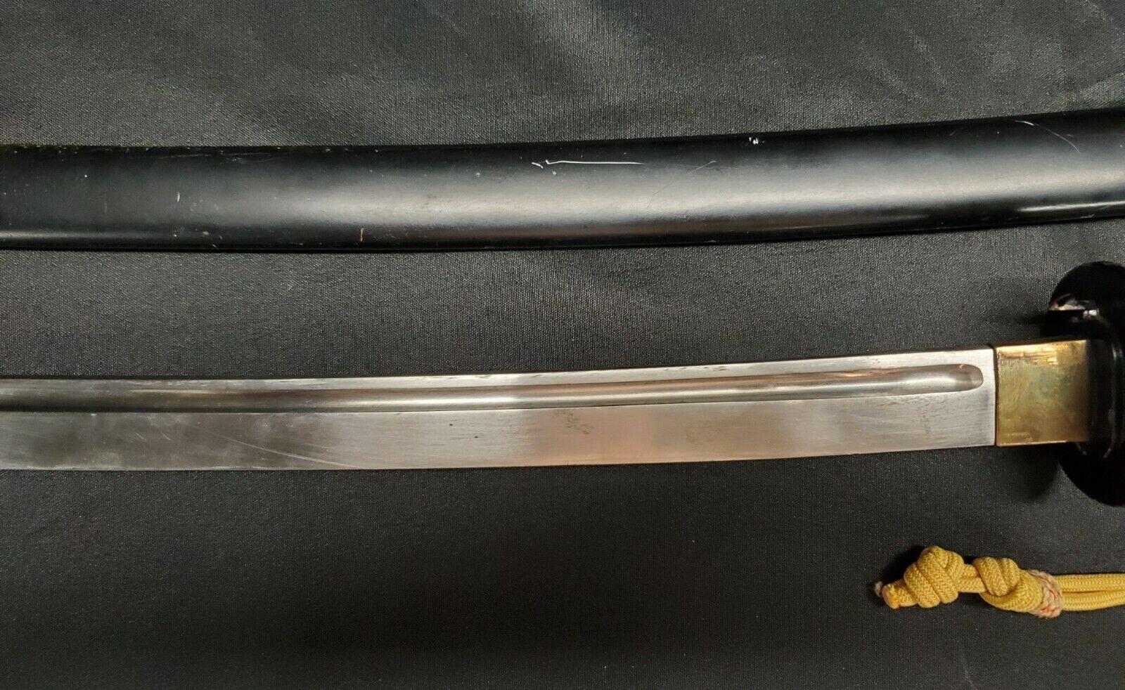

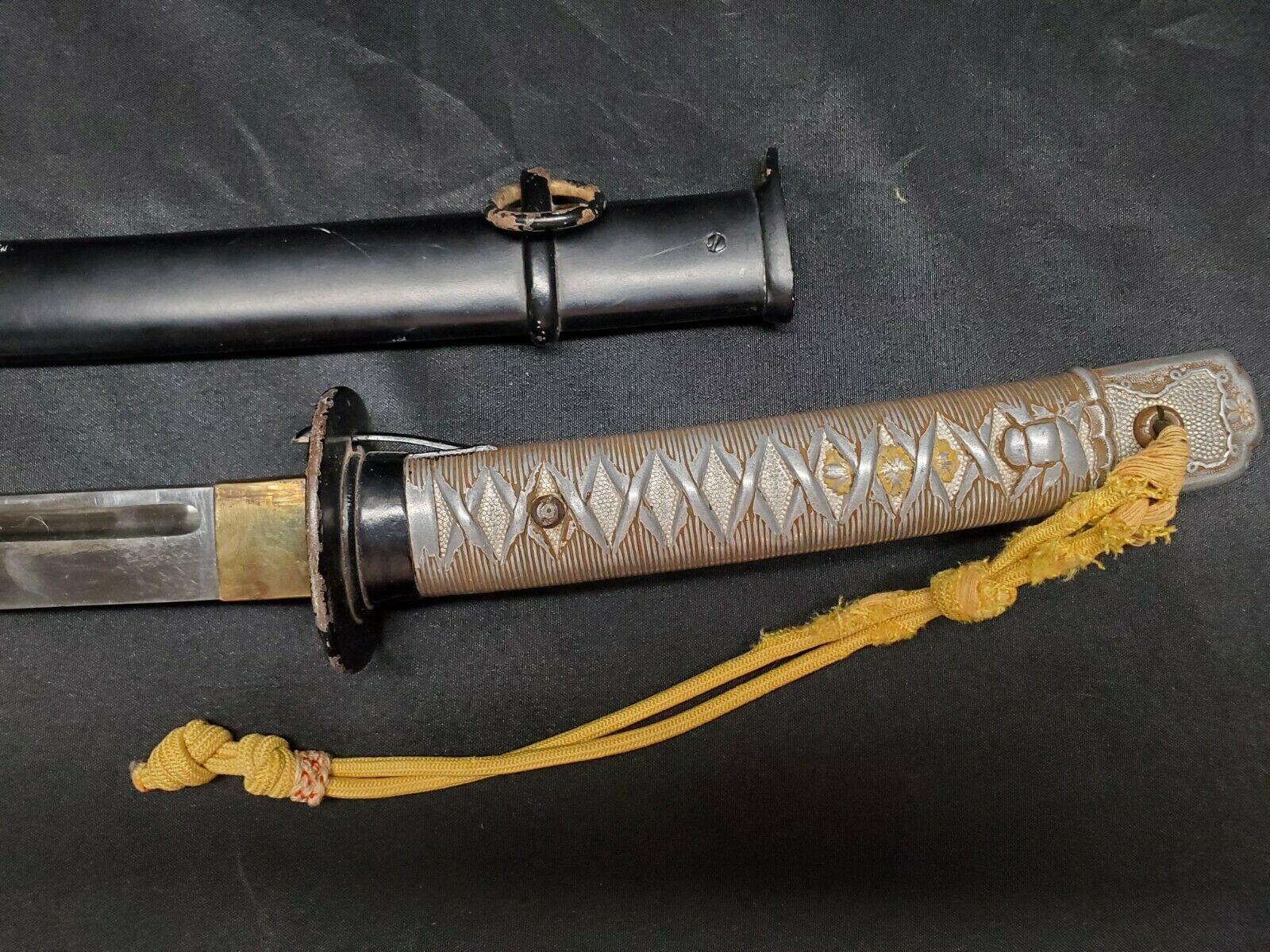

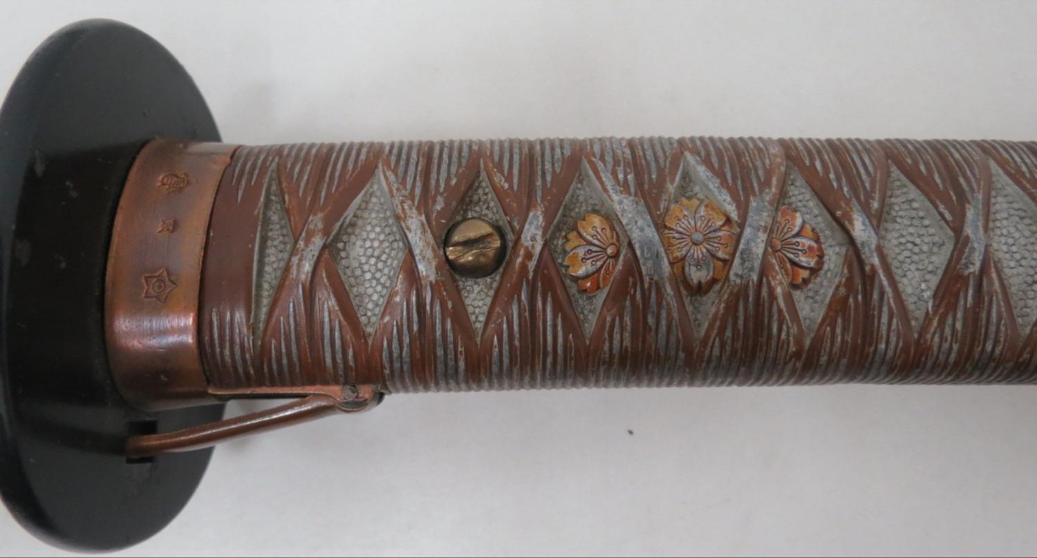

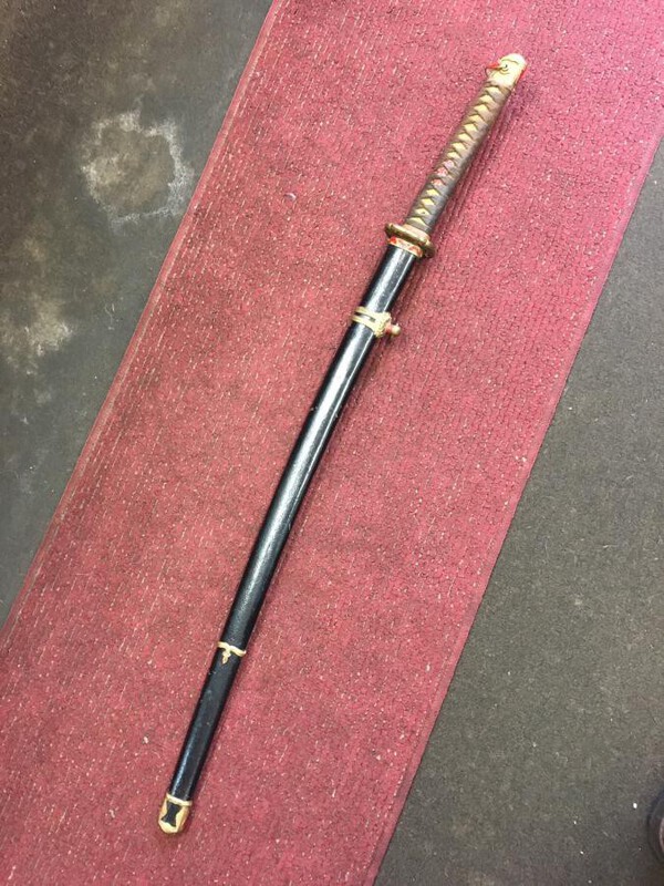

The black NCO version I have, just some pictures to show you all, I have no evidence the black is applied post war, nor if it is applied during production.
Indeed, book references state that black is rare as shown in the picture.
Best regards
Erwin
Would need a few photos, better quality and not on a black background. You'd also have to take out the throat of the saya and see photograph the copper tab that the screw goes through. Patina is also a good tell, though there are some near mint examples, so not as accurate. I'll not speculate since you own the sword, but I have a hypothesis of what you'll find.

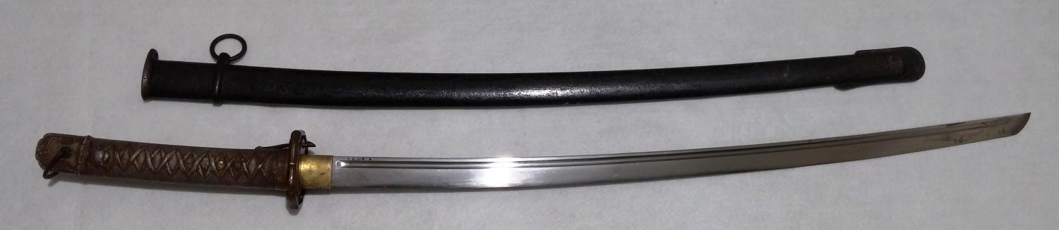

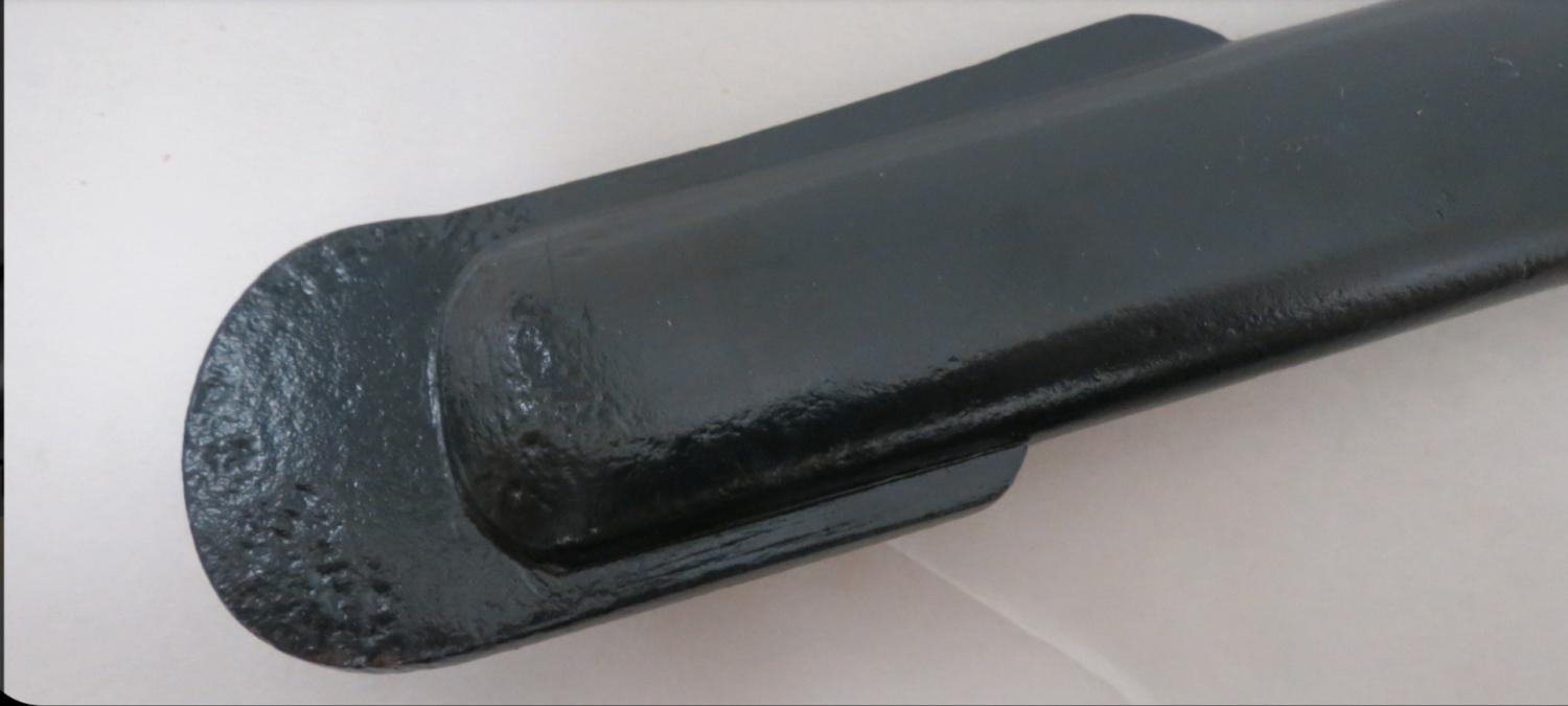

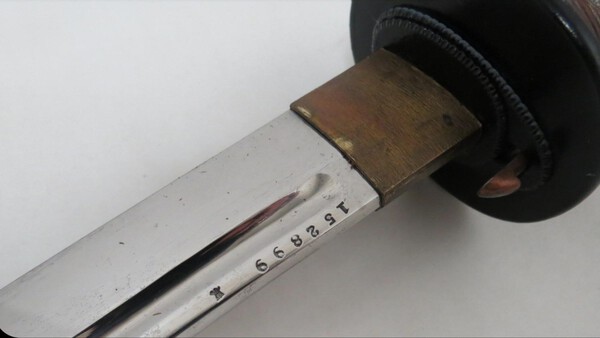

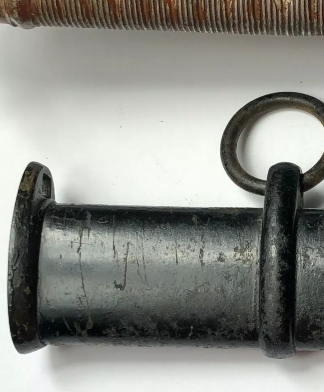

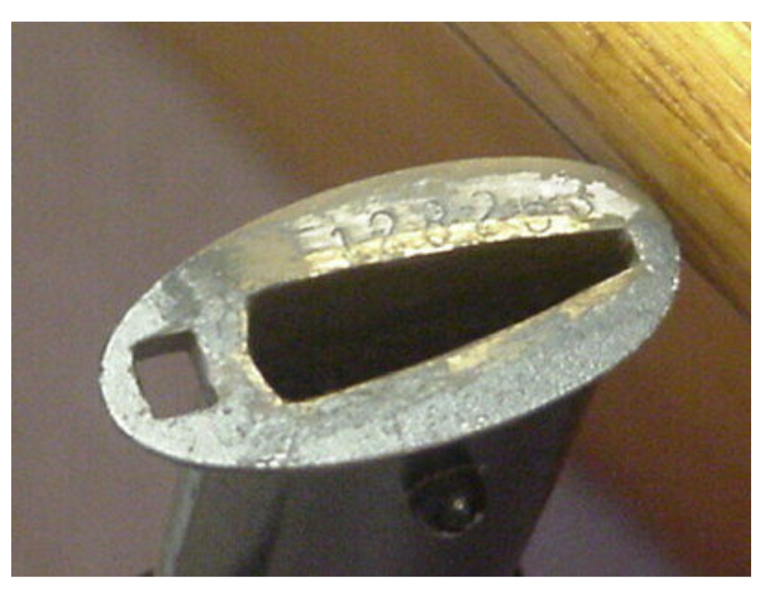

Another example of a re-painted saya, most likely recently and not period. This is a great example of some obvious tells. The patina of the sword is in no way commensurate with the patina of the saya. The tsuka is not even the same shade of black anymore and shows clear patina, totally absent from the saya except for a few sanded marks. The saya throat is another obvious give away too.
The condition of this sword shows it is clearly not even original to the saya. The saya has been restamped and very obviously so. The size and font aren't close and the removal of original numbers is plain to see.

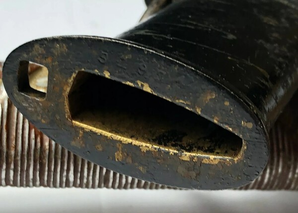

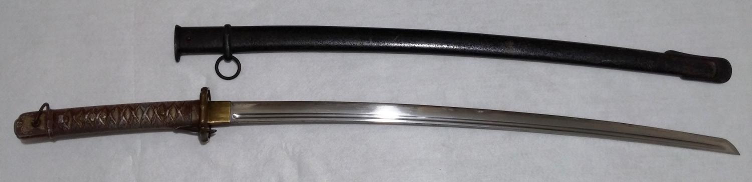

Another repainted saya. Still adding examples to this thread to support my hypothesis. I'd like to get some more of the Pattern 5 though as this is the particular example claimed to have the originally painted 'rare black' saya.
