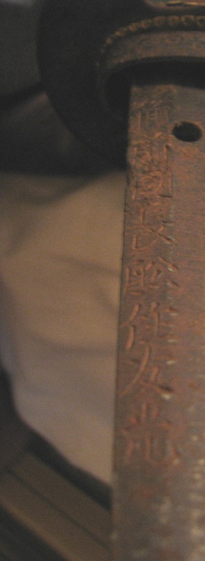

James Posted August 12, 2008 Report Posted August 12, 2008 Hi all, Can anyone help me find some information about this smith, the one who signed: å‚™ å·ž é•· 船 ä½ å‹ å…‰ Please note the Tomo kanji is å‹ not 倫 Quote

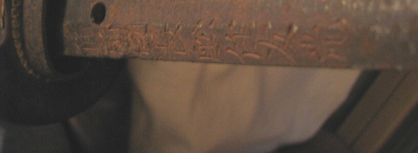

James Posted August 12, 2008 Author Report Posted August 12, 2008 My apologies, it is signed "Bizen Kuni Osafune Ju Tomomitsu" - signed tachi-mei. Please see the attachment. Quote

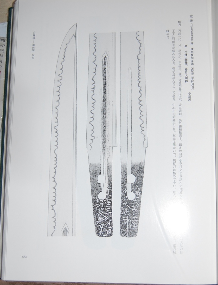

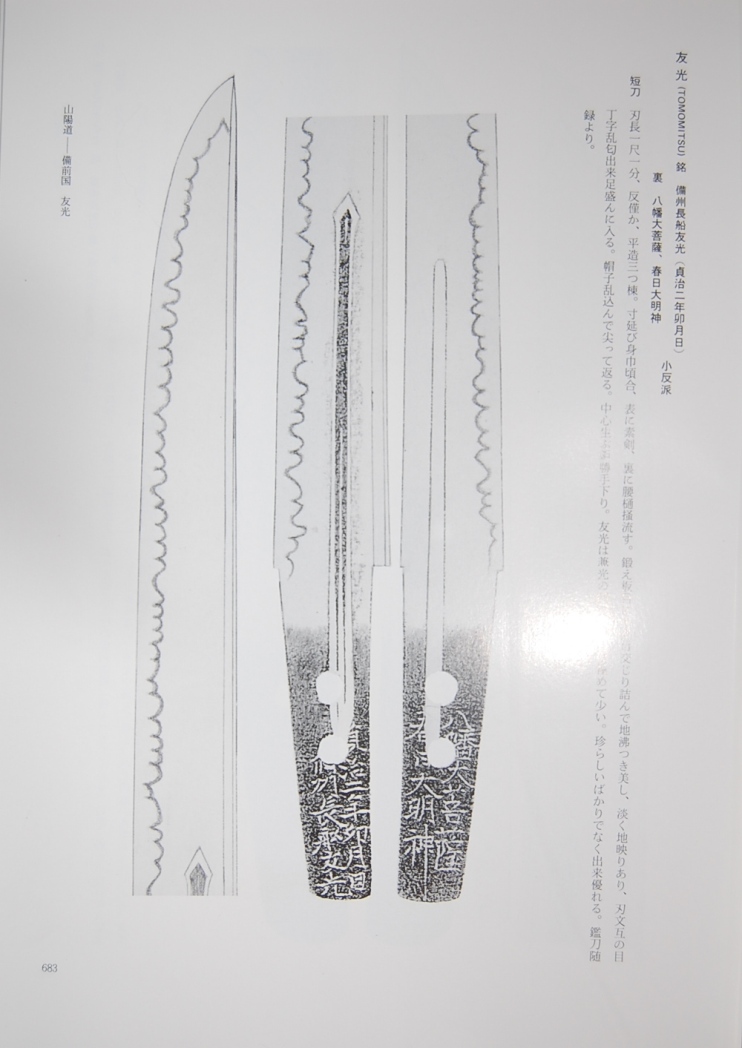

Grey Doffin Posted August 12, 2008 Report Posted August 12, 2008 Nihonto Zuikan, page 683 is the only hit for Tomomitsu with that Kanji for Tomo in my index. Grey Quote

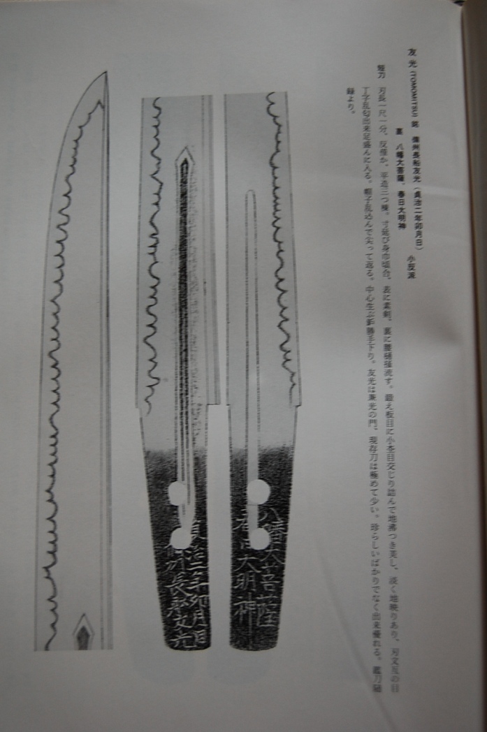

Jean Posted August 13, 2008 Report Posted August 13, 2008 Quote Too bad we can't find any oshigatas or photos to help us with this. You can James, here it is. Sorry it is a bit fuzzy but this book weights one hundred tons and I had to hold it to prevent damaging it Quote
