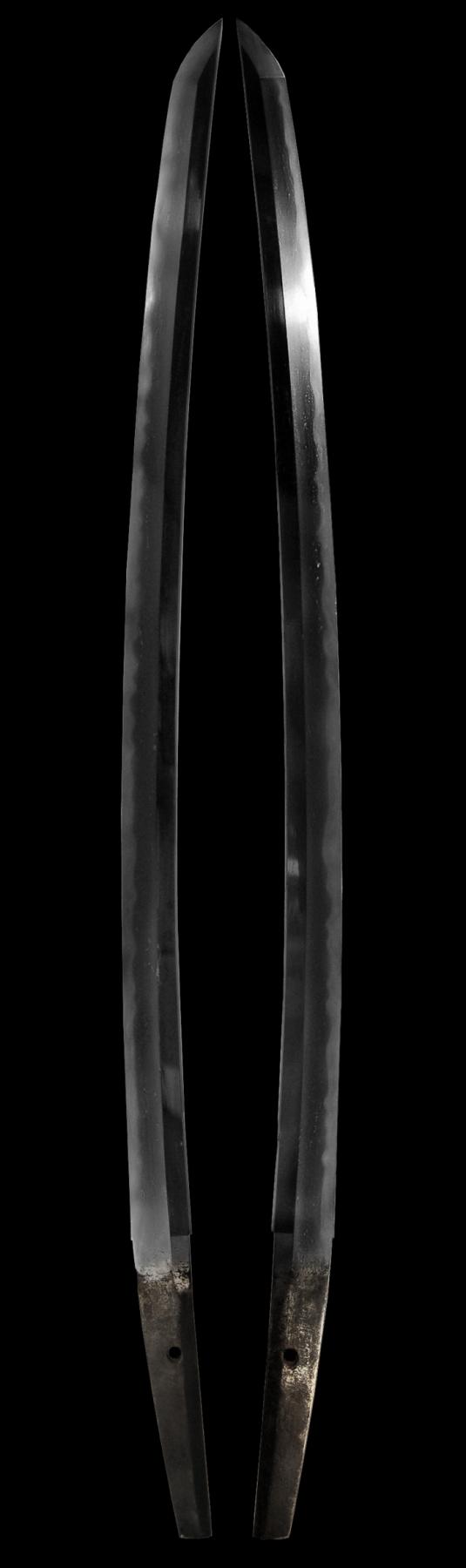

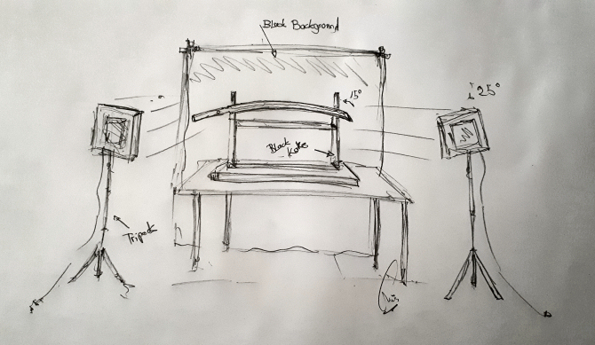

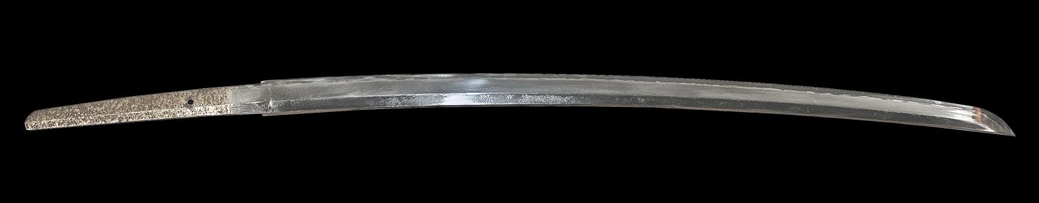

As a little holiday project i will try to improve my blade pictures. I want to build a cheap camera studio setting which should not cost more than 50 EUR and need less space.  :laughing: (After picture shooting to store it in the closet).

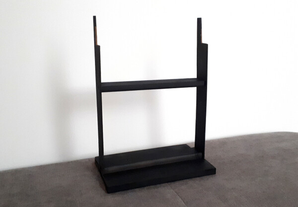

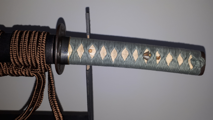

I build a stable blade stand with 15° and small leather stripes on a flat condition. Its colored opaque black.
The stand test was successfully, the sword didn't slip away  :laughing:

Chris, that's a nice setup. Maybe you can add white screens on both sides. Then put the tripods on the sides. The white screens will soften the light and reduce the dark shadows.

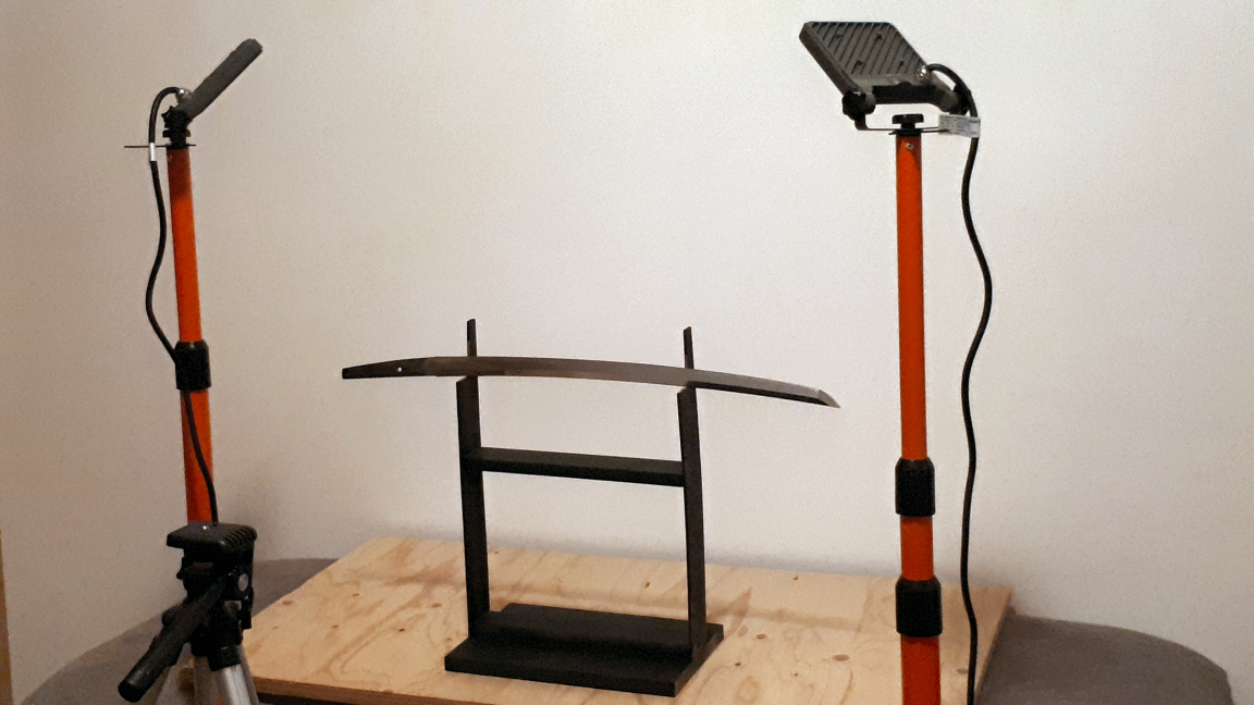

I found some good lights (i think they are good) for a cheap price. Both for 34 EUR with Osram LED and Stand.
This is how the setting look like.

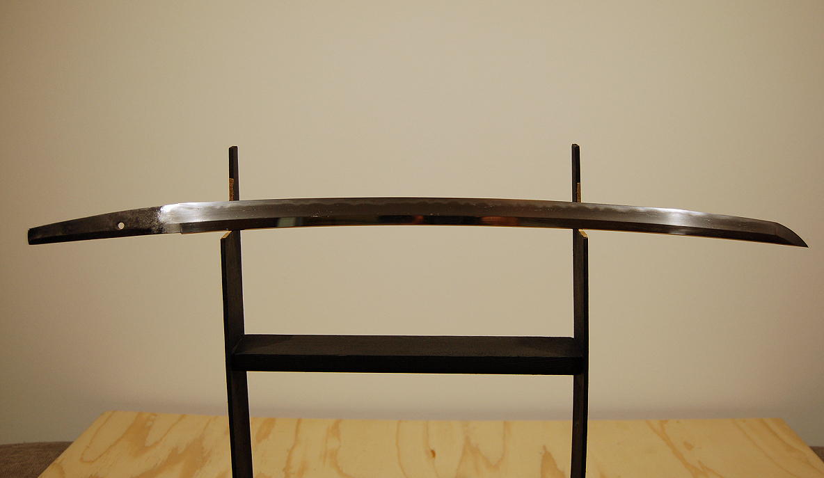

After trying around with the lights and some shots i got this.
At this point i found out that my Nikon D50 from 2005 comes here to thier end. Its max Resolution is 3008 x 2000 pixels. Crazy my smartphone makes higher resolution as this early reflex camera.
If you sit in front of the setting your eye say WOW  :clap:  but my camera lens says  :dunno: But now i think i'm on the right way for the future and i need a third light for the filling of the blade.

Hi Chris,
I don't think the resolution of your old camera is a real problem. The resolution is high enough to take nice pictures. Are you using a tripod and manual focus?
BTW, the results of your photos are promising!

Another day, try and error.
Now i take some shots with 1/8s, f/8, ISO100, in Nikow raw file format that is called NEF with a 50mm lens. The problem is that the Nikon didn't get sharp in details for such a small objekt with autofocus and via manual adjustment you didnt see the sharpness in the search lens. On 3008 x 2000 pixels from 1,50m away there is only mud on the picture.
This was the best i get today.
Hi Chris, maybe you can put an object just behind the blade and use it for manually focus. When focus is set simply remove the object and take the picture.
