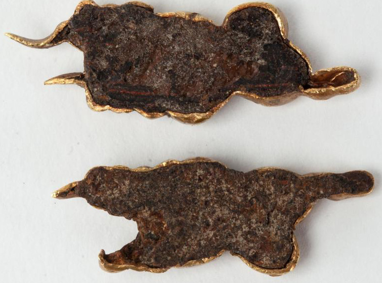

TheGermanBastard Posted June 13, 2019 Report Posted June 13, 2019 I wonder abou the school of these Menuki and wheter they are Gold or Bronce? Quote
Ford Hallam Posted June 13, 2019 Report Posted June 13, 2019 They look to be gold to me, but not Goto as the metal is too thin. 4 Quote
TheGermanBastard Posted June 25, 2019 Author Report Posted June 25, 2019 Thank you for the thoughts, Does anybody have a cheap oppinion on the value? Thank you Quote
PhoenixDude Posted June 26, 2019 Report Posted June 26, 2019 I would say ballpark 800-1k assuming its gold. Quote
Logan09 Posted June 26, 2019 Report Posted June 26, 2019 They seem pretty thin to me. And IMO not of high quality. I imagine they only weigh a few grams and I don't know if Menuki are solid gold or if silver is mixed in as well. So I would say there weight in gold +$ because they're menuki. Quote
TheGermanBastard Posted June 26, 2019 Author Report Posted June 26, 2019 I was looking into buying theme and did not want to overpay. Quote
Higo-san Posted June 30, 2019 Report Posted June 30, 2019 Agree with Logan - I have seen similiar menuki in Japan on sale for around 75.000 Yen. Therefore, be careful, Luis (all is not gold that glitters - even though it may be gold in this case). 1 Quote
TheGermanBastard Posted June 30, 2019 Author Report Posted June 30, 2019 Thank you for your thoughts. Those Menuki are pretty small 2 cm. Even if solid gold the mere metal value is probably not much. I am very undecided on the quality of the Menuki themselves and feel I'd rather pass on them. Quote
Ford Hallam Posted June 30, 2019 Report Posted June 30, 2019 I've actually analysed many Edo pieces and menuki are almost never pure gold in my experience. Very minor traces of copper, 1 or 2 percent, and silver, up to 50%, are usually alloyed in. Where they do look more rich in colour they may still contain a significant amount of gold because it was usual the leach any non gold alloy metal out of the surface to create a surface of pure gold. 2 Quote
