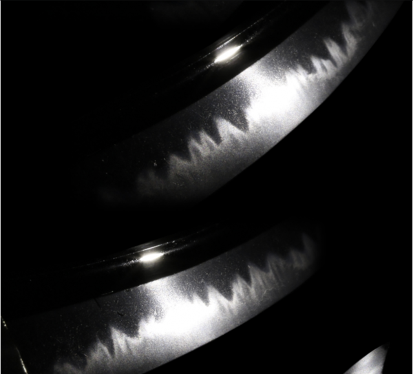

Additional thought, the valleys between each gonome have a squarish feel. Something like Kanefusa.
You can see something similar in this photo (credit: yuhindo.com)
