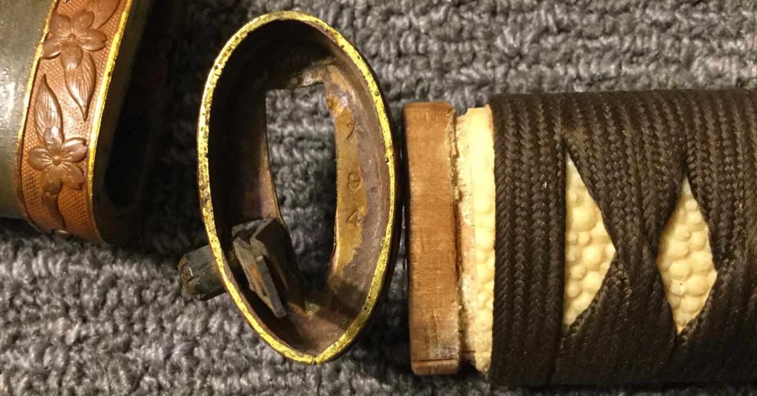

Bruce Pennington Posted May 24, 2019 Report Posted May 24, 2019 This discussion could go on the Arsenal Stamps thread, since it's strayed considerably from the titled topic, but there are some collectors that are quite interested in koshirae, so I think it deserves it's own thread. There are a number of blades that have alpha-numeric numbers stamped on the end of the nakago, and I've started this thread to document the practice, and where possible, identify the reasons for it. Posts by Ray Singer and Chris (Vajo) on the "Show Us Your High Class Gunto" thread (http://www.militaria.co.za/nmb/topic/18610-show-us-your-high-class-gunto/page-7) have revealed two gendaito made by two different smiths that are fitted with near identical, high-quality fittings, and both are stamped with numbers of similar style on the same location of the nakago. I've also recently come across a Mantetsu stamped in a similar way with a number that matches the numbers stamped on the tsuba and seppa. The fittings are high quality, though not the top-quality of Ray's and Chris' examples. The 3 indicate that the numbers on the blades were put there by the koshirae manufacturer/fitter and not by the smith. Ray's: Chris': Mantetsu: 4 Quote
Bruce Pennington Posted May 24, 2019 Author Report Posted May 24, 2019 I should note that George Trotter has already identified a numbering practice on nakago by the Yamagami Brothers on this thread: http://www.militaria.co.za/nmb/topic/8546-survey-of-gunto-contract-numbers/?hl=%2Byamagami+%2Bbrothers So, this thread isn't claiming that all numbers on nakago are done by fitters. And of course, we all know of the Mantetsu practice. If anyone else has examples of nakago stamped numbers matching koshirae, it would be good to document them here. Thanks! Quote

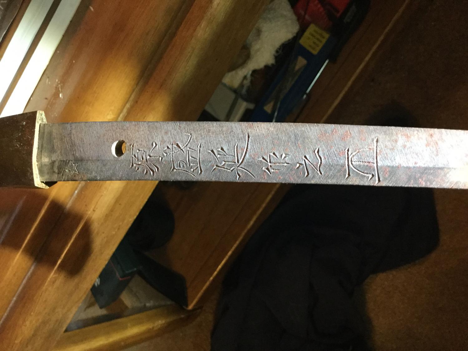

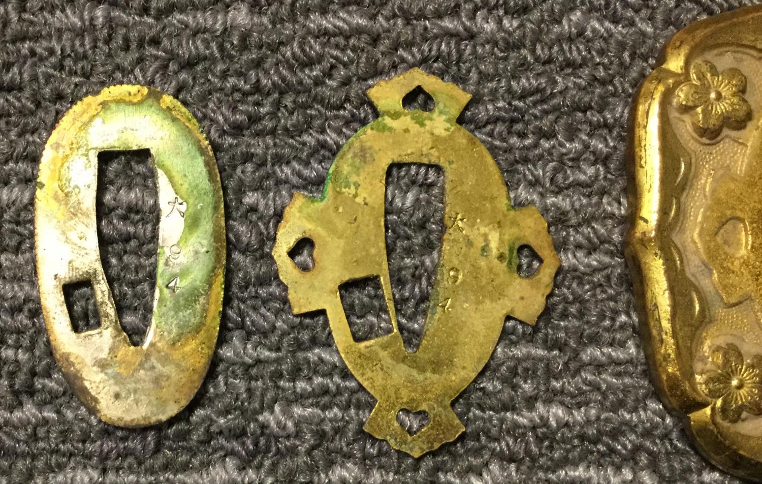

vajo Posted May 24, 2019 Report Posted May 24, 2019 I have another one from Yamagami Akihisa. Stamped no. 618 Black lacquered ito and a different saya that looks like a type98 but the fittings are different to type98. The stamp is on the fittings too. 2 Quote
george trotter Posted May 25, 2019 Report Posted May 25, 2019 Good info guys. Vajo san, I had a good look at the pics and can add a little info to your description. I already have this info, but your pics help a lot. Signed AKIHISA in tachimei.with star stamp. Date side has "matsu in a circle" stamp in front of number 819 (not 618). I know we have discussed these numbers before but it is known that the Yamagami brothers had plain numbers on their tang tips between Sho 16/7 - 16/12 (106-566) They began using the "matsu in a circle" number and star 17/2 - 18//10 (452 - 1377) Started using a "kana" prefix in 19/3 (" i " 2353). This style has been seen on other star stamped RJT swords so seems to be an RJT numbering system? To analyse, I think the plain number and matsu / number may be production output numbers of the brothers themselves, but as the production seems high, could be fittings mounter assembly numbers. The fittings mounters were also mounting swords for other smiths, so could be an explanation of why the numbers seem a bit high for blade production tally numbers. Whether the matsu stamp belongs to the brothers or to a mounting shop I don't know for certain, but I will look through my WWII books and see if there was a mounting shop named "Matsu.something" around then. As the kana prefix numbers are seen on other RJT blades these may be RJT controlled numbers for either production (by district) or again, for use by district mounting workshops. BTW, very interesting fittings. Keep up the good work,. 2 Quote
vajo Posted May 25, 2019 Report Posted May 25, 2019 Hello George, thank you very much for your very interesting informations. You are right, the number is 819 (was mabye to late last evening). I put it to the description on the sword for my records, not to forget. Quote

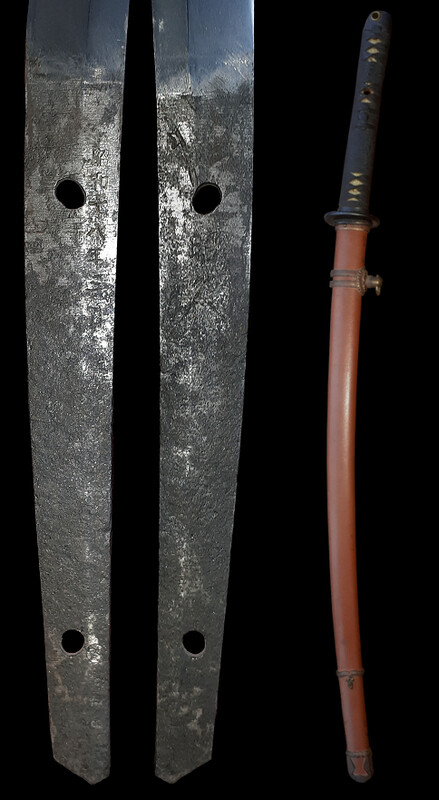

Bruce Pennington Posted May 28, 2019 Author Report Posted May 28, 2019 Another one from the Translation Assistance forum. This one by smith Tomomaro. I wonder if there was a thought by the koshirae makers that painting a number on the tang was lower quality work, and stamping a number is higher quality? Quote

Bruce Pennington Posted November 10, 2020 Author Report Posted November 10, 2020 Update The sample is small, but this is what I have so far. Stamped numbers appear to have begun in Dec 1941, both for the Yamagami brothers as well as all the rest, and ran through at least 1944 (no examples of numbered '45 blades). The vast majority of the smiths are known RJT smiths, including the Yamagami Brothers. But the Mantetsu blades push the issue away from the Army RJT program, toward the idea that a particular koshirae shop was doing it. As we all know, only a very small number of Mantetsu blades have these stamps, and I imagine the same can be said for the listed smiths. Except for kao (kokuin), things stamped at the end of nakago seem to be NOT part of the mei, nor tied to the blades' smith, but rather from another agency (Discussing this idea on this thread). The Yamagami brothers' stamped numbers are unique with the Matsu stamp preceding the number. But even their numbers changed from the Matsu to katakana characters オ and フ in 1944, but we see the same kanji on the Kunishiro and Masakazu blades too, which points us back to an Army, or RJT, numbering system!!! One proposal put forth concerning the Matsu stamp, is that it indicates that the official charcoal, dictated for nihonto by the RJT program, was being used, but after reviewing this list, it makes me wonder why the mark wasn't used on other RJT smith's too, if that were the explanation. Open to thoughts, insights, ideas! 1941, Dec Tomomaru (RJT) 535 tsuba 1942, Apr Masakazu (RJT) 1129 tsuba/seppa “Ni”1129 1942, May Riyuu (RJT) 1301 RS mounts 1942, Sep Morinobu (RJT) 95 Star; tsuba/seppa 1942 Mantetsu Koa Isshin 138 W 1942 Mantetsu Koa Isshin 184 1942 Mantetsu Koa Isshin 234 W 1942 Mantetsu Koa Isshin 278 W 1943 Mantetsu Nan 63 1943 Mantetsu Nan 168 M 1943, Feb Munimitsu 315 Star; RS mounts 1943, Apr Akitaka (RJT) 1098 1943 Munetaka 490 1944, Feb Kunishiro (RJT) オ154 Star 1944, Jul Tomonari 24 on mune Star 1944, Oct Masaharu 6 on mune Star; RS mounts ND Masakazu (RJT) フ37 Star ND Mumei 102 Stainless; seppa ND Hiratoshi 456 Stainless; Toyokawa ND Zoheito 354 (Kanji) 98 mount Quote
Bruce Pennington Posted November 10, 2020 Author Report Posted November 10, 2020 Updated Yamagami brothers chart Matsu 1941, July Munetoshi 106 (RS ana) Trotter Survey 1941, Sep Akihisa 249 Type 98 Trotter Survey 1941, Sep Munetoshi 308 Type 98 Trotter Collection 1941, Dec Akihisa 566 RS Model Windy NMB 1941, Dec Akihisa 577 RS Trotter Survey ? Akihisa 松 61 RS Trotter Survey ? Akihisa 松 97 NMB 1942, Feb Akihisa 松 542 RS star Trotter Survey 1942, Apr Munetoshi 松 11 RS Trotter Survey 1942, Nov Munetoshi 松 422 ? star Trotter Survey 1942, Nov Munetoshi 松 433 RS star Trotter Survey 1942, Oct Munetoshi 松 451 RS Davidequis NMB 1943, Jan Munetoshi 松 508 Type 98 star Trotter Survey 1943, Mar Akihisa 松 618 RS star Schmucker Collection 1943, Mar Akihisa 松 819 RS star Trotter Survey 1943, May Munetoshi 松 1080 RS star Trotter Collection 1943, May Munetoshi 松 1082 RS star baldi1942 NMB 1943, Oct Akihisa 松 1377 RS star Trotter Survey 1943, Nov Munetoshi 松 443 RS star ? NMB 1944, Feb Kunishiro オ 154, star Trotter Survey 1944, Mar Munetoshi タ2353 Type 98 star Trotter Survey 1942-1945 (ND) Masakazu フ 37 RS star IJASWORDS Quote
