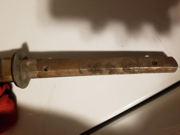

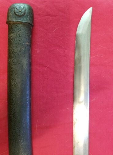

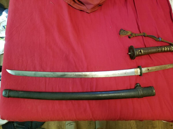

spidersrule123 Posted May 23, 2019 Report Posted May 23, 2019 Hi all, I'm new to this forum but was hoping you guys could shed some light on a sword that was passed down to me by my grandfather who passed away. He served in WW2 and brought it back with him after the war. He left a note with it that says it was taken from a Japanese colonel who was later executed for war crimes at Sugamo Prison. I have been doing a lot of research myself and talked to some friends who know a bit more than I do and they seem to believe the blade is handmade and older but was remounted for use during the war. I also do not know where to begin to try and make out the signature. Any and all help is greatly appreciated. Thanks! Quote
Ganko Posted May 23, 2019 Report Posted May 23, 2019 Your sword is signed ICHI Ryu Shi Saku, It is one of the signatures used by swordsmith Icihara Nagamitsu. Your sword is in type 3 mounts. He made swords for the Osaka Army arsenal during WW2. He is well thought of by militaria collectors. TomC Quote

PNSSHOGUN Posted May 24, 2019 Report Posted May 24, 2019 The tassel on the sword is for company grade officers (lieutenant to captain), major through to colonel rank would have a brown and red tassel. A very interesting and good quality sword. As for polishing do not be tempted to get it done for cheap, you're better off leaving it carefully oiled as is, amateur polishers will likely destroy the value of the sword in the future and do irreparable damage to the careful geometry of the blade. Either maintain the condition it's in now or save up and get a professional to look at it, members here can recommend appropriate Togishi for you. Quote

Tom Darling Posted May 24, 2019 Report Posted May 24, 2019 Hi Ian, To measure properly go to Ray's post and scroll down to the bottom and hit (measure) shows correct way of measuring the length of the blade. Muni-machi to the (point) kissaki. Are there two (mekugi-ana) or just the one rivet hole. Great sword. Tom D. Quote

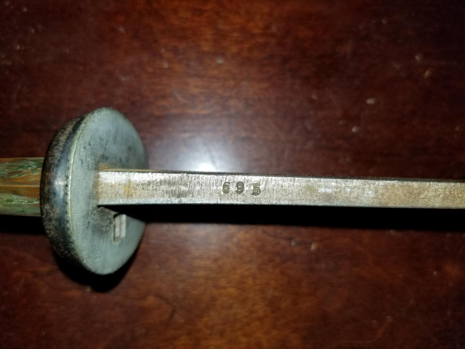

spidersrule123 Posted May 25, 2019 Author Report Posted May 25, 2019 So I measured the sword the way it was demonstrated in the link and it is 25 and 3/8 inches tip to end of brass. There are two peg holes but there is only one metal screw being used. Not sure if one went missing or this is how those mounts were meant to be used. Also, when I took the wrapped handle off I noticed three numbers that are shown in the picture. Does that mean the sword was part of a series or some kind of serial number? Thanks for all the help. Quote
PNSSHOGUN Posted May 25, 2019 Report Posted May 25, 2019 The numbers, as far as can be understood, are related to inventory management. Quote

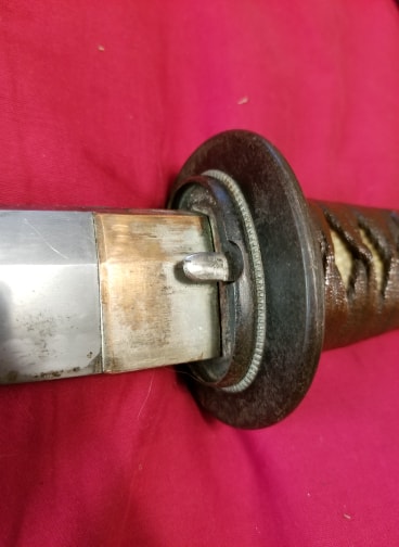

Tom Darling Posted May 25, 2019 Report Posted May 25, 2019 That's what i thought, look on both sides of the (tsuka) handle, if hole was made for the 2nd mekugi-ana. It appears that your nakago had a different handle prior, only one screw for the top hole? Peace. Tom D. Quote
PNSSHOGUN Posted May 25, 2019 Report Posted May 25, 2019 No, Type 3 will invariably have two mekugi-ana like this sword. Quote
Bruce Pennington Posted May 26, 2019 Report Posted May 26, 2019 Ian, The Type 3, or contingency model, had a metal screw close to the tsuba (handguard) and a bamboo peg at the top end. It's fairly common for either one to be missing. You can get replacement pegs (mekugi) online for $3-4 USD. Some guys cut the end off a chopstick. The double-release buttons are an upgrade on the fittings and are mostly found when the blade is traditionally made. Quote
spidersrule123 Posted May 27, 2019 Author Report Posted May 27, 2019 That's really interesting. The sword does have one metal screw by the hand guard but is missing its second peg. There is a hole for one to go in on the handle. I will definitely get a mekugi to replace it with. Thanks for the advice and info! Quote
