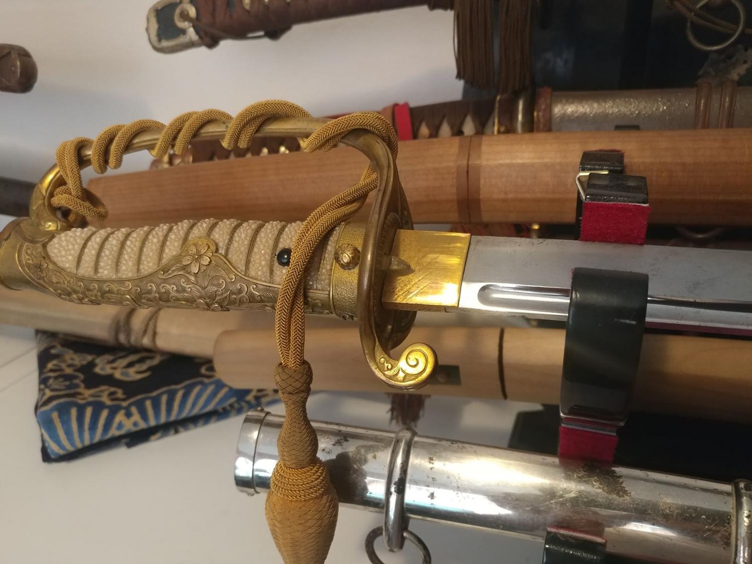

Pika007 Posted May 20, 2019 Report Posted May 20, 2019 Hi everyone I was wondering about a gunto recently posted in one of the local boards, seemingly an 1875 kyu gunto, or type 19 dress sword i just have zero knowledge in this field and, and would appreciate any help determining if this is real or fake. Pictures attached Any comment is welcome, thank you. Quote
PNSSHOGUN Posted May 20, 2019 Report Posted May 20, 2019 Hi Ofek, looks authentic to me, quite a nice example with much of the gilding left. Quote
Jason N Posted May 20, 2019 Report Posted May 20, 2019 Is there a Habaki? I don’t see one, so fake? Better pictures are needed, I can’t really tell what I’m looking at, but I’m a noob so take it with a grain of salt. Quote
Pika007 Posted May 20, 2019 Author Report Posted May 20, 2019 Working on getting better pictures. I compared it with other type 19s and it looked ok to me, but the guy selling it is kind of shady, so i wanted a more experienced opinion. Thank you very both very much, that was incredibly fast Last question- is this an early 20c type 19 or an actual 1875 kyu gunto? All the examples of 1875 i can find have white same and not a black handle so i think it's a 1920-1940's type 19, but again, zero experience, i'd like to make sure Quote
PNSSHOGUN Posted May 20, 2019 Report Posted May 20, 2019 Kyu Gunto dress swords usually do not have Habaki, the blades are non tempered display pieces with etched Hamon. Exact age and model is difficult to 100% ascertain but the earlier pattern will have two hangars on the scabbard whereas the Type 19 will generally have a single hangar. An expert on these swords could probably tell you other things to look for to differentiate them. Kyu Gunto "combat" swords will have traditional blades or oil tempered "Murata-To" type blades with Habaki like this one: 3 Quote

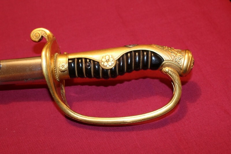

Bridges Posted December 24, 2022 Report Posted December 24, 2022 Update with pics: In my endeavor of hunting for parade swords I have found 2 separate examples that are raising red flags and are either fake OR Chinese copies. I have checked Dawsons and and Fuller but no info is contained to explain these hilts. Let me preface this by saying, while almost all of my parade swords have brass back straps/hilts, I do have one that appears copper alloy in nature (which may point to further variations) but for now, I would like you to observe the odd “sand” in this metal, the sloppiness of the Sakura engraving and the poor overall quality. The type 8 handle has not been peened either, everything is wrong. These are two totally different blades with similar sandy accents. Let me know if you think these blades are real, I’m am very suspicious based off of my personal collection and information in the books. Quote
Bruce Pennington Posted December 24, 2022 Report Posted December 24, 2022 Agree that the first one looks fake. Hard to say about the second based on that single photo. Quote
Bridges Posted December 24, 2022 Report Posted December 24, 2022 @Bruce Pennington check out the “white” spots and the wood grip instead of Buffalo horn. I have heard that they used wood on the type 19 colony swords in Taiwan but this lacks the Taiwan designation. I read that somewhere a month ago so I could be wrong as I can’t recall my reference point. These swords are not shipping from China. They’re actually in some rural parts of the US. I would like to have a fake but both sellers are asking around 600 USD for these things… Quote
Bruce Pennington Posted December 24, 2022 Report Posted December 24, 2022 I don’t think this one is fake. But $600 is too high. They sell for around 450. Quote
