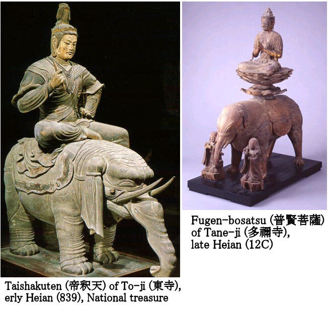

Nobody Posted August 7, 2008 Report Posted August 7, 2008 reinhard, Thanks for the interesting picture. I did not remember the exact image but I think I saw the picture sometime somewhere. Your theory may be right. But I do not know the correct answer. Since elephants were important animals for Buddhism, their real images seem to have been well know from old times. The attached picture shows examples of statues of elephants in Heian period. However, I suspect that the public might not know them. If the image of an elephant of later period does not look real, it might be an intentional stylization. Or that is simply because the artist might not know an elephant. The Kazo Jigoku (ç«è±¡åœ°ç„) may show a fiery elephant as you say, or a mythical Baku. I really do not know. But I also suspect as an amateur’s theory that Kazo (ç«è±¡) does not mean fiery elephant but only fieriness. Zo (象) in that usage might not mean an elephant but something like image or phenomenon. Quote

Guest reinhard Posted August 8, 2008 Report Posted August 8, 2008 Moriyama-san, Thank you for sharing these pictures. The one I posted belongs to the Goto-museum, Tokyo, and was formerly in the possession of Baron Masuda Takanashi. The uncut handscroll consisted of seven sections. Unfortunately the parent scroll, together with another emaki in his possession (also depicting hell scenes), was cut into pieces and following WWII, they dispersed among a number of collections. Some are in the Setsu collection in Japan, others went as far as the Seattle Art Museum. reinhard Quote
