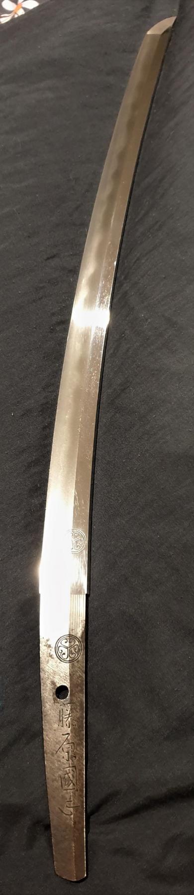

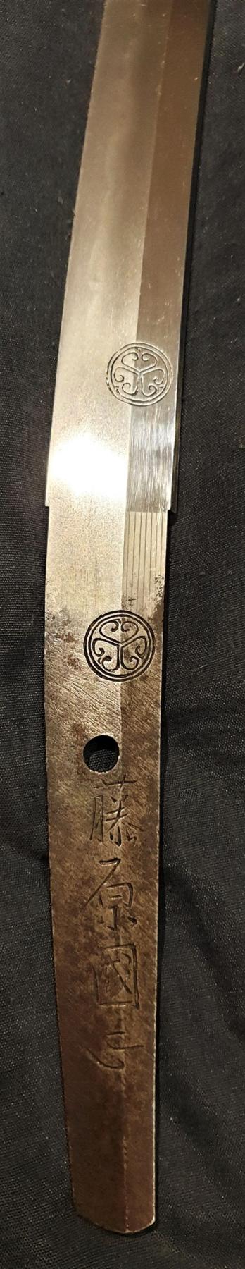

Hi guys i have a wakizashi signed Fujiwara kunimasa i think it could be
shinto-shinshinto but not sure there are a couple of smiths who signed their blades with
a aoi mon any help would much appreciated

Hi Chris,
There's a niji mei of the second generation in Toko Taikan and a similar mei in Kanzan's Shinto Oshigata Dictionary - even taking into account that it looks like someone had cleaned up the tang, neither look like the caligraphy on your sword, though the nakago jiri fits with the school.

It's a bit of an odd one - for me your blade looks like it has some quality about it and the jigane does look (to me anyway) to be in keeping with the school and based on that I would be reluctant to dismiss it as gimei without a good look around.
I would wonder why the aoi crest is carved onto the tang as well as applied as horimono on the same blade......things that make me go hmmmm.
I agree - also it seems like the quality of the horimono is poor compared to the workmanship of the blade itself unless it has been affected by polishing. I'm guessing that its a later add-on and someone, probably outside of Japan, decided to pimp their blade.

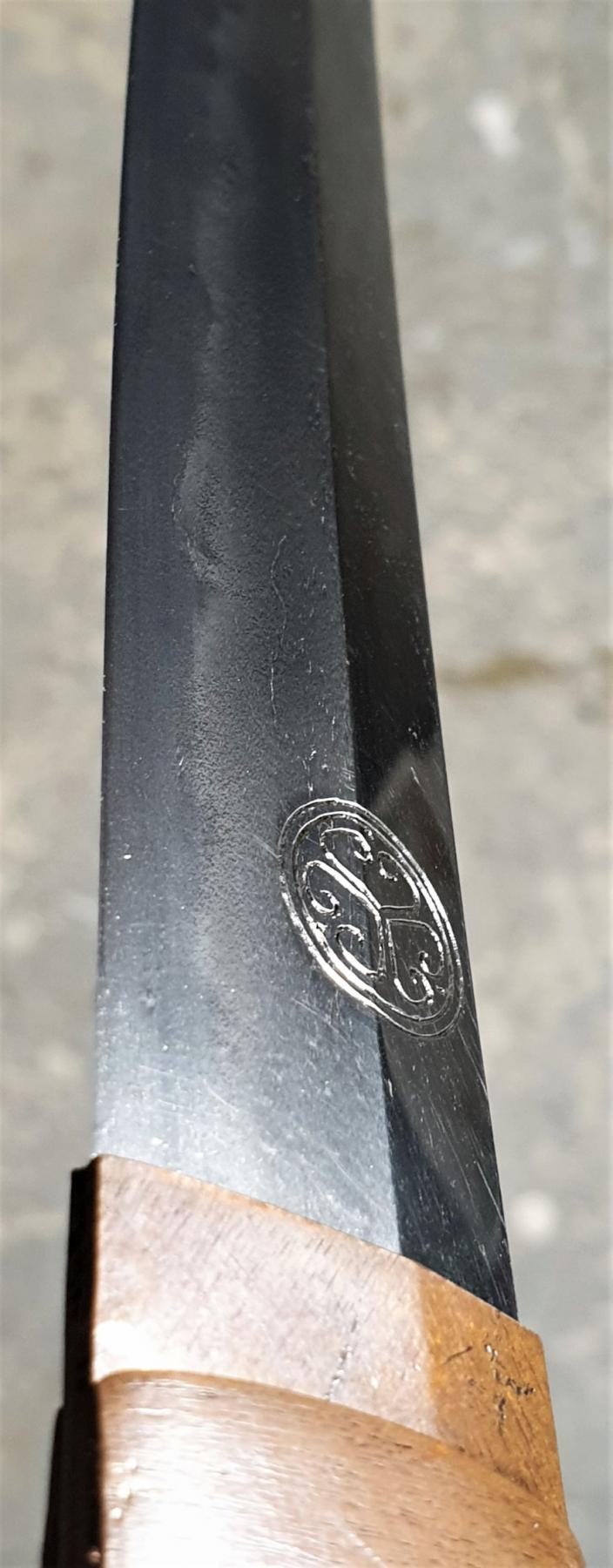

I agree with Steve and John,
The crest on the blade is not executed very well, I don’t think it caused by polishing the blade. The crest on the blade is not the same as on the tang. I don’t know how to call it but on the tang the small carving is attached to the heart shaped object and on the blade it’s attached to the inner circle.
See attached image.
Best regards, Ed
Many thanks again guys for your help i agree with what you guys have suggested
the aoi carved on the blade does look suspect, i suspect i will never no for sure
