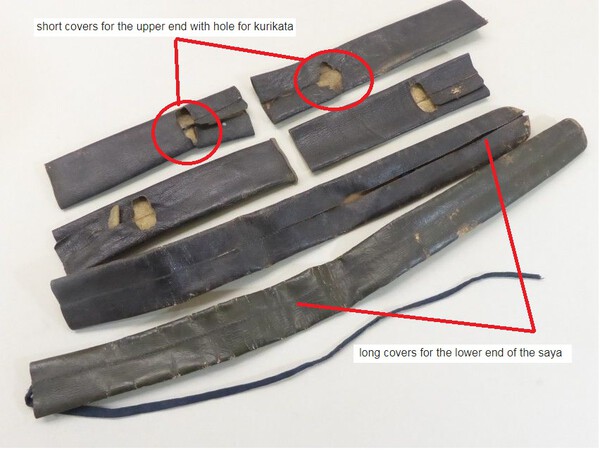

IJASWORDS Posted May 10, 2019 Report Posted May 10, 2019 Often in WW2 photos of officers with their sword, the handles are covered in protective linen, leather or canvas covers. Some wrapped, some sewn, some lace up, some buckled up. They had not endured well over the years, so today they are not that common. Pictured a few from my collection that have survived. 8 Quote

IJASWORDS Posted May 10, 2019 Author Report Posted May 10, 2019 And some NCO swords got the leather covering (rarely). 3 Quote
PNSSHOGUN Posted May 10, 2019 Report Posted May 10, 2019 Have never seen that before, interesting how it's cut out for for the "Ito" to show. 1 Quote
Dave R Posted May 10, 2019 Report Posted May 10, 2019 Traditional way of protecting the Ito, I have a couple of Edo period ones. Which oddly are usually cheaper that the WW 2 version. 1 Quote

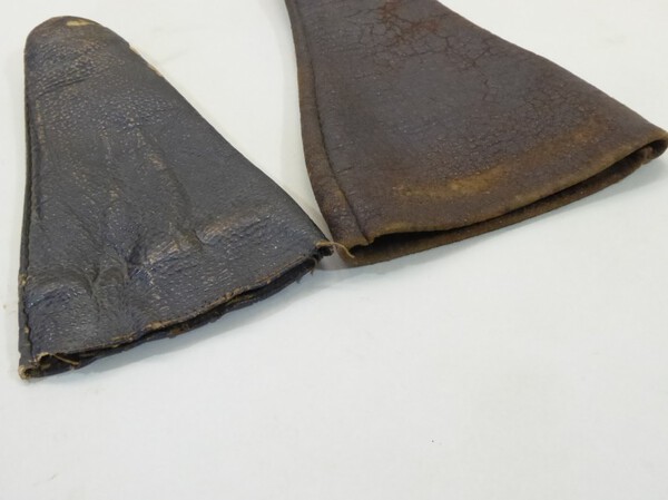

Bruce Pennington Posted May 12, 2019 Report Posted May 12, 2019 On 5/10/2019 at 5:21 PM, Dave R said: Traditional way of protecting the Ito, I have a couple of Edo period ones. Which oddly are usually cheaper that the WW 2 version. Dave, I've never heard - how do you pin the age of a leather cover? Quote
Dave R Posted May 12, 2019 Report Posted May 12, 2019 On 5/12/2019 at 12:44 PM, Bruce Pennington said: Dave, I've never heard - how do you pin the age of a leather cover? Well you can't pin it exactly, but you can ascribe it to an era with some confidence. Traditional covers for saya and tsuka were made of (rape seed) oil tanned leather, rather like buckskin, that was lacquered to make it waterproof. The shape, and level of workmanship are also indicators of age, the old pieces are sewn with incredibly fine seams.. Fortunately they are not super collectable, but very difficult to fake. I have saya and tsuka covers, the tsuka often sold as yari (spear) sheathes... You also get a short open ended cover which is to protect the nice lacquer-work of your two saya from rubbing against each other as they sit in your obi. The tsuka bukuro are slip on's with no draw cord unlike the gunto covers so they can be thrown off in a hurry. Not many bother to collect them, but as you know by now, I am something of a nerd, and I like the accessories. 2 Quote
