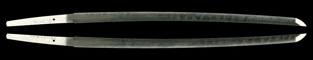

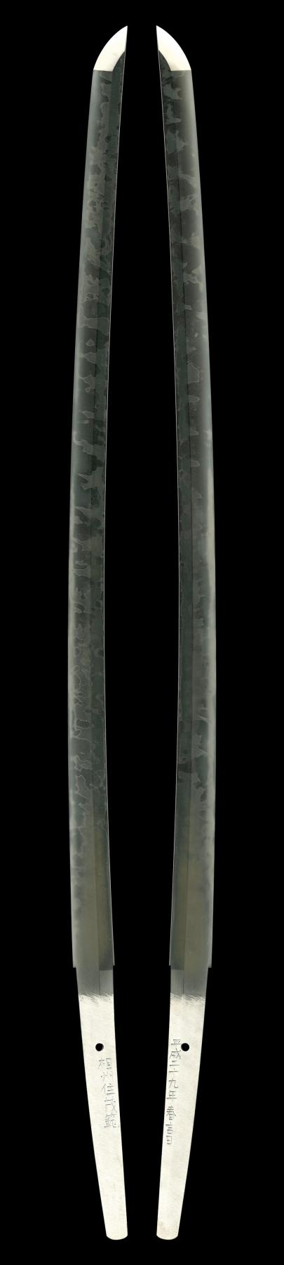

Brano Posted May 2, 2019 Report Posted May 2, 2019 Friends, I'm totally unaware of the issue of Japanese swords. However, I dream long enough to buy one. Today I found one who charmed me. Hamon has an unconventional technique and the sword looks beautiful. However, I would like to hear the opinion of experienced people Thank you in advance for your feedback Quote
Brian Posted May 2, 2019 Report Posted May 2, 2019 Umm.......What to say?...Hmm..... Who made this?Hitatsura appeals to some, and others do not like it. I do not mind it, but this is done very.....oddly.I cannot even see if the hamon is continuous or if it drops off in numerous places. Doesn't look very....controlled.Like someone was deliberately trying to overdo it, and didn't really know what he was doing. I don't know, I really don't. It would be most important to make sure the hamon is complete. Where did you find this for sale? I hope it is Japanese. If so, then shinsakuto. Quote

SAS Posted May 2, 2019 Report Posted May 2, 2019 Hitatsura, wildly uncontrolled, interesting art, but not for a practical sword. It reminds me of the patterns on my favorite eating reef fish, the bigeye. I can't read the mei.Blotched_Bigeye_Heteropriacanthus_cruentatus.width-1200.326af2d.jpg Quote

Brano Posted May 2, 2019 Author Report Posted May 2, 2019 Thank you for your observations guys It's a new sword, made 2017 Rayhan gave the right link https://www.touken-matsumoto.jp/eng/product_details_e.php?prod_no=KA-0190 Did I understand that it is not a good purchase for people who understand it? Quote

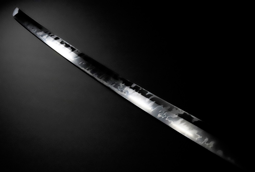

Guest Rayhan Posted May 2, 2019 Report Posted May 2, 2019 Its not that it is not a good purchase but Hitatsura is a specific taste for many collectors. If you like it that is what matters. In terms of collecting the sword is Ubu, signed, dated, prize winning and will paper in the future. Hitatsura really is one of those very specific aesthetic features as most of the blade is hardened in a random manner the collectors who are looking for form and function may set them aside as not collectable. Again a matter of taste. In terms of age it is a young sword so if you wanted an older sword in Hitatsura you would aim at a Muromachi Soshu smith but again Muromachi Soshu was not their shining era unlike Kamakura and Nanbokucho. So effectively this is like a modern Utsushi of a Muromachi Soshu sword. As it is healthy then all you need to decide is, do you like it? If you're after history then your budget can buy you more historic swords. If you're after these particular features then here you go. Some Bizen swordsmiths also did it in beautiful patterns and the swords Sugata is remarkable: https://yuhindo.com/yosozaemon-sukesada-3/ 1 Quote
16k Posted May 2, 2019 Report Posted May 2, 2019 I own a modern (Chinese) hitatsura sword like that that I paid $400. Its nice and very much like your example. Looks cool and showy, but I don’t know if I’d pay that much for a modern hitatsura sword. I also own a Muromachi era Soshu hitatsura katana and if that’s your stuff, I’d strongly suggest getting one as this one as your example looks more like an art piece than a real sword. Also, hitatsura always (at l’est that’s my opinion) look better in picture than in hand. 1 Quote

Rivkin Posted May 2, 2019 Report Posted May 2, 2019 Two big negatives: a. Dense itame without much expression - a bane of all modern production. b. Hitatsura does not have internal activity and is done sort of nioi with ko-nie boundary. The boundary is very sharp (i.e. matching the dense itame) without much activity either. Kirill R. Quote

ChrisW Posted May 2, 2019 Report Posted May 2, 2019 Is that core steel exposed all over it? It looks like it should fail spectacularly if it were to ever be used (hopefully that'll never ever happen). I get that its a purely art piece, but at their core, Japanese swords were meant to be utilitarian items. The samurai lived and died by his blade, like any other swordsman. Quote
Rivkin Posted May 2, 2019 Report Posted May 2, 2019 Kiriil, not sure Brano knows enough to understand our specialized language! Sorry, I would restate: Its a very bright blade that will impress beginner a lot. Very few smiths today work with hitatsura and there are some interesting details here. The choice of forging and tempering techniques is however quite basic and created a product that lacks depth, subtlety and long term appreciation. Kirill R. Quote

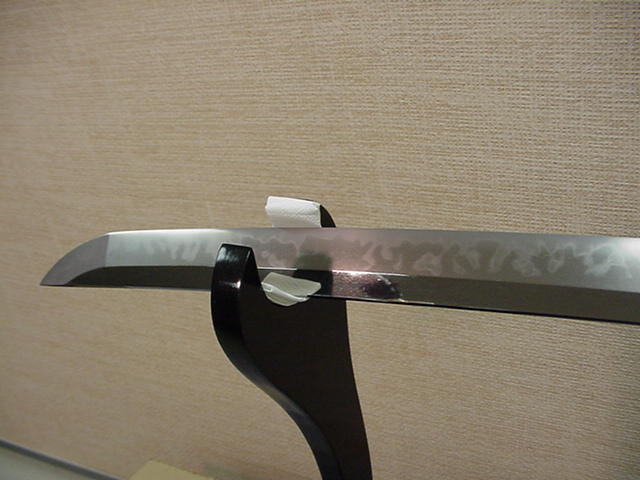

Ken-Hawaii Posted May 3, 2019 Report Posted May 3, 2019 I have an Owari-Seki wakizashi that my wife fell in love with: I can appreciate this type of hitatsura because it's not overkill. 4 Quote

ChrisW Posted May 3, 2019 Report Posted May 3, 2019 @Ken, I can see that one very much still has enough steel on the spine to have structural flexibility. I just wonder about the one he showed us. With it being so wildly erratic, wouldn't it simple find a point where there's little flex and snap/crack through? Regardless, it is a very pretty blade (at the original). Definitely a work of art. Quote
Hoshi Posted May 3, 2019 Report Posted May 3, 2019 No. As kirill said, this is not a desirable modern sword because of the dense steel pattern and the inactive hamon. This is bling to new eyes, I understand that. For this kind of money, you can get a better hitatsura sword which is 500 years old. Your preferences will change as you go deeper into this hobby. 1 Quote

Rivkin Posted May 3, 2019 Report Posted May 3, 2019 I think number one problem with trying to buy an old blade instead would be that hitatsura, even more so than other advanced Soshu techniques, prefers o-tanto, wakizashi format. About 10x times more risk that blade simply blows up compared to almost any other heat treatment pattern. A huge difficulty when making a truly long blade. In ko-waki at 1.2 there is a myriad of choices, beginning with Oei Hasebe (one can even get Nambokucho Hasebe, but the condition will be an issue) or late Nambokucho Hiromitsu line (forgot the name, Motomitsu or something). At 2 we might enter lesser Hiromitsu or Akihiro blades. On younger end, at 400-700k there will be Tsunahiros, Shimadas et al. But any quality hitatsura in daito scale is probably going to be so rare one sees them once a year. Kirill R. Quote
Hoshi Posted May 3, 2019 Report Posted May 3, 2019 Hitatsura killed Soshu. It was a high-risk innovation and it failed to convince its market. It’s not structurally sound at all. I regard it as one of the corruptions which would soon follow in the Shinto Era. Choji was an attempt at bling. It failed. Hitatsura was an attempt a bling. It failed. And then during peace time we have no more metrics of failure and things like drawing Mount Fuji in the Hamon suddenly become popular. The other way to see it is that Wild Choji and Hitatsura were ahead of their time... 1 Quote
