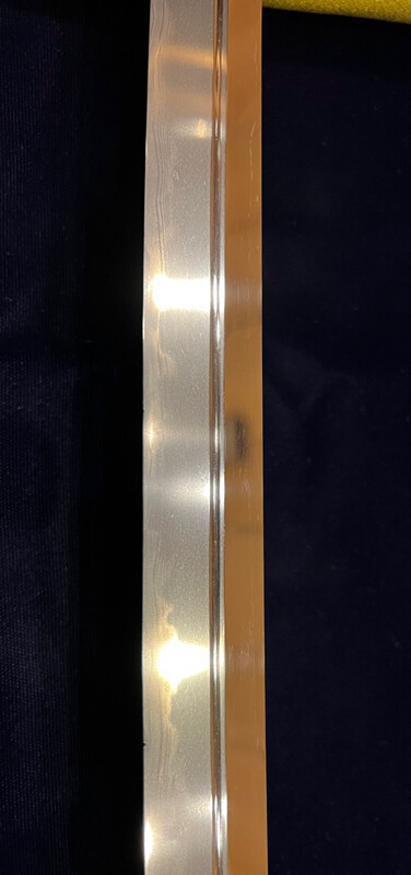

Promo Posted February 7, 2022 Author Report Posted February 7, 2022 Please forgive for not updating a longer time. It missed being submitted to Juyo, so the first try then will be this year - another year in Japan! The time will be used nevertheless with sayagaki. I though got some additional pictures that show more of its beauty and make me look highly forward to it. Find them attached. 9 9 1 Quote
ROKUJURO Posted February 7, 2022 Report Posted February 7, 2022 A very beautiful sword, and a nice polish that reveals the features and does not hide them under a strong KESHO camouflage! 1 Quote
Gakusee Posted February 7, 2022 Report Posted February 7, 2022 Thanks, Georg. This is a tour de force of sunagashi! We appreciate your great updates of this exciting journey. 1 Quote

Promo Posted February 8, 2022 Author Report Posted February 8, 2022 On 2/7/2022 at 6:17 PM, b.hennick said: I think that you should wait until after the juyo shinsa to get a sayagaki. The fact that it got juyo can be part of the sayagaki. Expand That, to my surprise went very fast this time. The Sayagaki by Tanobe is already done - and I even have a nearly full (since opposite side missing) translation by @Markus for it. The Japanese reads as: Quote 山浦環正行 生ブ区送五字銘ヲ有シ天保十年ノ製作ト推セラル裏ニハ二年後ノ天保十二年八月二十六日山田五三郎ガ截断ヲ行ヒタル処鳫金土壇拂デアリシ旨ノ正行ノ切付銘有之。薙刀直風姿ヲ借ツタル造込而板目流レル肌合ニ丁子・互乃目・小湾ノ交ジル動勢ト変化ニ富ム乱を焼キ沸匂深厚デ金筋・砂流ヲ頻リニ織成シ匂口冴此期ノ同工ノ本領ヲ發揮スル優品也 刃長弐尺参寸八分弱 Expand Or Quote Yamaura Tamaki Masayuki Ubu machi-okuri goji-mei o arishi Tenpō jūnen no seisaku to oseraru ura ni wa ninen ato no Tenpō jūninen hachigatsu nijūrokunichi Yamada Gosaburō ga setsudan o okonaitaru tokoro karigane dotan-barai de arishi mune no Masayuki no kiritsuke-mei kore ari. Naginata-naoshi-fū katsutaru tsukurikomi shikamo itame-nagareru hada-ai ni chōji, gunome, ko-notare no majiru dōsei to henka ni tomu midare o yaki nie-nioi shikō de kinsuji, sunagashi o shikiri ni orinashi nioiguchi sae kono-ki no dōkō no honryō o hakki-suru yūhin nari. Hachō ni-shaku san-sun yachi-bu jaku Expand I did get a German translation to this as well, but maybe @Markus can help for others in here with an English translation since I doubt I am able to translate a Japanese to German translation to English without making any errors. 5 3 1 Quote

Promo Posted February 8, 2022 Author Report Posted February 8, 2022 Markus helped me with a proper English translation of the sayagaki. It reads as: Quote Yamaura Tamaki Masayuki This blade is ubu and machi-okuri and bears a five-character signature. The work can be dated around Tenpō ten (1839). The ura side of the tang bears the result of a cutting test that was inscribed by the smith himself. The cutting test was executed on the 26th day of the eighth month of Tenpō twelve (1841) by Yamada Gosaburō and the blade cut through a body at the level of the collarbones and entered the earthen mound below. The shape of this blade imitates a naginata that has been reworked into a katana. It displays a forging structure in itame-nagare and is hardened in a nie-laden and dynamic midare with a wide and clear nioiguchi that is mixed with chōji, gunome, and ko-notare. The ha is rich in activity and also plenty of kinsuji and sunagashi appear, which are interwoven with the forging structure. Thus, we have here a masterwork that reflects the characteristical style of the smith from that time period. Blade length ~ 72.1 cm Expand 6 4 Quote

Promo Posted February 11, 2022 Author Report Posted February 11, 2022 On 2/10/2022 at 4:40 PM, Surfson said: Very nice Georg. Whenever Tanobe San puts the words masterpiece in the sayagaki, it is a very good thing! Expand Thank you! As you might know better than I do there is a lot of meaning to the particular Kanji being used - and Markus was kind enough to let me know in very deep detail on my sayagaki. He told me that mine is classified as "yūhin" (優品), what represents the highest level that Tanobe is using. According to him there is also "kasaku" (佳作) or "ryōsaku" (良作), which as well can be translated as "masterwork" or "excellent work". He though also mentioned that a very rare exempt (and superior to yūhin) would be "saikō-kessaku" (最高傑作), what can be translated as "biggest masterpiece of this smith" - but he also mentioned that Tanobe stopped using this term a few years ago. 3 Quote
