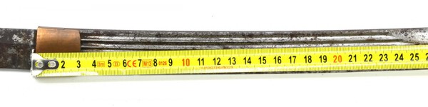

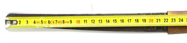

Promo Posted April 21, 2019 Author Report Posted April 21, 2019 I‘m sorry, I had thought I had attached the pictures showing the dimensions... Quote
