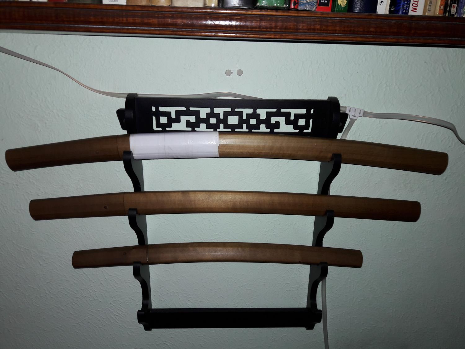

Blazeaglory Posted April 16, 2019 Report Posted April 16, 2019 Years ago I posted instructions for paper and masking tape bands that work very well as a temporary fix for a split saya, and that leave no trace when removed. They also do a great job of keeping the 2 halves of the saya properly aligned for regluing. If the alignment is off just a bit (easy to do) it will bug you forever. I place a few of the bands along the saya before wraping all of it (I use strips of a cotton sheet) to clamp. You'll find my post here: http://www.militaria.co.za/nmb/topic/1414-split-saya/?hl=%2Bmasking+%2Btape&do=findComment&comment=10764 Grey I can vouch for this method working really well. Its a nice little fix in the meantime I've been told that you can moisten the seems of the saya to reactivate the glue (or whatever the proper term is) just using a bit of water. I used water and Greys method above and it has sealed up fine now 1 Quote
