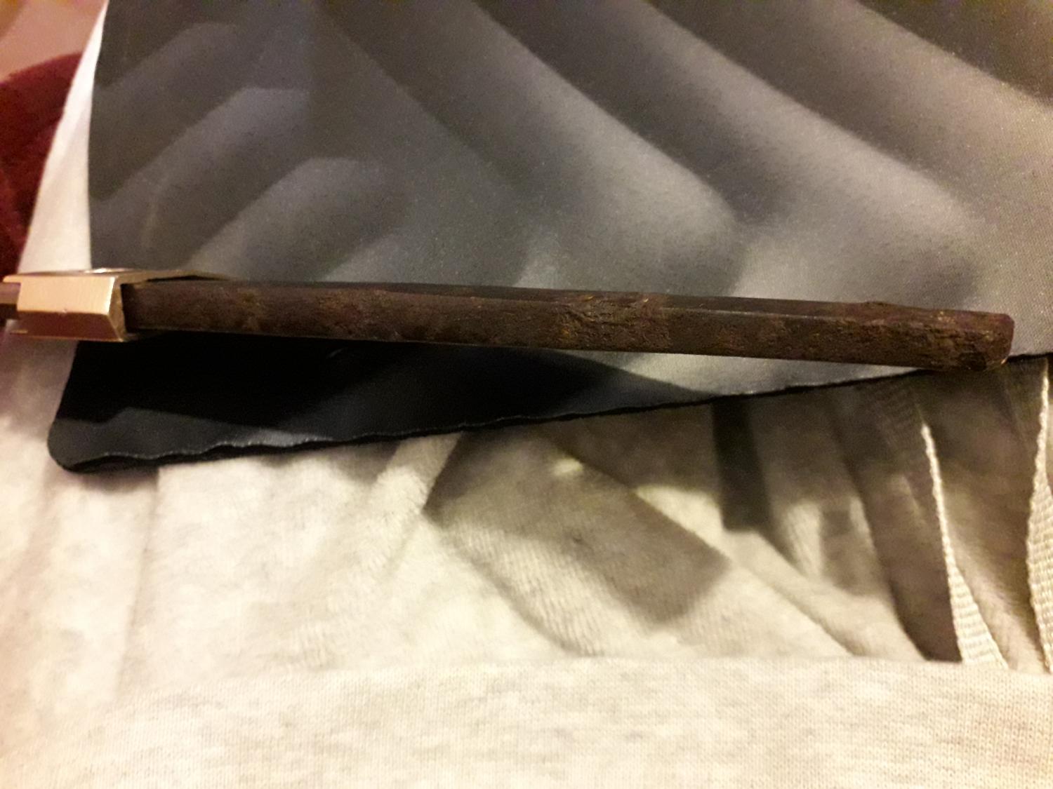

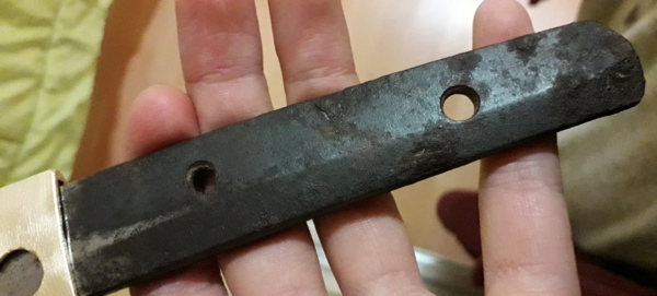

dominnimod Posted April 12, 2019 Report Posted April 12, 2019 Good evening, I have a wakizashi blade i bought from the uk with strange fragments on the nakago. My first guess was Shrapnel? But i don't know, Thanks Quote

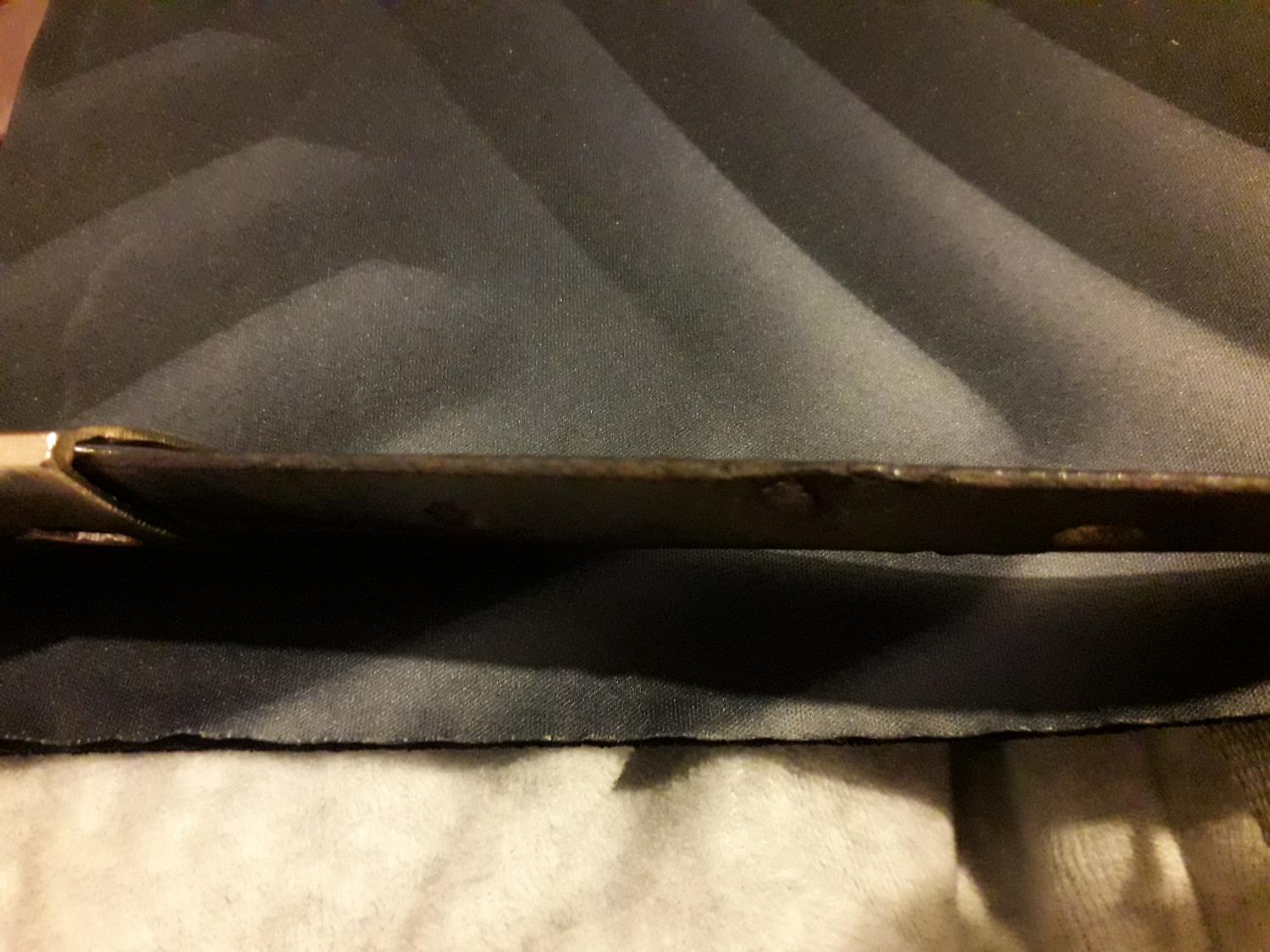

dominnimod Posted April 12, 2019 Author Report Posted April 12, 2019 On 4/12/2019 at 11:00 PM, O-Midare said: Rust? Could be just rust, but nothing on the other side 1 Quote
O-Midare Posted April 12, 2019 Report Posted April 12, 2019 Looks like oxidation to me, Could be wrong but that would be my opinion. 1 Quote

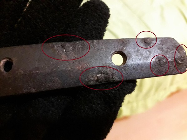

Ken-Hawaii Posted April 12, 2019 Report Posted April 12, 2019 Looks like fukure. Not sure I've seen them on a nakago, but there's no reason they couldn't be there. 2 Quote
dominnimod Posted April 12, 2019 Author Report Posted April 12, 2019 That could be, blade shows some fukure on the opposite side, seems like an old blade who has lost a lot of meat 1 Quote
Ray Singer Posted April 12, 2019 Report Posted April 12, 2019 Thickly caked rust. Tap the raised sections gently with the flat of a brass hammer (nakago nuki). You'll find that the corrosion dislodges and simply falls off. 3 Quote
dominnimod Posted April 12, 2019 Author Report Posted April 12, 2019 I see, Dwayne was right Many thanks Ray, one question, if it falls, the metal underneath has same patina as the rest of nakago? or may be lighter? Is detrimentral to leave it like that or is aesthetic only? 1 Quote
Ray Singer Posted April 13, 2019 Report Posted April 13, 2019 In my experience the underlying patina will be the same as the rest of the nakago. Some gentle work with ivory or bone may be needed to remove lingering areas of active, accumulated rust. 4 Quote

Peter Bleed Posted April 13, 2019 Report Posted April 13, 2019 It is rust. Leave it alone and it will either come off and stay like it is. P Quote
Ken-Hawaii Posted April 13, 2019 Report Posted April 13, 2019 Ray, I always thought that "active rust" was red. Is it different for the nakago? 1 Quote
Ray Singer Posted April 13, 2019 Report Posted April 13, 2019 Ken, from the second photo above this does look like active rust. Also from what I've seen, there would be active, ongoing rust underneath those entirety of those clumped areas. The Yasumitsu just listed on Aoi seems to show the cratering that is left behind after those raised areas of corrosion have been addressed. https://www.aoijapan.com/img/sword/2017/17464-2.jpg 2 Quote
