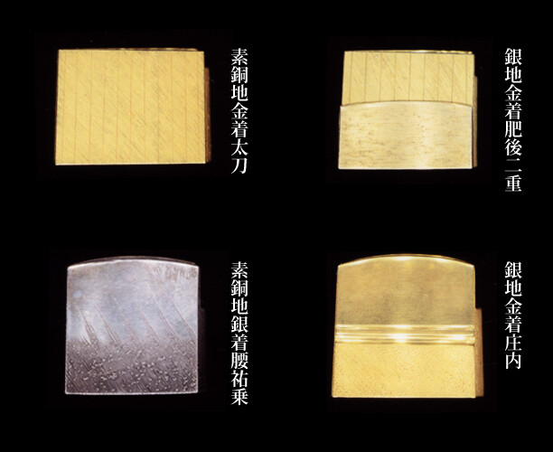

Anyway NBTHK says that Habaki are classified into “Tachi-Habaki†and “Katana-Habakiâ€.
Ref. http://www.touken.or.jp/syurui/tosogu.html

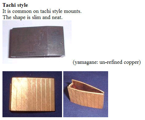

First off, thanks to everyone who has responded. I've learned something new. The reason I brought up the question is because of a blade that I've just acquired. The habaki on it is very short considering the length of the blade when you compare it to the normal proportions seen in most habaki. It just made me wonder if it is the so-called tachi habaki i had read about. I'll include a picture.
I can't find my camera right now so I used my cell phone. I apologize now for the picture quality but I hope it can convey what I am refering to as far as the height of the habaki.
The blade has a nagasa of 77.6cm and the habaki is 1.7cm at the ha and mune and 2cm in the center.

I do not think that your Habaki is a Tachi-Habaki. Usually a Tachi-Habaki is thinner and has Shinogi, I assume. :?:

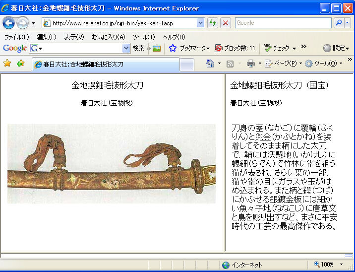

The 2nd picture shows the Upper Tachi on Kasuga Taisha site.
The 3rd picture shows another image of the lower Tachi of Jingu Chokokan.
