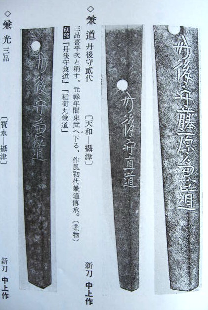

trygve Posted July 30, 2008 Author Report Posted July 30, 2008 Thanks for the input ! I do have the AFU translatinon of Fujishiro shinto on my computer but not my books with me. The plate on s 69 says there are two exampels of : KANEMICHI TANGO NO KAMI SHODAI [KANBUN 1661 SETTSU] SHINTÔ JÔSAKU He is the second son of the nidai Kyoto Yoshimichi, he has the Gô of Yoshibei, and he was also called NAOMICHI. He died at the age of 70 in Kanbun Jûninen (1672). His works are tempered with a hamon of a beautiful uniform choji, or a kikusui ha or sudareba like that of Tanba no Kami Yoshimichi. At the base there is sugu yakidashi that is characteristic of Osaka Shintô, and there are many which have the KIKU MON and "ICHI" inscribed on the ura of the nakago. (Ryôwazamono) Signatures: TANGO NO KAMI NAOMICHI MISHINA TANGO NO KAMI FUJIWARA KANEMICHI TANGO NO KAMI FUJIWARA KANEMICHI and the KIKU MON is inscribed. Page 69 Plate I: TANGO NO KAMI FUJIWARA KANEMICHI Plate II: TANGO NO KAMI NAOMICHI Anybody with the shinto book can veryfi this ???? Sincerely trygve Quote

trygve Posted July 30, 2008 Author Report Posted July 30, 2008 thanx Grey! The mei looks the same as the example in the middle. Both the hamon, hada and the filemarks resemble Tango no kami Naomichi aka Kanemichi. My conclusion is Sho shin, but I will never know for sure before a shinsa team has seen it. Thanx for all the input and help! Sincerely trygve Quote
DirkO Posted July 31, 2008 Report Posted July 31, 2008 Hmmm, can you tell me the difference in filemarks ? To me it looks rather the same. The fact that there is an ura-mei is not that important, I still have to decypher it exactly, but it should mean something like "made of pure ore" For me, the signature is a close match, but as you say, only shinsa can decide that If you ever decide to sell it, you can always contact me. If the mei match and it is kanemichi, then it would make a nice daisho set @ Grey : thanks for posting the fujishiro pic !!! Quote

trygve Posted August 9, 2008 Author Report Posted August 9, 2008 Hello again! Found another referen!ce that confirm my thought on the mei being shoshin! regards trygve Quote
DirkO Posted August 10, 2008 Report Posted August 10, 2008 Hmmm that one also has the kiku mon engraved. That's a dead giveaway for "our" Kanemichi. Where did you find that pic ? Quote
Jacques Posted August 10, 2008 Report Posted August 10, 2008 Hi, Quote KANEMICHI TANGO NO KAMI SHODAI [KANBUN 1661 SETTSU] SHINTÔ JÔSAKU He is the second son of the nidai Kyoto Yoshimichi, he has the Gô of Yoshibei, and he was also called NAOMICHI. He died at the age of 70 in Kanbun Jûninen (1672). His works are tempered with a hamon of a beautiful uniform choji, or a kikusui ha or sudareba like that of Tanba no Kami Yoshimichi. At the base there is sugu yakidashi that is characteristic of Osaka Shintô, and there are many which have the KIKU MON and "ICHI" inscribed on the ura of the nakago. (Ryôwazamono) Signatures: TANGO NO KAMI NAOMICHI MISHINA TANGO NO KAMI FUJIWARA KANEMICHI TANGO NO KAMI FUJIWARA KANEMICHI and the KIKU MON is inscribed. Page 69 Plate I: TANGO NO KAMI FUJIWARA KANEMICHI Plate II: TANGO NO KAMI NAOMICHI Sorry, i had not checked this name, i ought to have done it because it is the same swordsmith :? Quote
