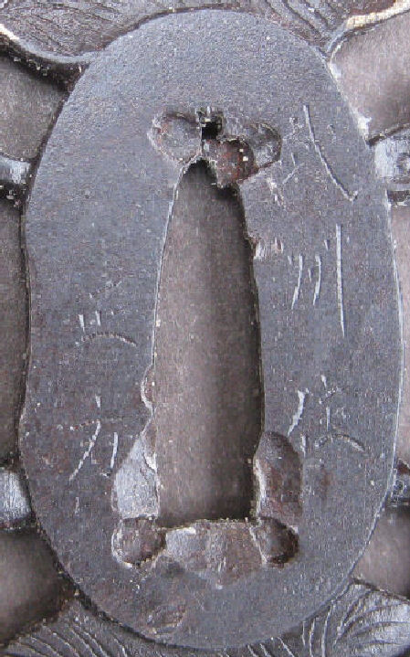

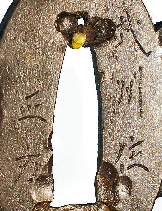

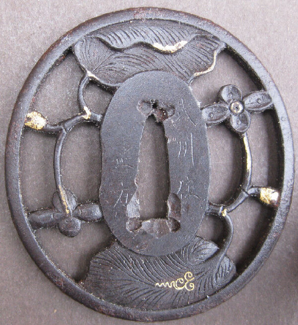

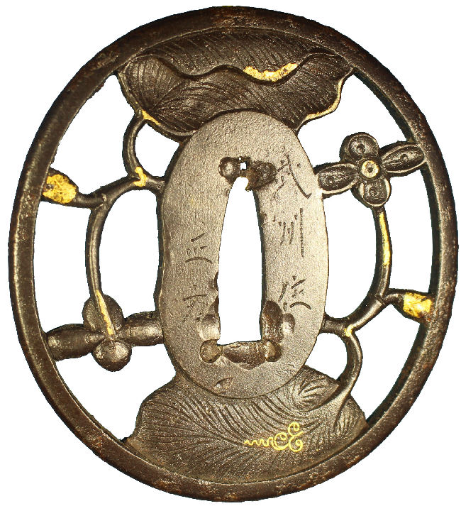

kissakai Posted March 24, 2019 Report Posted March 24, 2019 Hi Probably wasting my time but here goes. I’ve just seen a post requesting info for a tsuba but the image is on an angle and not very clear. I’m sure that some members bang out one or two images without looking at the results and hoping someone will respond. I never reply to these posts. Ideally for a tsuba please show both sides and one on the edge. Why not take a few images inside and outside in natural light also slightly differing angles may show up the mei better. No disrespect but taking images is not that difficult. Take a few and show the best. Even better if you have a photo programme like paint shop pro to do a few tweaks. I size mine so the longest side is around 10”/250mm. When it is displayed on the NMB it is big enough to see detail but not too big for the screen (not sure about how it will view on a tablet or phone) or taking ages to open. Here is an example of the difference you can make by putting in a bit more effort. With reasonable images you will get a much better response Grev 3 Quote
TETSUGENDO Posted March 24, 2019 Report Posted March 24, 2019 Good shots, Bushu ju Masakata, Edo......see how easy that was! -S- p.s.- from the signature, quality of workmanship, and gilding style, the maker would be the mid/later 19th century maker and not the 18th century one. Quote

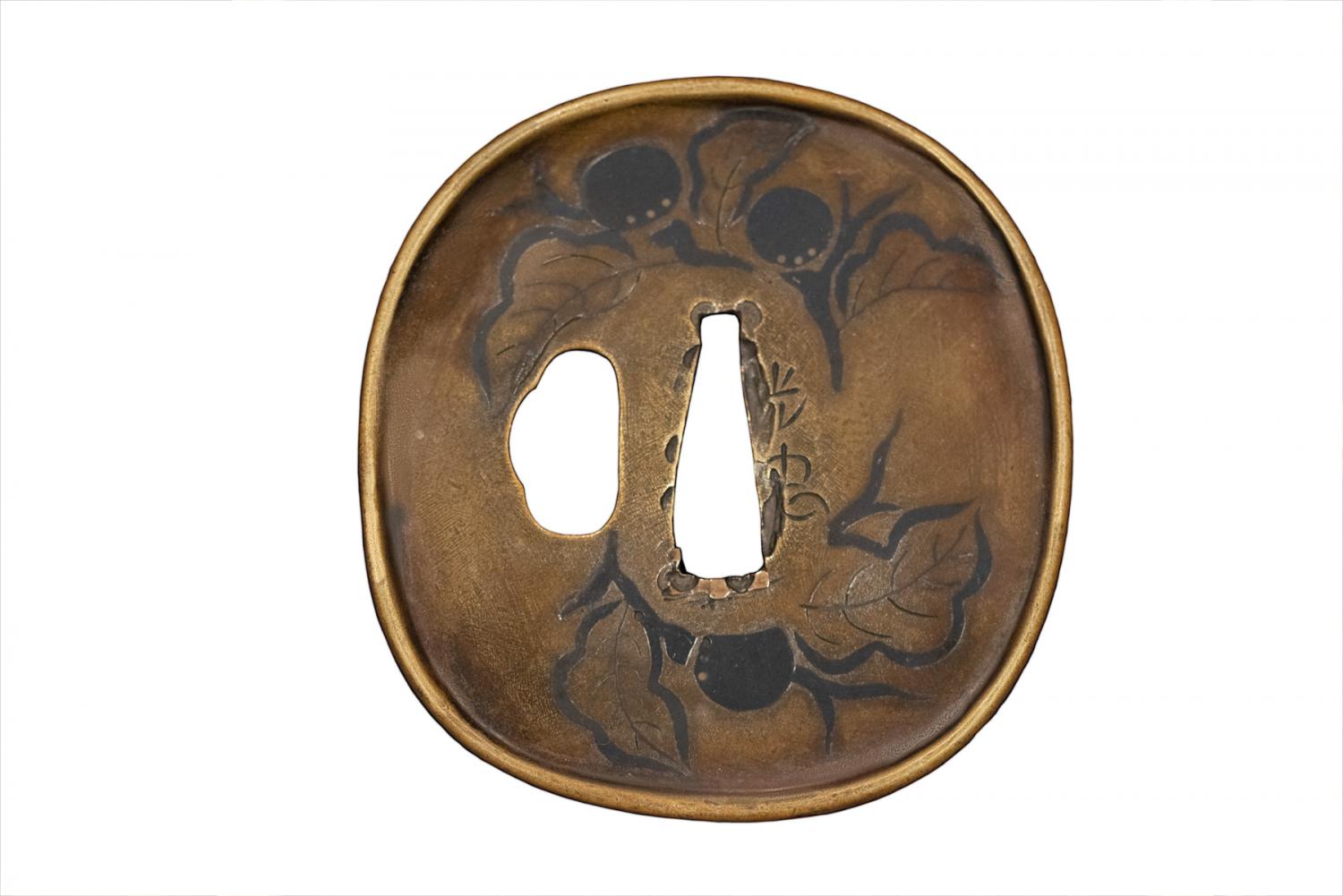

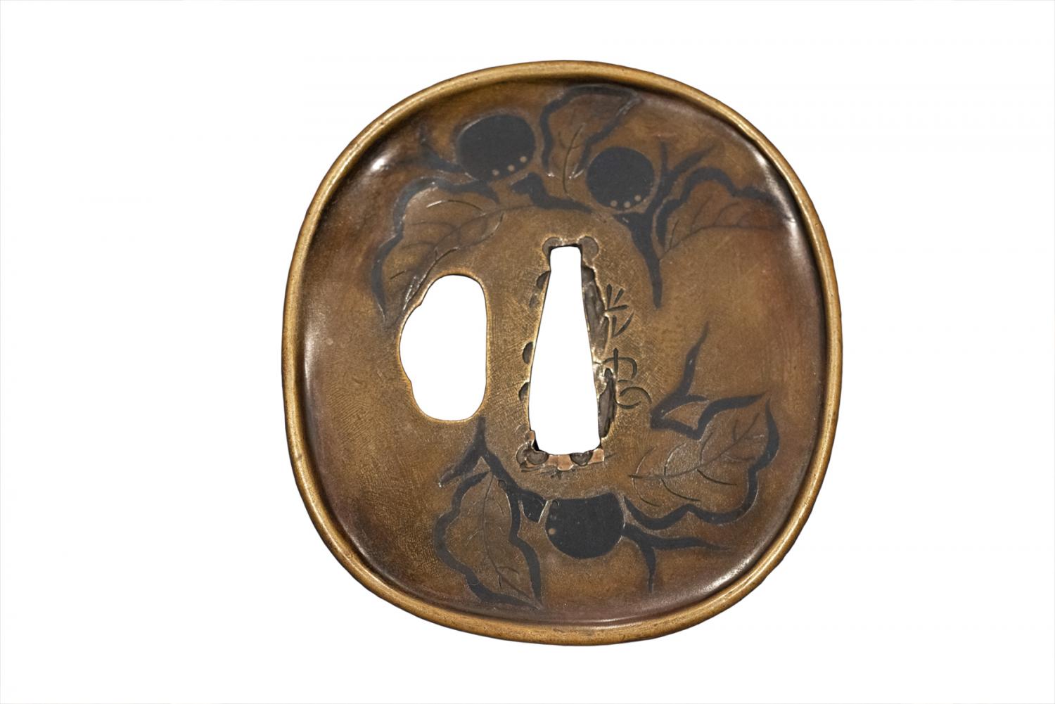

Steves87 Posted March 30, 2019 Report Posted March 30, 2019 Hello! on photos, I thought i might take the opportunity to test the waters a bit. Ive been trying to get an acceptable personal standard of posting pictures. Please can I have feedback (positive or negative) on below picture. Lighting, clarity and size of pic is what im trying to confirm. Ive found diffused white light with a neutral background gets the closest to actual Tsuba colour. The Tsuba above is actually more of a chocolate colour for perspective. Edit: I can see my cropping may be no good. I hope it is ok, i have posted this here. I can start a new threadif im out of line 1 Quote
TETSUGENDO Posted March 30, 2019 Report Posted March 30, 2019 Grev, I must disagree with your disagreement, Chris's statement is accurate. Your initial remarks are documented , all anyone has to do is read them...so please no "gaslighting". Your amended suggestion of selecting from multiple pictures is a good and practical solution, so best leave it at that. Cheers, -S- p.s.- Steve, your picture is fine, perhaps a tad dark, but focused and clearly readable 2 Quote

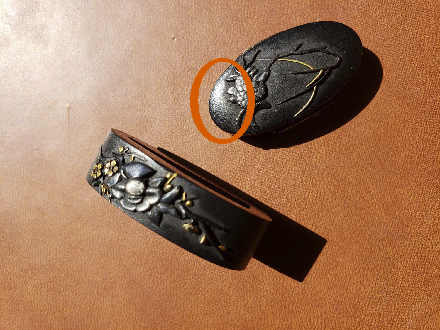

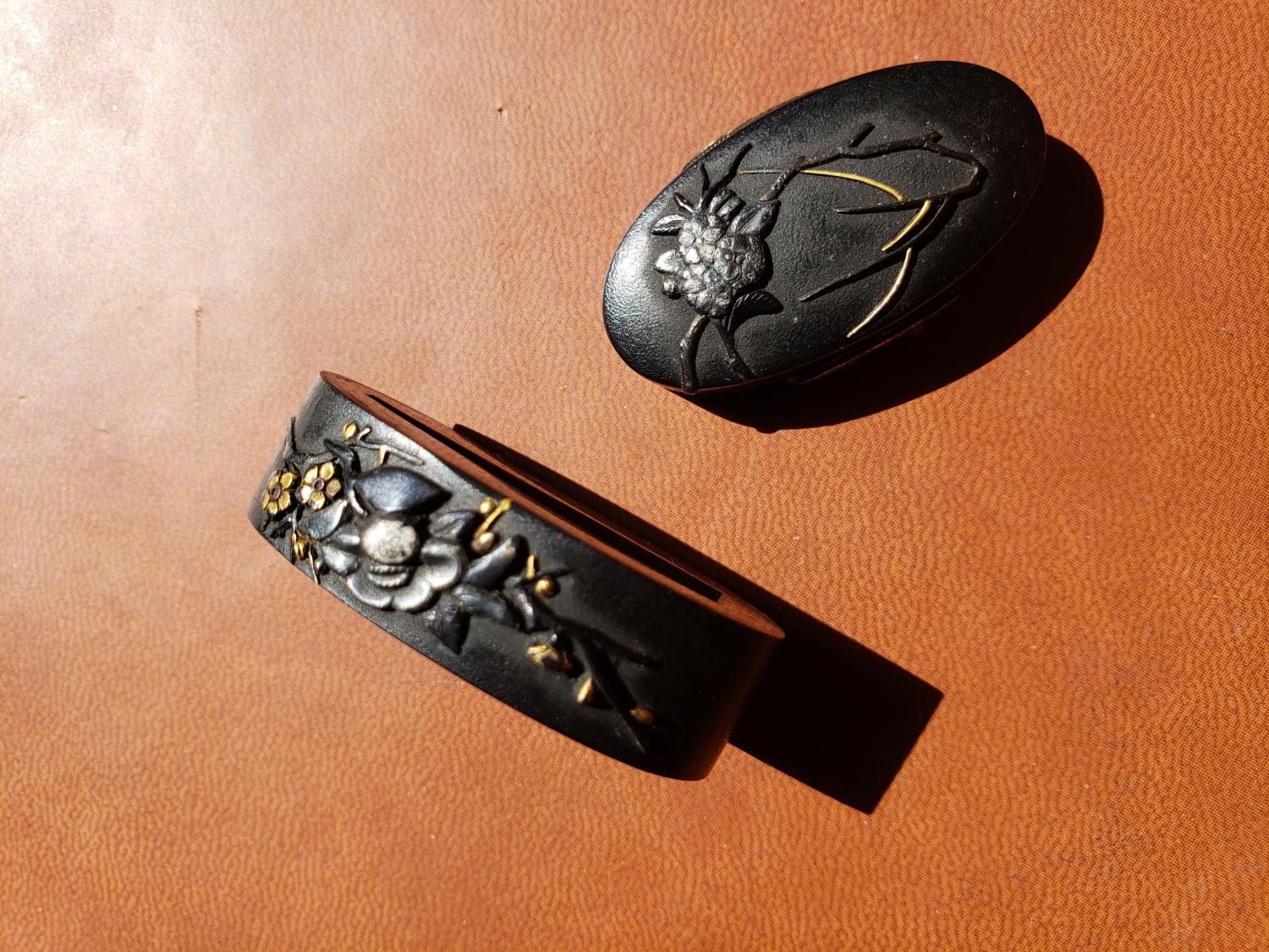

raynor Posted March 30, 2019 Report Posted March 30, 2019 Outside of a professional setup nothing beats sunlight, the challenge is the angles and getting right focus. Here's a quick shot with sunlight through my window. Quote
kissakai Posted March 30, 2019 Author Report Posted March 30, 2019 Not who to disagree with at the moment Steve K Images are fine to me If I can't get the colour right I state in the post the actual colour or whether it is darker or lighter As before I like to show front, back and the edge A close up of the mei is useful 1 Quote

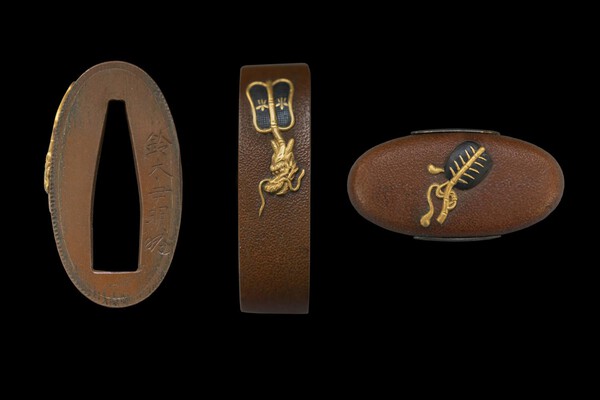

CSM101 Posted March 30, 2019 Report Posted March 30, 2019 On 3/30/2019 at 5:31 PM, raynor said: Outside of a professional setup nothing beats sunlight, the challenge is the angles and getting right focus. Here's a quick shot with sunlight through my window. This is where I disagree. Sunlight is too bright. In your photo you can see an area that is called in german "ausgefranste Lichter". No color, no details. And so I try to avoid sunlight. I work in the shadows. And so a quick shot of mine. Uwe G. 2 Quote
raynor Posted March 30, 2019 Report Posted March 30, 2019 I agree, those photos are better but I am also at fault. Currently live in Miami where the sun is a lot whiter then back home in Norway. I still think sunlight, probably not in the tropics, and a decent angle gets the job done bar a professional setup. Quote
TETSUGENDO Posted March 30, 2019 Report Posted March 30, 2019 Diffused daylight, or a light box would be a better choice, you could avoid the heavy shadows. You can buy light boxes quite inexpensively. -S- Quote

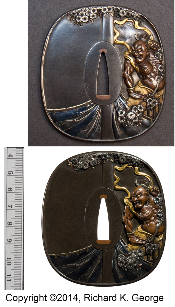

rkg Posted April 4, 2019 Report Posted April 4, 2019 Not meaning to threadjack Grev, but... Uwe, you can light pieces several ways depending on what you want/need to show, your artistic style, etc - and it usually ends up being a compromise on something - you end up with a blown out area because you need to show something/need the tradeoff because the light has to be in a certain position to show something else,etc - that's what makes shooting this stuff sooo much fun :-). While Omar's image could maybe use some improvements (different placement of the camera/pieces to make the blowout smaller, probably some fill to complete the outline of the parts, etc) it does a nice job of revealing the surface of the piece (in that area at least). And your use of light to reduce the dynamic range of the image like you've done is fine too - depends on what you want to show/your style... And surprisingly, sometimes showing "everything" diminishes a piece - a good example of this would be this image: http://www.rkgphotos.com/facebook_stuff/nio_comparison1.jpg you might well see more "stuff" in the top image, but I don't think you understand the piece from it - I think I did a fair job showing the shape and depth of the primary subject so you can see the crazy effort they went to on it. If you only got one (or two) shots, You have to decide what's important and work on that.... And sometimes the mei (or something else) adequately and the composition don't mix, and you end up suggesting adding more images the mei so its easy to read (as Grev did in his first post), the shape is obvious, etc. That's why I do so many 360 images - for study it helps a lot to look at oblique angles, study the interplay of the light and surfaces, etc. Enough rambling I'm sure nobody cares about.. Best, rkg (Richard George) 5 Quote

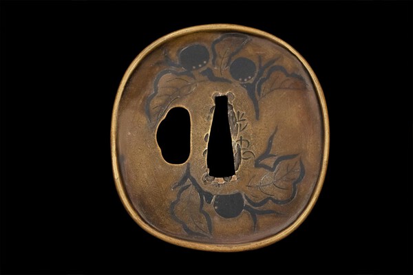

CSM101 Posted April 5, 2019 Report Posted April 5, 2019 This goes more off topic than expected. But I hope Grev and all the others will forgive me. Dear George, You are a lucky man! Because you had the chance to make some wonderful photos from the Umetada Misutada tsuba: http://www.japaneseswordbooksandtsuba.com/store/books/b1014-kokusai-tosogu-kai-15th-international-convention-2019 I only had the chance for snapshots. Like the photographer in the photo. 5 shots, 4 blurrish. And if you have no chance to control the light you must go a different way. That means retouching. Just the major steps... Uwe G. Quote
vajo Posted April 5, 2019 Report Posted April 5, 2019 Great shots Uwe, as allways. I like your photography very much. Quote
rkg Posted April 5, 2019 Report Posted April 5, 2019 Uwe, I didn't get to shoot the pieces out of Europe for the catalog. Best, rkg (Richard George) EDIT: IMHO you got a pretty good shot of the Mitsutada piece :-). Not sure whose color is right-er (diatribe on color management, metamerism, etc omitted), but the both may be because of lighting/exposure differences (another diatribe about exposure for fittings omitted). When I shoot stuff like this at an event where I care, I'll usually throw down a colorchecker/white balance card in the same light and get a couple of shots of them there to help with color management, though often you can do "good enough" if somebody was kind enough to put something white by the piece to use.FWIW, I'm reluctant to mention this since its kind of a philosophical thing, but I would suggest the following observations for you to consider on your edits of the image. In the case of this piece, I feel that removing the spectral highlights removes some information that I personally want to see. First, you lose some shape information. Second, you lose the feeling of how "shiny" the piece is. Also FWIW, I used to go to great lengths to remove all spectral highlights through very careful lighting (that often compromised detail, made surface colors "milky", etc), HDR imaging, etc, but eventually realized that going too far makes the pieces look different than they do in hand and/or you lose some of the "feeling" of the piece. Since you typically only get an image or two to try and get across to a viewer what the piece is, it seems to boil down to what visual clues to leave and what to give up on to show something else. I guess my "style" is to try and make the viewer have the same reaction to the image of the piece that they do to the piece in hand. On 4/5/2019 at 1:03 PM, CSM101 said: This goes more off topic than expected. But I hope Grev and all the others will forgive me. Dear George, You are a lucky man! Because you had the chance to make some wonderful photos from the Umetada Misutada tsuba: http://www.japaneseswordbooksandtsuba.com/store/books/b1014-kokusai-tosogu-kai-15th-international-convention-2019 I only had the chance for snapshots. Like the photographer in the photo. 5 shots, 4 blurrish. And if you have no chance to control the light you must go a different way. That means retouching. Just the major steps... Uwe G. Quote
