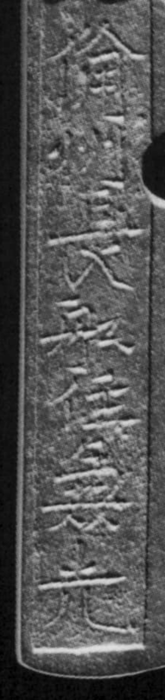

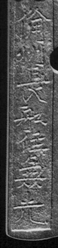

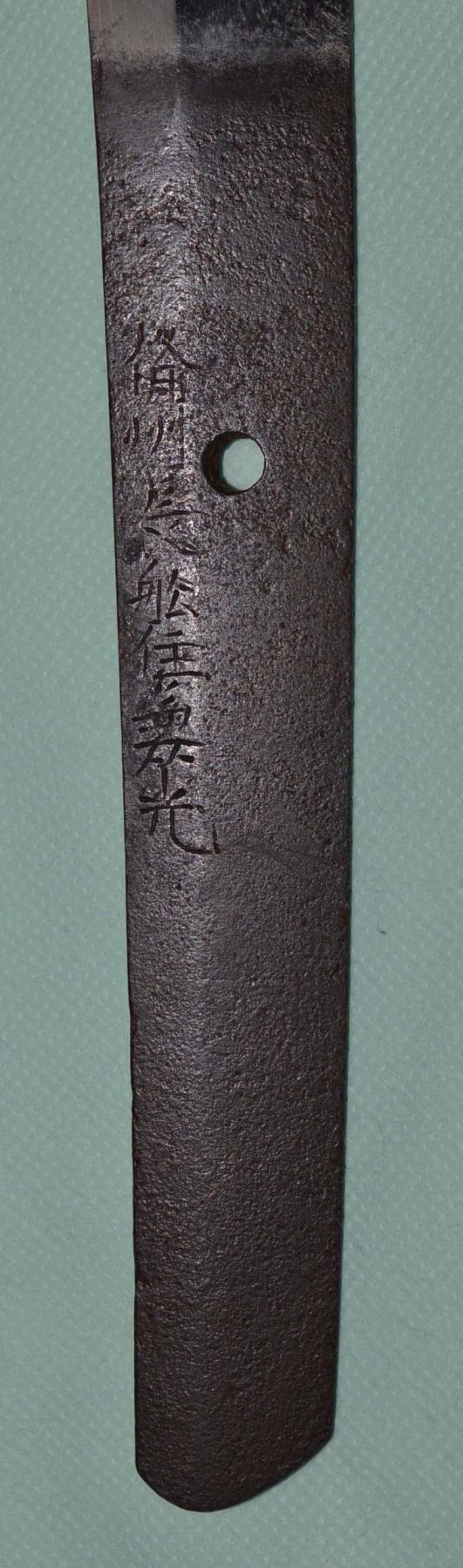

I recently purchased this sword and trying to pinpoint the exact smith or finding examples of his work over the internet.
Any help or opinion would be greatly apreciated.
tachi mei: Bishu Osafune Kanemitsu
Date : 1335 February
nagasa 69.7 cm
NBTHK TOKUBETSU KICHYO paper
I attached a picture with similar mei, this sword is called BUNKAZAI FUKUSHIMA O-KANEMITSU "The Ten Students"
Best regards
Peter G.

Do you have any picture of similar picture, can we believe this is the smith who forged my blade:

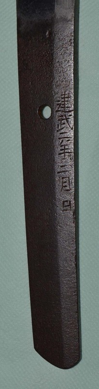

It has old paper and not repapered, the reason why it was left like this decades ago is unknown, but still I believe the NBTHK paper is trustworthy (or can they mistaken?)
The tang has been pictured with strong flash but has deep color patination,  no extended corrosion and ware like often seen, that's true, but looks like a very well preseved untouched blade which was kept safe from the elements, and thickness is pretty close to original :
motohaba 10mm
sakihaba  6mm

The nakago looks younger than early 1300s to me.

Kanemitsu produced one of the best hada in Bizen and in general. Yours has many rough patches.
The nakago jiri is different from what one would expect from this master.
And now - onto the mei. Look at the difference and lack of certainty in some of the strokes on yours. Look at how some are deep and others shallower on your nakago. The calligraphy is messed up. Then look at two genuine TokuJu mei I have attached below and compare.

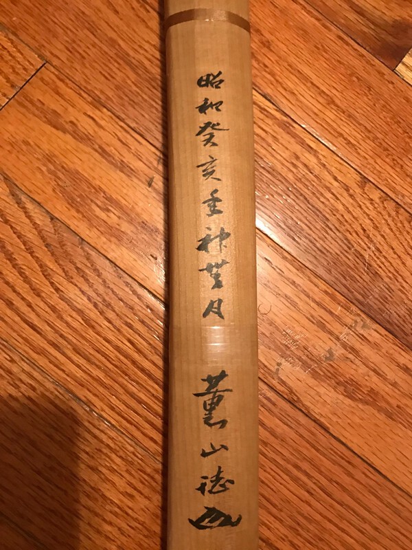

I’m curious about the sayagaki. If it’s legitimate that complicates things (sake sayagaki, anyone?).
Seems more likely to be a forgery or perhaps a legitimate shirasaya that someone paired with this blade.
Here’s a photo of the bottom of my Honma Junji sayagaki, written in 1983. I see some not insignificant differences, but would love for others with more experienced eyes to weigh in.

The sayagaki looks ok to me. The signatures are close enough to not make me suspicious.
The calligraphy looks OK to me too.
The one on Michael's has the word 神無月 (October), and the one on Peter's has the word 水無月 (June) which allows us to compare the writing pretty well. From my layman's point of view, this also looks OK to me.
Another possibility -  the kanji on the nakago looks dodgy enough to me to indicate possibly "sum wun" has put a mei on a blade that was mumei when the sayagaki was written???

In response to Steve M above: I know only the most basic of Japanese but to me the calligraphy is not close. The kanji are probably properly written by a native speaker but the rest.....
