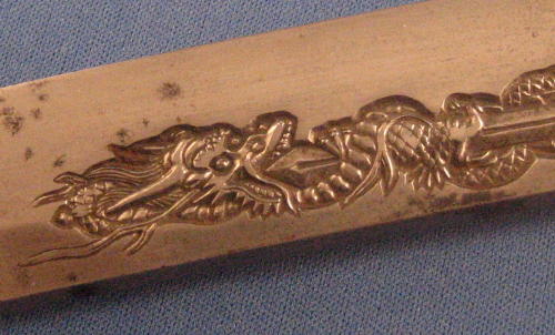

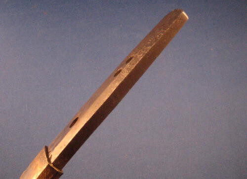

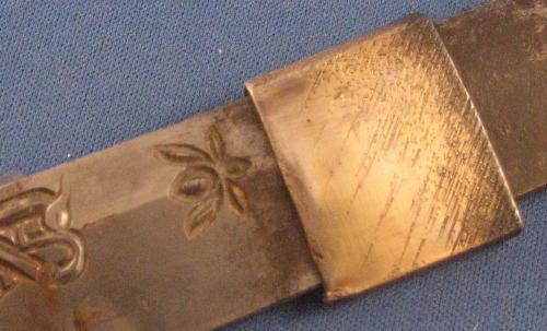

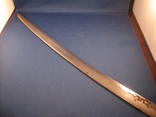

huntershooter Posted July 26, 2008 Report Posted July 26, 2008 The blade is shortened (suriage). The horimono was done prior to the shortening as evidenced by a portion of the horimono now being located on the nakago/under the habaki and the location of mei on nakago/additional mekugi ana. Your photos don't show anything of the jigane/hada or hamon, may be from the lack of polish. I have no idea on approx. value. Quote
Fritz Posted July 26, 2008 Author Report Posted July 26, 2008 Thanks Todd, I've been trying to get a picture of the temper line but have yet to accomplish it, tough one to photgraph, it's there just light like you said probably lack of polish maybe. I'll try tommorrow out side in the sunlight. Fritz Quote
Bugyotsuji Posted July 26, 2008 Report Posted July 26, 2008 三æ¡é•·å‰ä½œ "Sanjo Nagayoshi Saku" Does it say æ”¿ç”·ä¹ on the reverse? Had to turn my computer upside down to stare at that. That's what it seems to be saying, until someone has a better suggestion. Quote
Nobody Posted July 26, 2008 Report Posted July 26, 2008 Does it say æ”¿ç”·ä¹ on the reverse? The mei on the reverse looks 政晃 (Masaaki?) to me. Quote
Bugyotsuji Posted July 26, 2008 Report Posted July 26, 2008 Does it say æ”¿ç”·ä¹ on the reverse? The mei on the reverse looks 政晃 (Masaaki?) to me. Yes, that's good, and it makes sense too! Quote

Guest reinhard Posted July 26, 2008 Report Posted July 26, 2008 The patina on the nakago peeled off in flakes, especially along ridges. Not good. Reminds me of sabitsuke-nakago (chemically aged tang). reinhard Quote
Grey Doffin Posted July 27, 2008 Report Posted July 27, 2008 No idea why Masaaki would be signed on the other side. If it were the carver it would say something about carving. Too bad it has been shortened; pity to see the carving under the habaki instead of where it belongs. Sometimes shortening that doesn't make sense can be a sign of a retempered blade. The shortening would be done to erase/cover a mark (mizukage) made at the original machi by the retempering process. Retemper would also explain the flaking nakago (fire scale?) and hamon that's difficult to photograph. I'm not saying I think the sword is retempered but it is always a possibility. Any case, without having the blade in hand it won't be possible to say much about value. There's just too much we can't tell from photos. Hope this helps. Grey Quote

Brian Posted July 27, 2008 Report Posted July 27, 2008 Fritz, That is a good question, and I'm afraid is one that might never be answered. Probably not the horimono carver, and without further info, you can't be certain. Sometimes there were collaborations between makers, but nothing to verify this either. I saw the other thread, and the guy that suggested the horimono carver, would be guessing, as usually that would be stated on the nakago. There are a few possibilities, but nothing can be said for sure unless you know how to go back in time Even the horimono could be original or done later, no way of knowing for sure. I would suggest getting a window polished and someone to look at it in hand to count out retempering, and see what the blade looks like in polish. It seems maybe worth a polish. Wish I had more militaria to offer as a possible gamble in trade. WW2 FS knives? ZF4 Scope?.... :lol: Brian Quote

Darcy Posted July 30, 2008 Report Posted July 30, 2008 Signature on the opposite side... - could be joint work - could be horimono maker - could be the person who did the suriage - could be the owner Probably varying likelihood. Gotta find him and check the dates. I'm leaning towards the guy who did the suriage. Quote
Grey Doffin Posted July 30, 2008 Report Posted July 30, 2008 Fritz, Can you tell us the length of the cutting edge, from the tip to the notch at the back in a straight line? The current length might tell us something about the condition. Grey Quote
Fritz Posted July 30, 2008 Author Report Posted July 30, 2008 Hi Grey, The cutting edge length is 20.5" and the total length from the tip to the end of the tang is 27.5". Some of the engraving is under the habaki(I think thats the right term) I'd say maybe 10% or less of it is as you can see in the one picture. Hope this helps, and thanks for the help . Fritz Quote
Grey Doffin Posted July 30, 2008 Report Posted July 30, 2008 Hi Fritz, It looks to me like the sword has been shortened about 2", and that it was originally a 22.5" wakizashi. I can't think of a good reason why anyone would do that to a good piece. If it were originally a short katana and someone wanted a wakizashi it could make sense. During the Edo period only Samurai were allowed to carry a katana (length of edge at 24" or greater). It could be that a merchant owned a katana and had it shortened to be street legal. But why make a long wakizashi into a slightly less long wakizashi, especially if you partially hide the horimono by doing so? This is a red flag for me; unexplainable shortening can be a sign of retempering (done to disguise evidence of the retemper). I don't think you want to try for polish and paper unless you have very good information that it makes sense. Can anyone else think why this sword would have been shortened, if not to hide mizukage? I'd be interested to hear what you think. Grey Quote

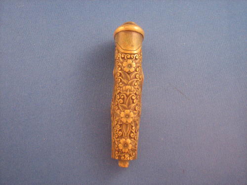

Ted Tenold Posted July 31, 2008 Report Posted July 31, 2008 The nakago is a bit stubby even for having been shortened. These shorter blades with stubby nakagos are seen coming out of Kyu-Guntos, and other "D" guard styles of the late 19th and early 20th century designs. I almost wonder if the shortening didn't come sometime *after* a machi okuri which may have perhaps aleviated earlier damage , i.e. broken hamachi, running kizu, etc. It's also interesting to note that the habaki has no notch in it (called a "kimekomi" if my memory serves correct) but rather the leading edges butt up directly to the ha and mune machis without the inset of common design. This type of habaki sets it further back into the nakago, which may also have been a design choice for a short handled military koshirae of some kind, thus also preserving more of the nakago and mei. Notice the nakago ends right at the last character of "saku" (or: (wo) tsukuru). I don't see these features as coincidental. It would've been too easy to just lop it off where ever necessary as seen frequently on other blades. Is there any koshirae with this sword? The horimono will make this blade a more expensive polish than a comparable blade without horimono. Very very time consuming and intricate work, thus pricier. Yet another reason to have the sword examined prior to deciding whether to polish it or not. Quote

Fritz Posted July 31, 2008 Author Report Posted July 31, 2008 Hey Ted, No problem . Here are the mounts that were on it when I purchased it, I'm pretty sure the tsuba and smaller brass ring are WW2 because they are numbered but the handle and backstrap I think are earlier, not 100%, I do know the backstrap looks just very similar to a police parade sword, but this is what was on it when I got it. Fritz Quote
