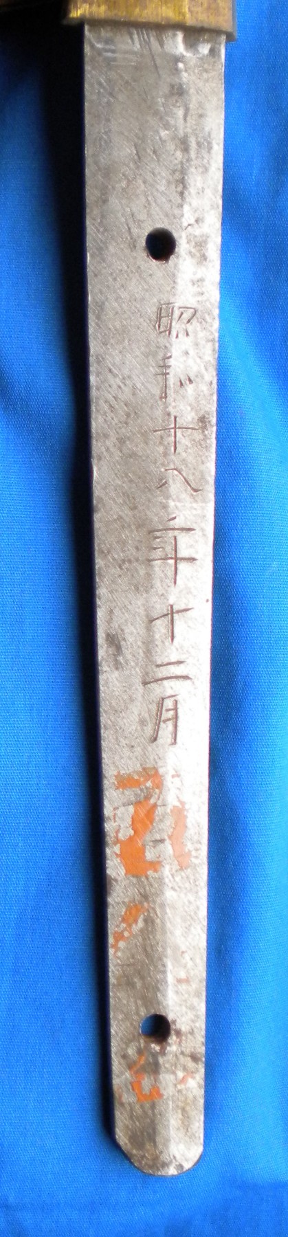

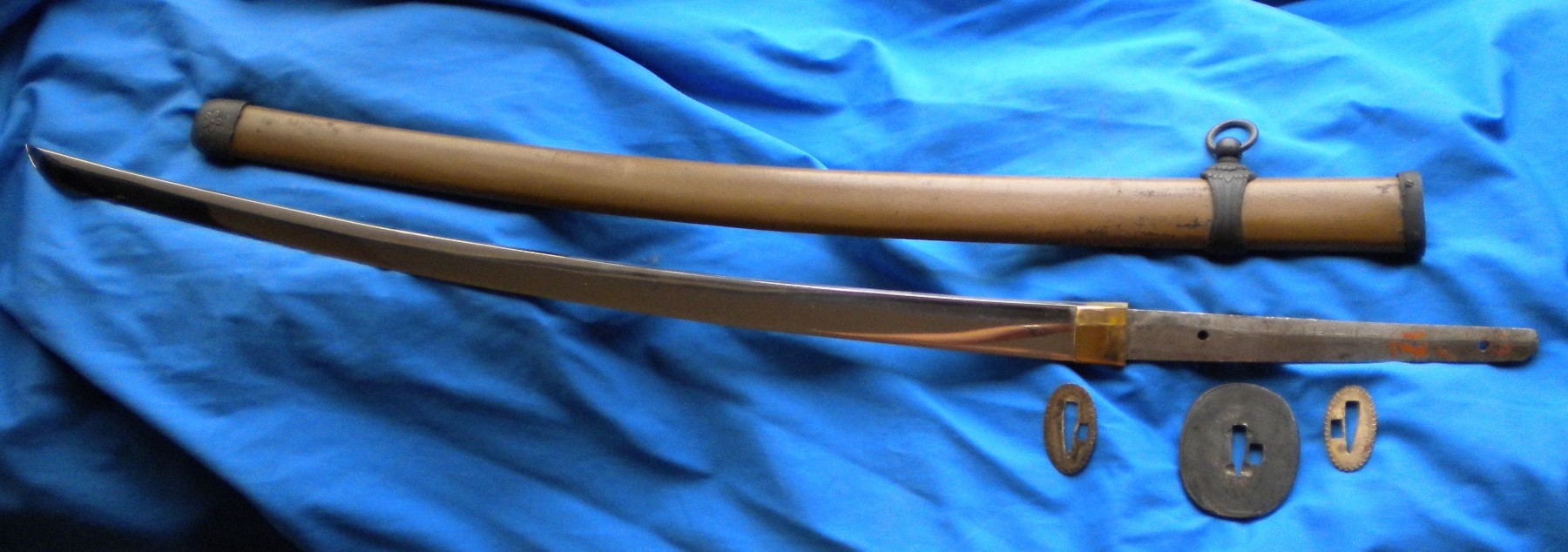

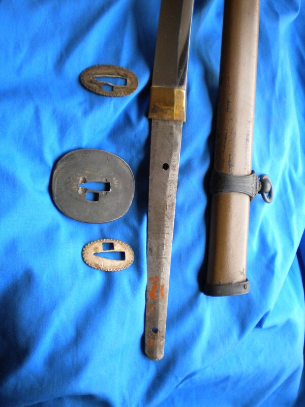

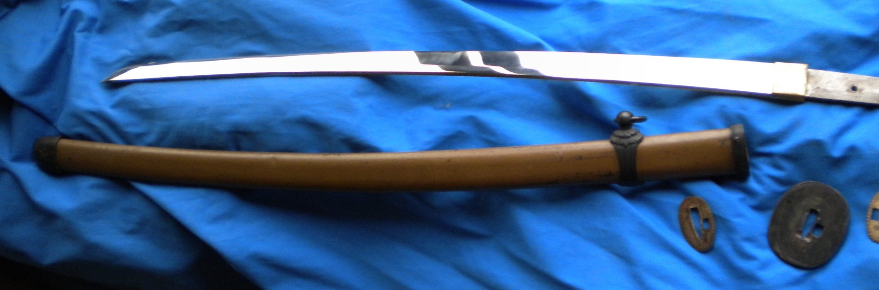

Eds Posted August 9, 2022 Report Posted August 9, 2022 I know that this is an old thread however I thought that I would add to it. One of my swords is a older brother to the above mentioned item. I ran your thread while researching a translation that Thomas provided. 兼定 = Kanesada. 昭和十八年十二月 = 1943 December There isn't a Hamon that I can see. The Habaki is on pretty solid and there looks like scratch marks where a previous owner tried to pry it off. I can't get it off and I haven't tried very hard. The Tsuba and Seppas look similar to the above mentioned sword. Has a similar Tsuka however it's missing the silk wrap, ray skin and Menuki(s). No Arsenal stamp that I can see on the tang or markings on the spine that I can discern. I've posted pictures of both sides. I took the pictures today. With all that said, I could use advice on where to get the Tsuka rewrapped. In the USA would be nice VR Ed 1 Quote
