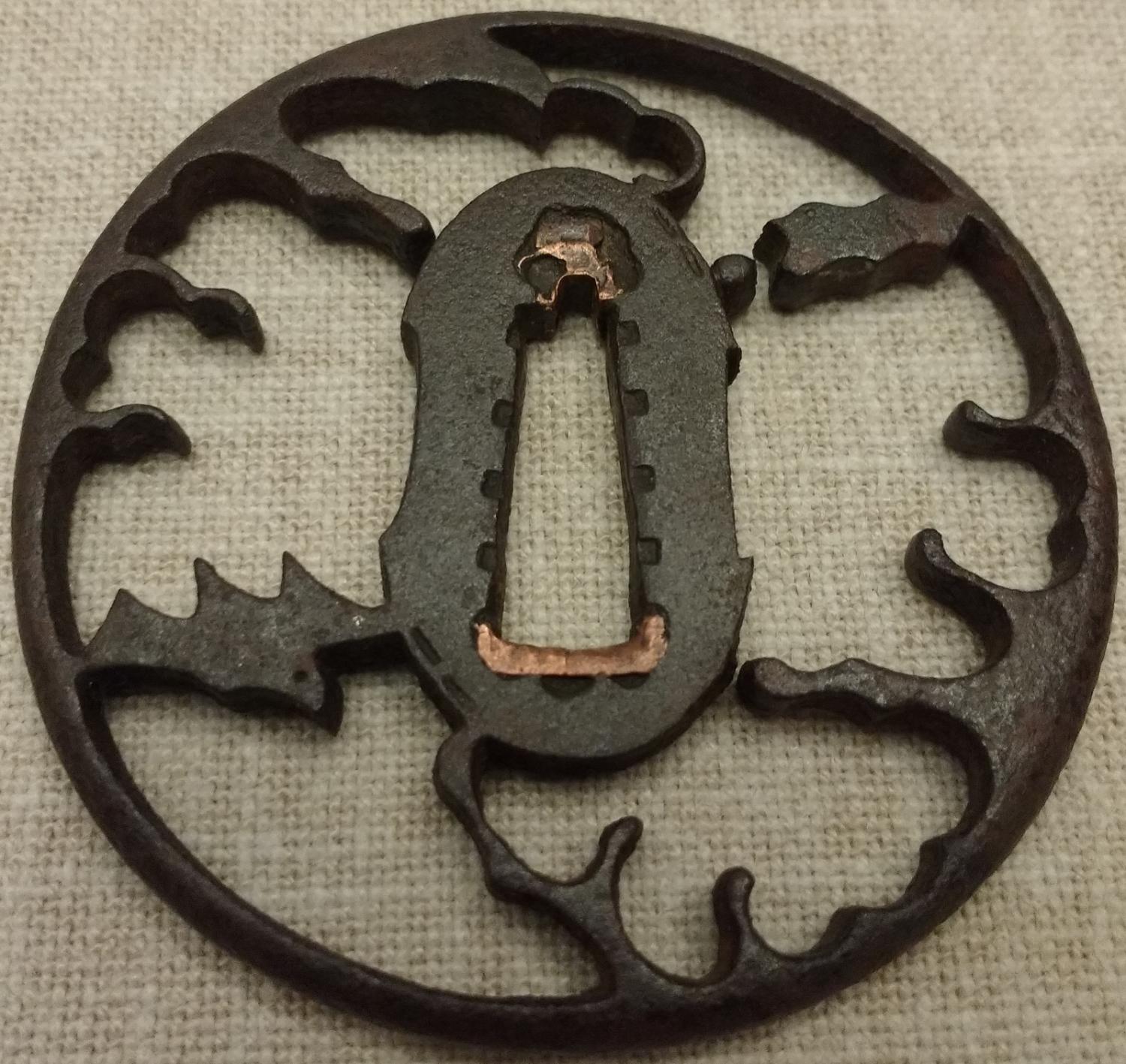

I'm looking for informations for my last months cheap eBay purchases (30€ for the cheaper to 50€):
#1: iron openwork with clouds and birds, w:69mm * h:69mm * thickness:5.6mm, 61g (tagane mei?)

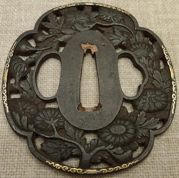

#2: iron with flowers w:65mm * h:70mm * thickness:3.5mm, 75g

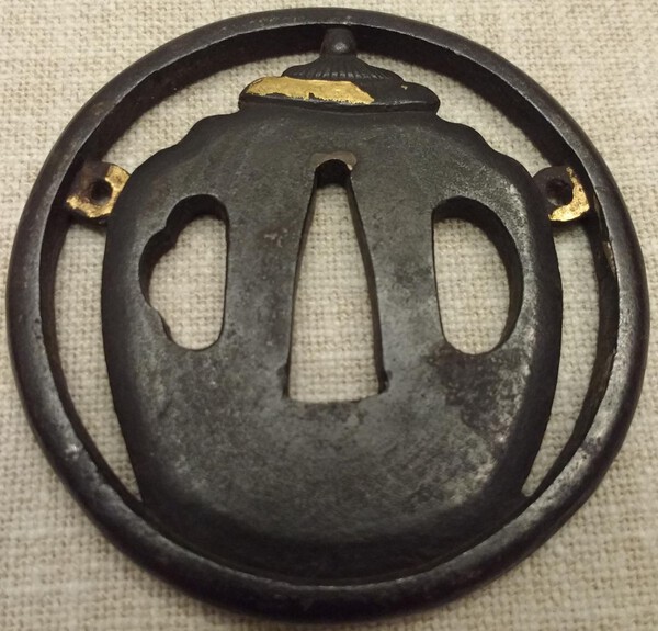

#3: iron with sake or water jar, gold inlayed tsuba mei (chinese caracters?) w: 67mm * h:67mm * thickness:5.5mm, 95g

Tsuba #1: later Akasaka Style (sorry, can’t see any birds - maybe waves…?)
Tsuba #2: Bushu or Choshu style
Tsuba #3: reminds me of an Ono design, maybe gilded later, signature (if it is one) NAO XXX  looks strange

I see a stylized bird on first picture, at 4 oclock, there is a little punched hole for the eye, it's just my visual interpretation :-)
Tsuba #1 looks like modern Japanese design to me. Likely a modern tsuba done in a late Akasaka School style. Doesn’t look structural sound in my opinion. Tsuba #2 looks like the late Edo Period work of the Itō School in Bushū Province (Edo). Tsuba #3 no sure about it. The workmanship looks late Shōami but never seen them sign like that. Can only read a partial signature as ‘NaoX’.
#1: Yes, now I've recognized the bird. Chidori and waves as mentioned is a traditional motif. Any signs of layer technique used on this?
#3: Here's the Ono-piece for comparision I had in mind:
However, gold nunome wasn't used by Ono smiths. Certainly I agree with David that Shoami is an option, too.
At least I don't think the inscription is a signature made by the maker (even for stylized chinese letters crudly done) but an aesthetic addition.

@David: I also thought that tsuba #2 was Ito school
@Florian: I don't see any layer technique, (i will take a closer look)
