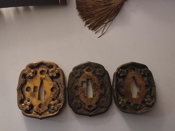

Yukihiro Posted March 7, 2019 Report Posted March 7, 2019 Hello to all, This is a gunto tsuba I found last week in Paris - it looks pretty non standard to me, so I would like to have your opinion. Regards, Didier 1 Quote
vajo Posted March 7, 2019 Report Posted March 7, 2019 Platte is cut, holes are drilled and not boars eye. Not legit for me. Its fake. Quote
Yukihiro Posted March 7, 2019 Author Report Posted March 7, 2019 Thank you for your reply, Chris. At any rate, I wasn't able to find one with the same sakura on it anywhere on the Internet. It does look old, though, and not artificially aged, so who knows... Quote

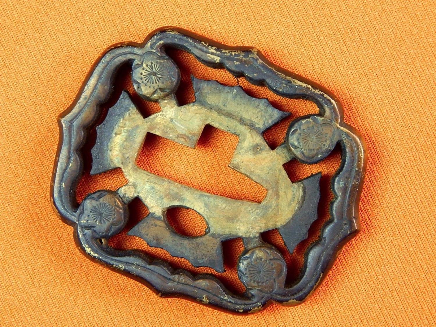

PNSSHOGUN Posted March 7, 2019 Report Posted March 7, 2019 An original with holes instead of boars eye: 2 Quote
Yukihiro Posted March 7, 2019 Author Report Posted March 7, 2019 Same principle, indeed, with holes drilled through the plaque. The sakura on mine are different, with their central crown, from any I have seen so far. Were there "non regulation" gunto tsuba made by smaller workshops or could this one, if it is legit, be a very early example ? Quote
PNSSHOGUN Posted March 7, 2019 Report Posted March 7, 2019 Mine is from a fairly early sword. Beyond that I haven't seen any others. 2 Quote
Yukihiro Posted March 7, 2019 Author Report Posted March 7, 2019 Well, I think I have found a partial answer to my question : they are not sakura, but ume flowers, like on this Edo tsuba. 1 Quote
TETSUGENDO Posted March 7, 2019 Report Posted March 7, 2019 Although there are exceptions in nature, the convention in Japanese art is that Sakura blossoms have notched petals and Prunus blossom petals are rounded. Cheers, -S- 2 Quote
Yukihiro Posted March 7, 2019 Author Report Posted March 7, 2019 Alright, so they are sakura after all! Thank you for putting things right 1 Quote

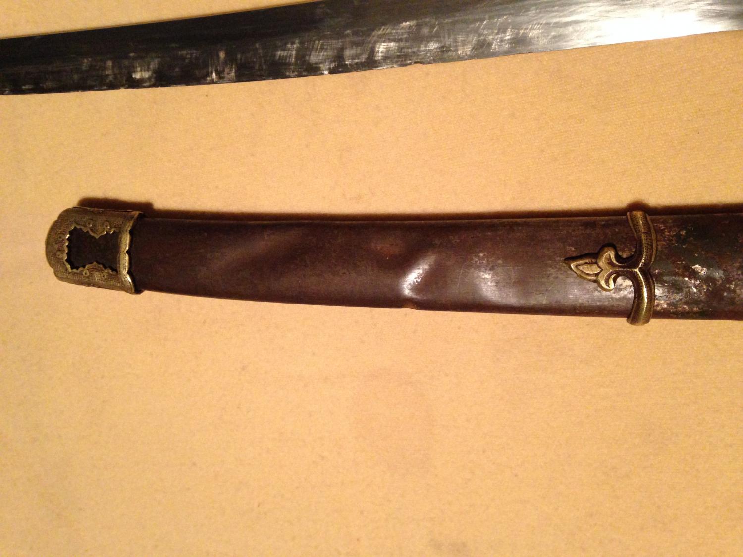

vajo Posted March 7, 2019 Report Posted March 7, 2019 Come on gentleman, this is not a genuine Japanese tsuba. Look at this fittings.. http://www.swordforum.com/vb4/showthread.php?115225-Help-with-WWII-gunto-with-serial-number-quot-0-quot Quote

Yukihiro Posted March 7, 2019 Author Report Posted March 7, 2019 Unfortunately, I cannot see the fittings you are referring to, Chris. I had noticed that the holes were somewhat off centre. The blossoms on the tsuba don't look particularly crude to me. Quote

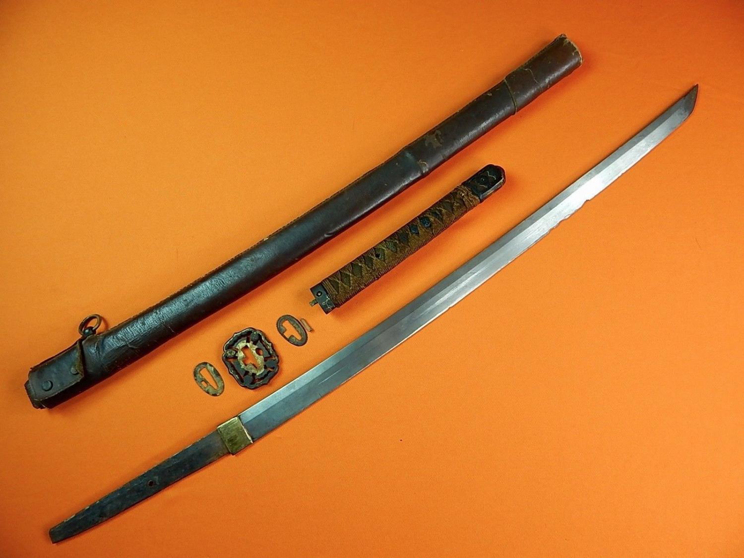

BANGBANGSAN Posted March 7, 2019 Report Posted March 7, 2019 Didier Maybe it's from one of those"Emergency made"or "Territory made "sword.It doesn't look true Japanese made one to me. Here is some photos from a emergency made sword ,it has"應”(emergency)mark on the balde.The pierced tsuba looks very crude,not exactly same as the one you post ,but kinda close. 2 Quote
TETSUGENDO Posted March 7, 2019 Report Posted March 7, 2019 Didier, here is a picture of the tsuba Chris had in his link. -S- 1 Quote

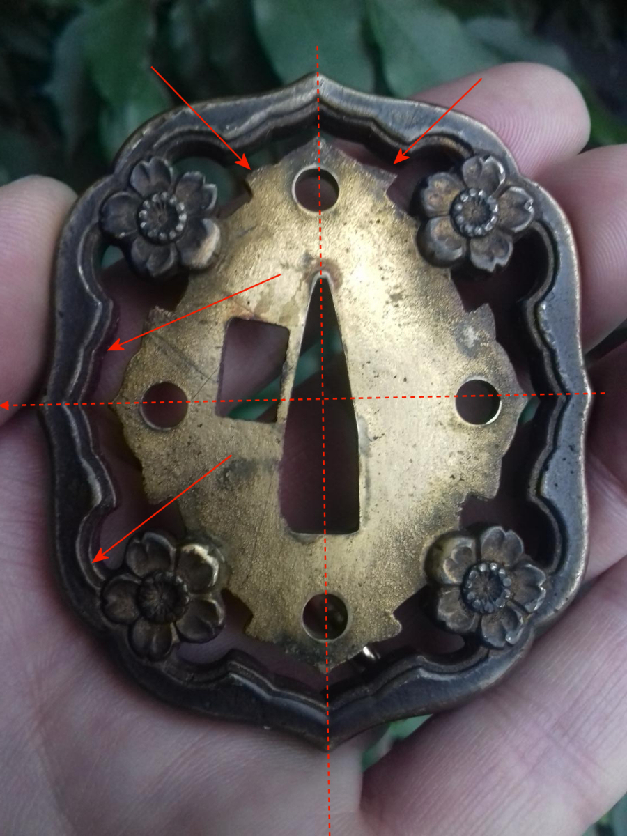

Bruce Pennington Posted March 7, 2019 Report Posted March 7, 2019 On 3/7/2019 at 12:57 PM, TETSUGENDO said: 20190307_074124.jpgDidier, here is a picture of the tsuba Chris had in his link. -S- Ha! I saw this and thought "Wow, someone has a tsuba just like mine!" Then I realized it IS mine! First, Didier, I believe the flower on your tsuba is the Chinese plum of WWII. Which COULD mean these fittings were made for an officer in the Chinese military working for or with the Japanese. I have little to no knowledge of that aspect of the war, but I do know that such things were done. I've posted a picture of the plum blossom. John, it's interesting to see your tsuba with the rounded holes. The fine artwork of the cherry blossoms appear legit to me, as opposed to the poor imitation on mine. Yours looks legit, while mine looks like a really bad fake. In fact, the rest of the fittings on the "gunto" mine is on are equally horrific. The blade is lighter weight than normal and it's hamon looks like it was applied with a steel wire spinning brush. The nakago looks like it was melted with acid to hide the fact that it wasn't a Japanese blade. John's tsuba reminds me of the fact that fakers copy something that was original. So now I'm more convinced that mine was a fake rather than just a REALLY badly crafted gunto. 2 Quote
Yukihiro Posted March 7, 2019 Author Report Posted March 7, 2019 Thanks to everybody for the input I find the ones that have been posted on here rather cruder than mine, but I'll search the Net for other examples (whether fake or genuine) to get to the bottom of it. 1 Quote
