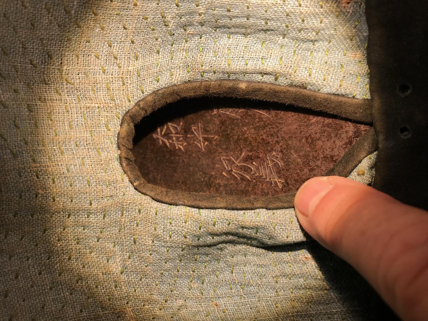

Japan2112 Posted March 5, 2019 Report Posted March 5, 2019 Hello all, I purchased my first ever helmet this week, and it is something of a mystery. It is an 8 plate adoka nari bashi that has been re lacquered over some time ago into a 62 plate suji bashi (fascimile), It has what seems like several musket ball dents in the underlying iron plate ( one square in front, maybe a "proof" firing) and four others on both sides and in the rear. The ukebari has a nicely lined opening to view the signature and to enter a flashlight and finger into to examine the inside. Not very rusty inside. The ball strikes are very impressive. I'd read where old helmets were sometimes refurbished during Edo period into more fashionable items and that the adoka nari was not popular in Edo times. This has a signature on the inside rear plate.It reads - "Yamato (no) Kami Fujiwara Iyeyoshi". I am hoping it is a Muromachi item that saw battle and was re purposed later in its life. Any guidance as to who was this smith or my next step into this hachi's research is greatly appreciated. I am sharing five images that I hope will be helpful. Thanks in advance for any and all comments. Mark 1 Quote
uwe Posted March 5, 2019 Report Posted March 5, 2019 Hi Mark, nice and interesting hachi, probably from the Momoyama period. Although, strictly spoken, not an ”Akoda-nari”. It looks like a work from the Haruta school of armorers. Unfortunately I couldn’t find an Ieyoshi signed with Yamato, in a hurry. How is the yoshi character chiseled? Off for work..... Quote
IanB Posted March 5, 2019 Report Posted March 5, 2019 Mark, An interesting helmet bowl, which as you say, has been 'modernised' during the Edo period to look like a 62 plate helmet. You say it is signed by an Ieyoshi. As Uwe has said, much depends on the kanji used for -yoshi which is not visible in your photographs. If the kanji is 吉, Sasama (in Shin Katchushi Meikan) lists two smiths. One is a Saotome Ieyoshi which this isn't, and a Sagami Myochin smith, who made multiplate helmets rather like derived akoda nari bachi with gilded fukurin over the suji and igaki around the base of the bowl, which again this isn't. A far better bet is a certain 家義 whose real name was Shimizu Chubei who may have been a professional armourer, or who may have been a samurai who made helmets as a hobby. He is recorded as having made an 8 plate helmet in collaboration with the swordsmith Iga no Kami Kinmichi who worked in the early Edo period. The latter was the person who arranged honorary titles for swordsmiths and since this helmet maker had a title this seems significant. On the whole armour makers were regarded as the lowest of the low since they handled leather, but helmet making was considered OK and quite a few bushi indulged in the hobby. The fact that the helmet is tameshi is also about right as contrary to popular opinion, modern research suggests the gun only became a significant weapon during the Korean invasions. And by the way, the shape is goshozan - that is a 'high sided bowl that is raised at the rear'. Ian Bottomley 4 Quote

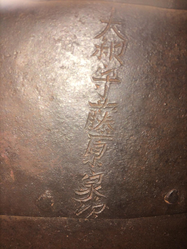

Japan2112 Posted March 5, 2019 Author Report Posted March 5, 2019 this is great discussion...much appreciated so far. I have attached a few more pics of the mei. Please note the nice condition of the iron plate and mei itself. Is this something that is left alone when being modernized? Thanks all again. Quote
uwe Posted March 5, 2019 Report Posted March 5, 2019 Uwe, You have proved me wrong about honorary titles on armour. As I said something I have never seen before so I stand corrected. The old rule is never say never when it comes to armour. I wonder if Ietsugu was related to Ieyoshi. I have a helmet signed Ietsugu but by the Soshu Myochin guy. Ian Bottomley Ian my dear friend! It wasn´t my intension to "proof you wrong". I merely found, it is an interesting piece of armor and worth a closer look (i.e. some more research)! Well, now we know the complete mei. Unfortunately, I just learned, that it doesn´t necessarily make it any easier... Eager to hear your opinion..... PS: I miss our "wine tastings" now and then... Quote
IanB Posted March 5, 2019 Report Posted March 5, 2019 Mark, Since Ieyoshi used the kanji ..義. I think we can definitely rule out the Haruta as Sasama lists only Shimizu Chubei as using 家義, although It is worth saying that the list of armourers recorded by him and anyone else is far from complete. The kanji Ie... was not especially popular among the Haruta, only two smiths being listed as using it, One never actually signed Haruta but was claimed to be an Haruta in their genealogy, the other seems to have been linked to Ikeda Terumasa and seems to have mainly produced tsuba. Two other points about your helmet I think are interesting: Firstly not all, but a large proportion of the helmets by professional armourers have what are known as shiten no byo - anachronistic protruding rivets that originally protected leather ties for the helmet cord knotted through holes below the rivets. This helmet does not have them. Secondly, when the lacquering process was carried out, the suji or ribs would be applied using hemp cord stuck in place that was subsequently given all the undercoats and finishing lacquer layers. In this case note that the person doing the lacquering has not bothered to level the tameshi dent but run the cord into the depression. Ian Bottomley 1 Quote

uwe Posted March 6, 2019 Report Posted March 6, 2019 I’m afraid I can’t agree Ian. Based on the mei (here the obvious connection to Haruta Ietsugu) and the shape of the hachi, I’m almost convinced, that we can attribute this helmet to an Haruta blacksmith! It’s by no means the first smith not recorded in the Meikan. We noticed several gaps, not covered by Sasama.....as you mentioned! Luc, looks promising. Do you also have a picture from the kabuto? .....Hmmm, mei seems “Bishū ju Yamato Ietsugu”. In this case Owari! 2 Quote

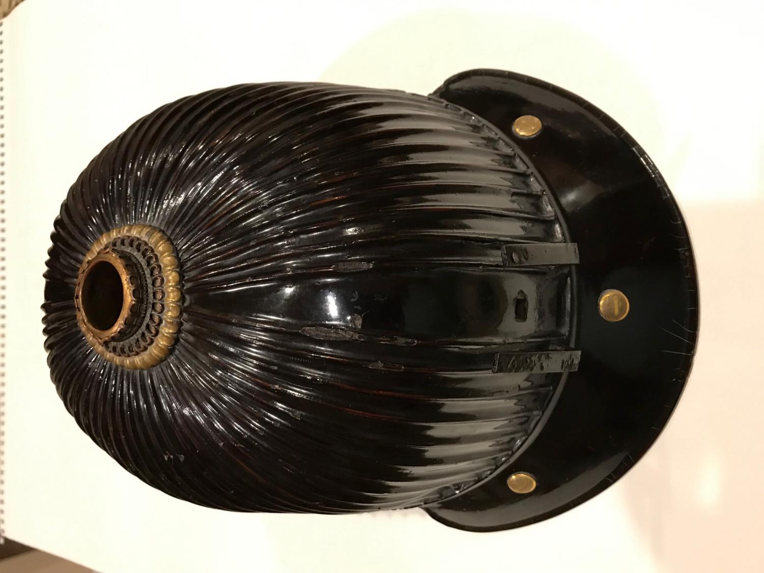

Luc T Posted March 6, 2019 Report Posted March 6, 2019 Uwe, it is a zunari, with some remarcable Haruta looking kirigane. 1 Quote
Luc T Posted March 6, 2019 Report Posted March 6, 2019 Btw, I have the impression that only 30% of the early Haruta smiths are recorded. They are worth a serious study, but he surviving written sources are scarce. On the other hand, they are relatively easy to place in time, due to their evolution from the muromachi till mid edo period. 1 Quote
Luc T Posted March 6, 2019 Report Posted March 6, 2019 here it is Uwe. Maybe we can ask a picture on Markus? 1 Quote

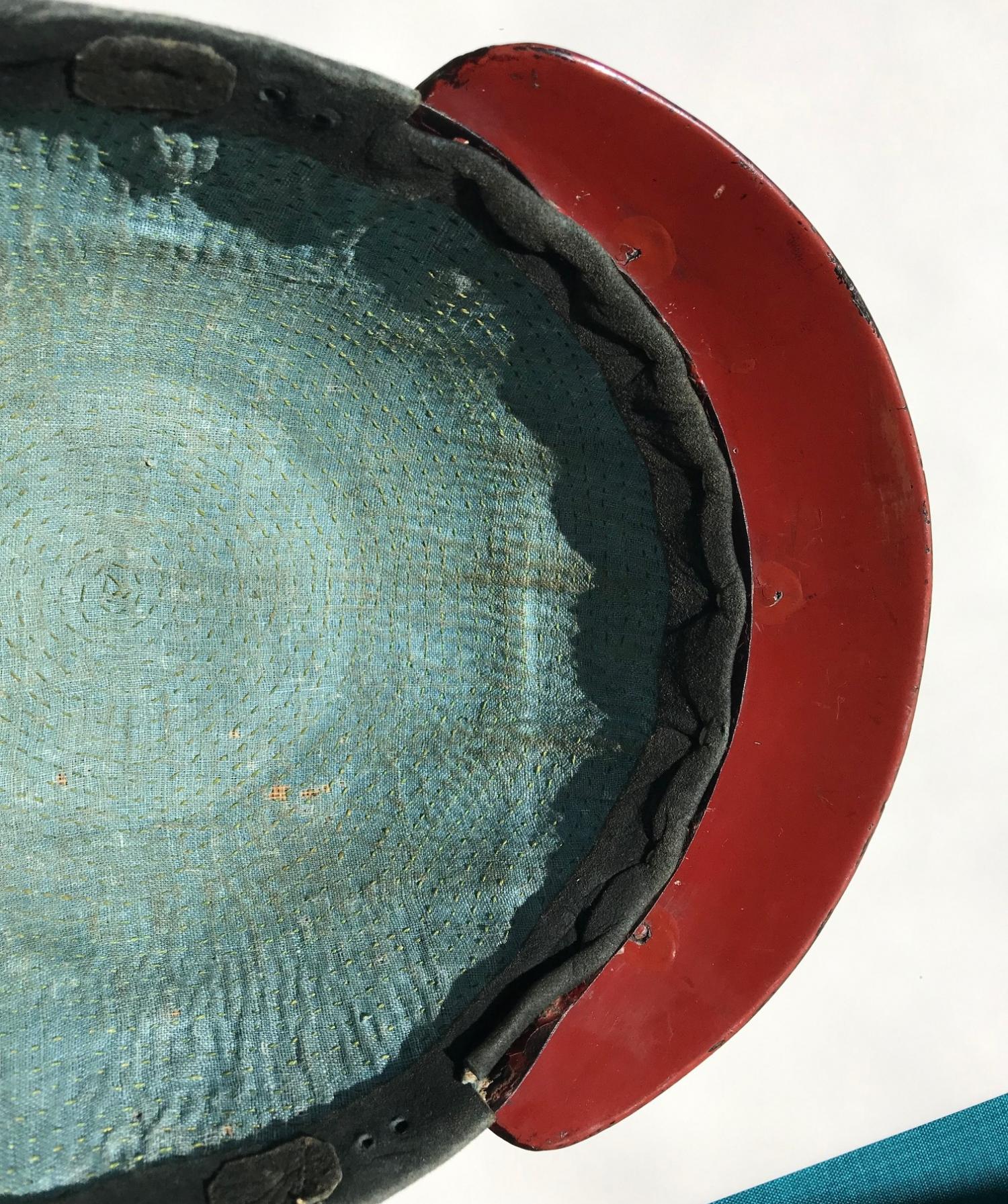

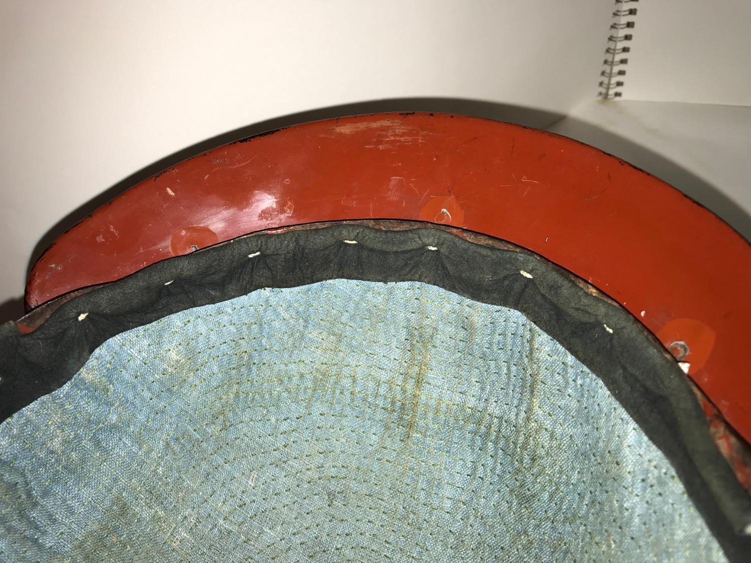

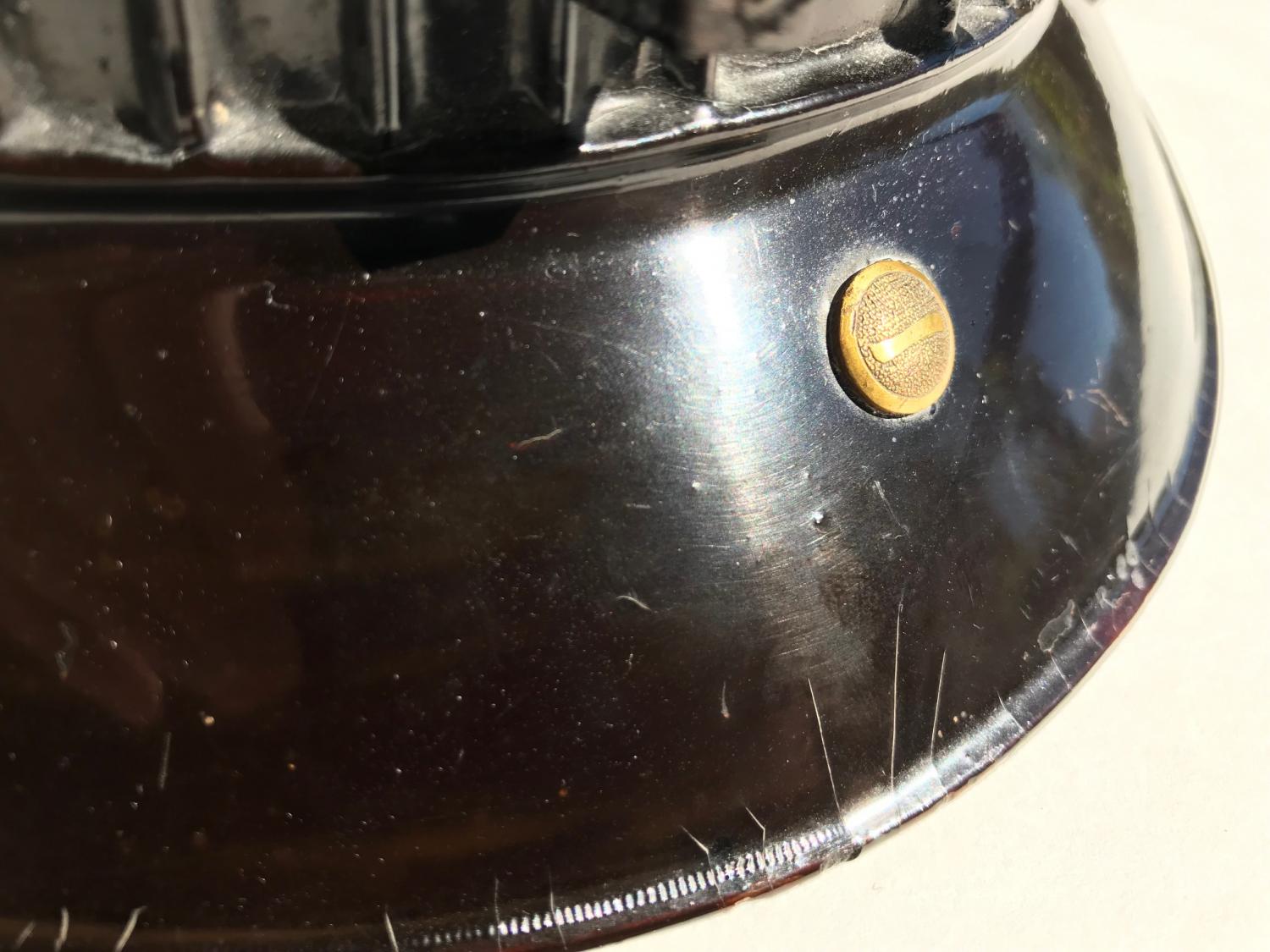

Japan2112 Posted March 6, 2019 Author Report Posted March 6, 2019 Luc, As requested, here are some images of the mabizashi. I hope they're helpful. To all, Thank you for all your pointers concerning this helmet. I have learned a lot, somethings probably not found in books. Anyways, I have been pointed in the direction of Sasama Katchushi Meikan, a Jo I rated armorer. (not sure what that means). As I don't have any armor references being new to this study, what would be your thoughts about this katchushi? Mark Quote
Luc T Posted March 6, 2019 Report Posted March 6, 2019 thanks Mark. I was hoping that the original mabezashi was reused. Unfortunately, it is later version. Sasama's Katchushi Meikan is a bit outdated at some points. A jo I rated armorer is seen as a very good smith. (chu i = good, jojo I = exellent, Sai jo I = superb) Quote
