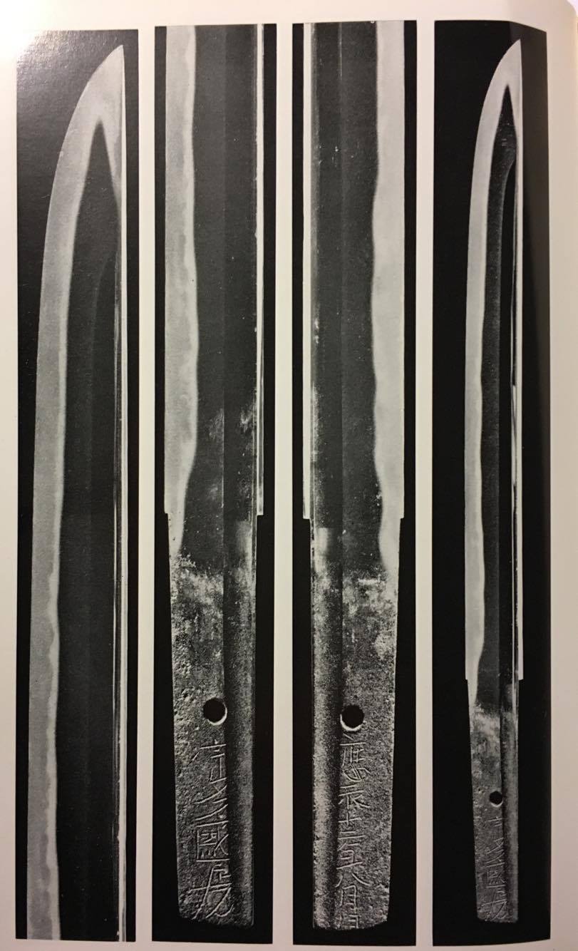

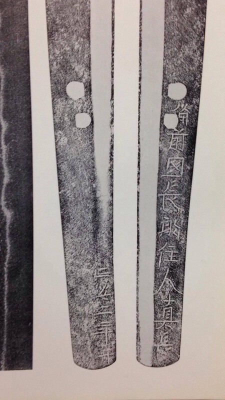

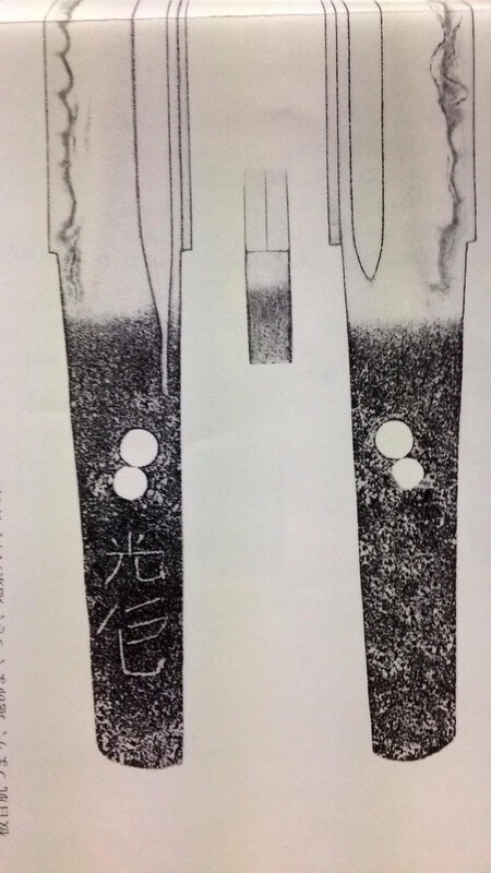

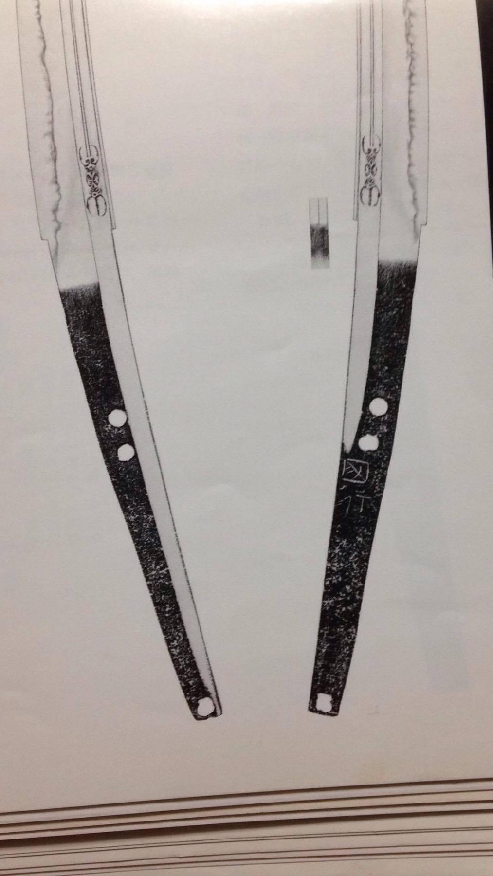

Marius Posted March 8, 2019 Report Posted March 8, 2019 A few pics to give you food for thought... Quote
