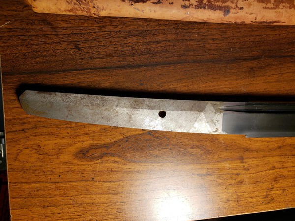

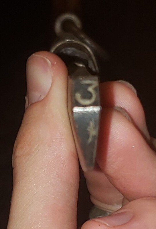

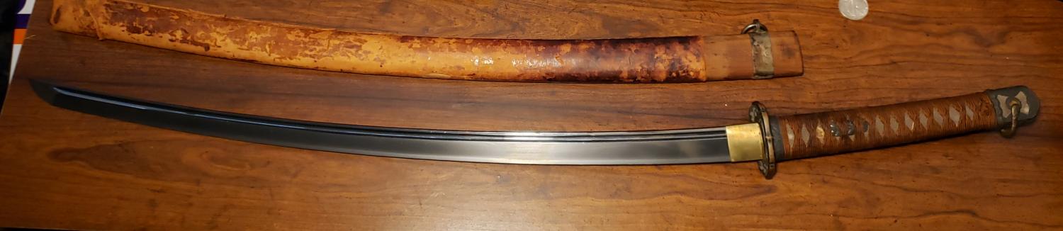

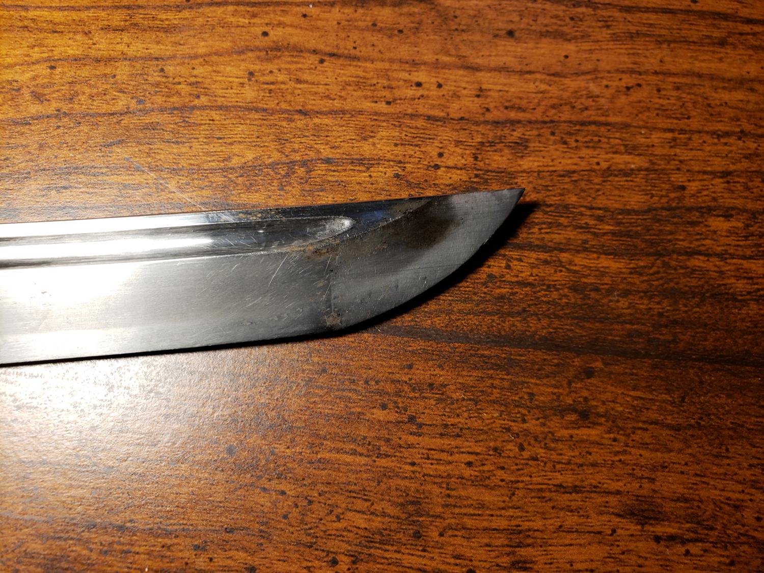

Rei Sinn Posted February 25, 2019 Report Posted February 25, 2019 Hi everyone! I'm new to this forum and I wanted to share with you a Mumei I just picked up here at the gun show. Funny when I found it at the show the blade was lathered in cosmoline. No one knew quite to make of it, such as making it out to be a NCO type 95 or something unauthentic. I'm curious if anyone here has any particular thoughts on its origin, swordsmith, etc. I believe it's a Showa era Gendai with a beautiful Kesho Yasuri patterned Nakago. The back of the mune has a couple stamps, but otherwise no Seki, no Showa or Star stamps that I could find. The Nagasa measures 26 1/2 inches and the whole blade measures around 34 inches. The hamon appears to be Suguha with some form of ashi. There is very fine hada, probably itame I would guess. The "type 95 blood groove" was in my opinion hand carved Bohi in Ryo-Chiri. 3 Quote
SAS Posted February 25, 2019 Report Posted February 25, 2019 It looks to be a well made sword; I am surprised that it is mumei. 2 Quote

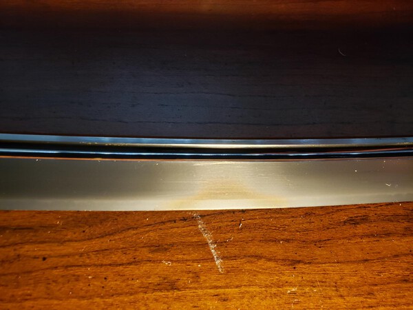

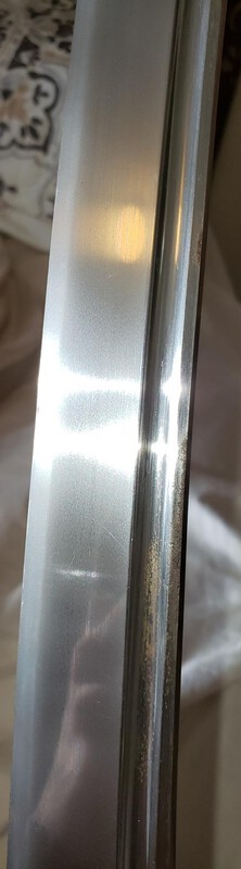

Tom Darling Posted February 25, 2019 Report Posted February 25, 2019 ? Unless I am going blind, I don't see a hamon.nor hada. Yasuri makes it look interesting. Good luck. Tom D.. Quote

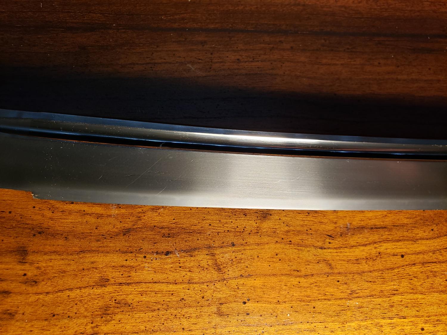

Rei Sinn Posted February 25, 2019 Author Report Posted February 25, 2019 Yes the hamon is very subtle! Quote
Dave R Posted February 25, 2019 Report Posted February 25, 2019 My guess would be a hand forged factory made blade, and one of the higher end Showato. I really do not see a nihonto of the WW2 era going unsigned, especially with custom order fullers. If the nakago had shown some signs of age, I would have gone for it being a mumei Shin-Shinto 1 Quote
TheGermanBastard Posted February 25, 2019 Report Posted February 25, 2019 It is a WWII Gendaito. Could be by Nagamaitsu . I have had several Mumei Nagamitsus and also other Mumei Gendaitos. Looks like someone working in the Bizen tradition. A sword of good quality. A pitty it is not signed. 1 Quote

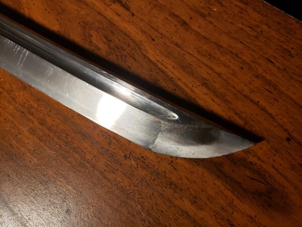

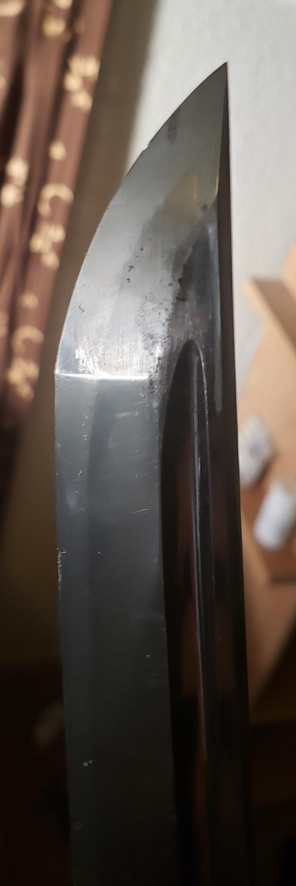

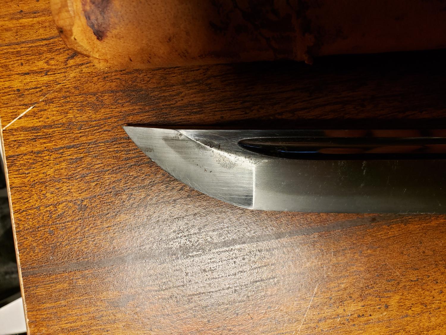

Tom Darling Posted February 26, 2019 Report Posted February 26, 2019 Kissaki is another conundrum, just doesn't look sincere. Maybe if you could shoot on an angle it put me in a favorable mindset. Thank you. Tom D.. Quote
Rei Sinn Posted February 26, 2019 Author Report Posted February 26, 2019 Hope this helps. The site wont let me reply anymore.. I'll post more kissaki pics tomorrow morning. Quote
TheGermanBastard Posted February 26, 2019 Report Posted February 26, 2019 On 2/26/2019 at 12:31 AM, Tom Darling said: Kissaki is another conundrum, just doesn't look sincere. Maybe if you could shoot on an angle it put me in a favorable mindset. Thank you. Tom D.. it is not about mind but iron Quote

Rei Sinn Posted February 26, 2019 Author Report Posted February 26, 2019 Other side of kissaki. 1 Quote

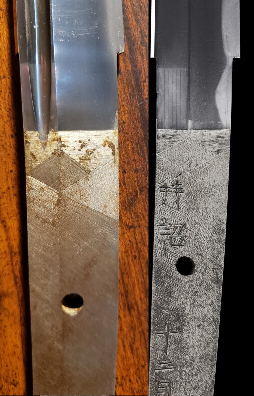

vajo Posted February 26, 2019 Report Posted February 26, 2019 The yasurime is very unique. Looks like a variant of kesho yasuri. The nakago is kata yamagata. I search today in all books for a smith with that nakago and yasurime and found nothing. Maybe i had to less books I bet there is only a few smiths in Meji/ Showa who do this in this way. A very fine sword. 2 Quote
Stephen Posted February 26, 2019 Report Posted February 26, 2019 war time polish, a art polish would really bring out workmanship 2 Quote
vajo Posted February 26, 2019 Report Posted February 26, 2019 I had a feeling this could be a Hizen smith. Chu suguha with some ko-choji elements and a lot of ashi. I collect wartime gendaito and this is the finest yasurime i ever seen. I think it is older than 1933. 1 Quote
Rei Sinn Posted February 26, 2019 Author Report Posted February 26, 2019 Chris- I sincerely thank you very much for all the time and input. It's truly a fascinating piece I couldn't leave behind! The only reference prior to everyone's input was John slough and Kokan Nagayama. Interestingly, nagayama's Connoisseur's book has a matching illustrated example of the yasuri with regards to the corresponding era, but gendaito are a whole different animal. 1 Quote

Tom Darling Posted February 26, 2019 Report Posted February 26, 2019 last picture of boshi was definitive, you "have got" a winner. Nice gendai, It will be interesting if you get origami? Also, I appreciate getting the stinger. Tom D. 1 Quote

Navymate Posted February 28, 2019 Report Posted February 28, 2019 Rei- Your blade has similarities in the yasurime to some of the Emura blades I have seen, such as this one: https://www.aoijapan.net/katana-emura-saku-3/ Here is a link to a search on sold items from AOI Art for “Emura” in case the link doesn’t work for you: https://www.aoijapan.net/?s=Emura&x=0&y=0 I am no expert, just merely suggesting the similarities since no one has mentioned Emura yet. I hope this helps you with your research. Good luck! Mark 2 Quote
vajo Posted February 28, 2019 Report Posted February 28, 2019 That was what i searched for. Emura yasurime. Thanks for finding it out. 1 Quote
