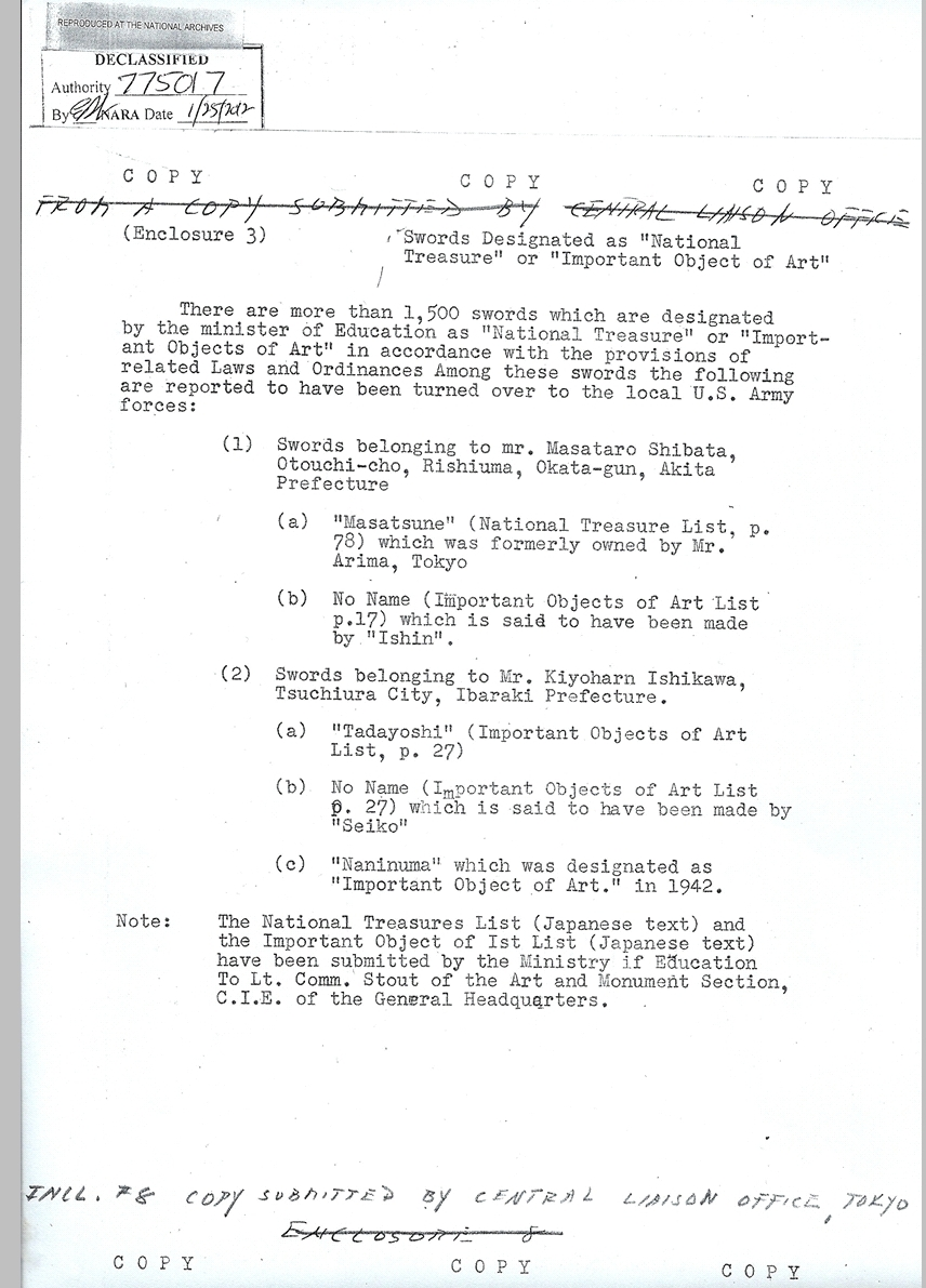

Here's some food for thought. A document from right after the war, discussing swords classified as national treasures and works of art. Paragraph 1.b. lists a sword without signature but said to be made by a guy named "Isshin"! Ha!
So, a Japanese official actually listed the Koa Isshin as an important work of art!? Hmmmmm.
This comes from the Articles section: http://www.militaria.co.za/nmb/forum/57-nt-and-iao-list-and-sword-documents-by-us-gov-1945-1950/
Gotta be a spelling error for “ichi” and the Ichimonji school who only signed their swords with the number 1

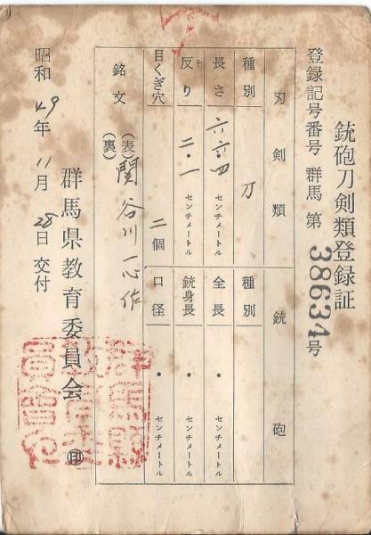

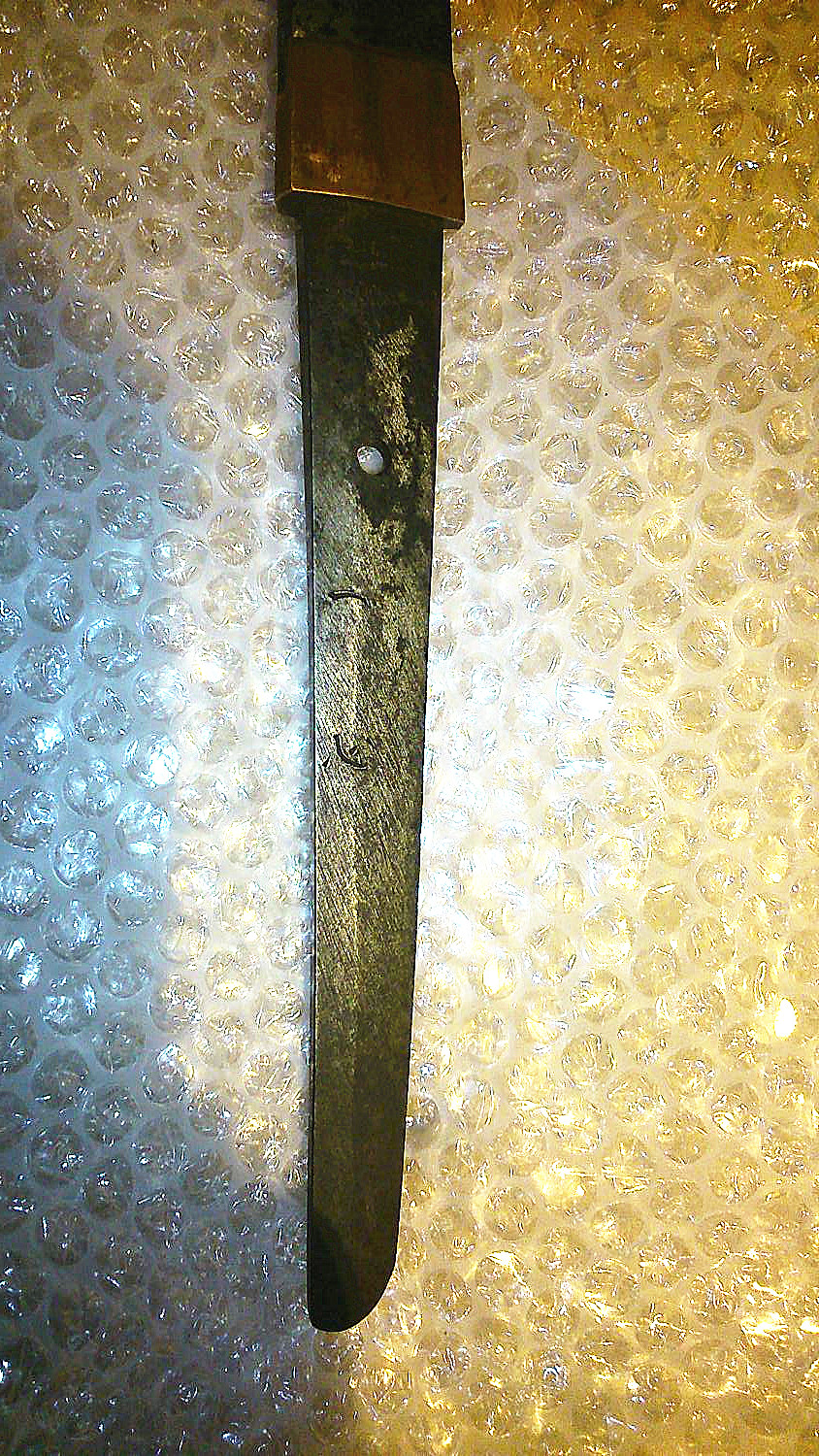

There is a Showa smith name 一心  Isshin  ,civilian name 谷川慶治 Tanigawa Yoshiharu,he is on the list of 軍刀(昭和刀)関鍛治刀匠名簿232名(  232 rigistered Seki Smith name book who make Gunto/Showa To).
He use signature:一心,谷川一心 and 関谷川一心作。
http://www.touken-kasugado.com/faq_2.html
Rats, what a killjoy! Couldn’t even enjoy my fantasy for 24 hours.
More like 5 hours :laughing: .Anyway,I think KOA ISSIN MANTETSU swords are great Gunto,many Japanese officers like them.Many collectors love KOA ISSIN swords as well,and I am one of them.
And I seriously doubt any sword made during WW2, Koa Isshin or just the other guy, Isshin, would be considered an important work of art, not at that time anyway!
