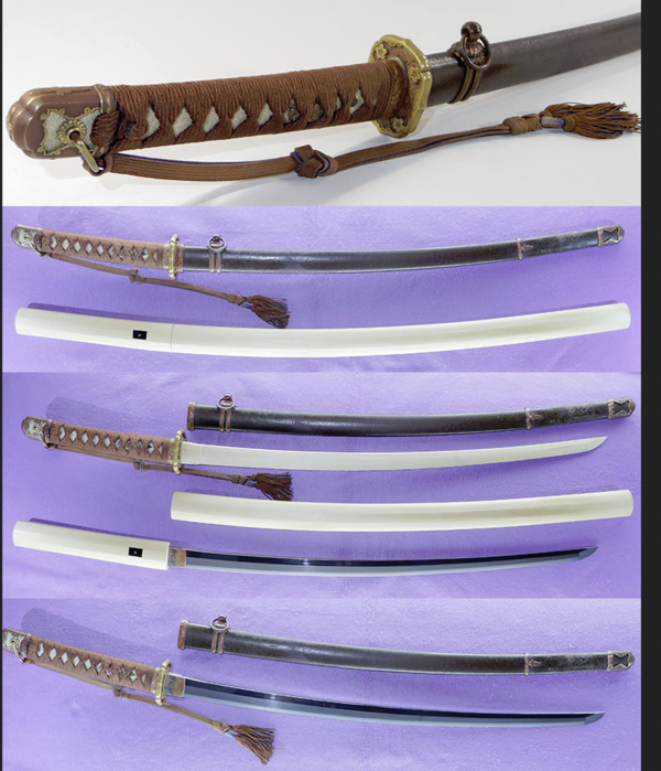

PNSSHOGUN Posted February 24, 2019 Report Posted February 24, 2019 Link here: http://www.Japanese-sword-katana.jp/katana/1910-1040.htm Seems quite extraordinary that a Koa Isshin cleared NTHK Shinsa, is anyone aware if NTHK specifically is putting original WWII swords in a separate certification section? 2 Quote
IJASWORDS Posted February 24, 2019 Report Posted February 24, 2019 Is it possible that it is just authenticating the mei, and not the manufacturing process. Quote
PNSSHOGUN Posted February 24, 2019 Author Report Posted February 24, 2019 It does have Kanteisho, comparable to NBTHK Hozon and goes further than a simple confirmation of Mei. 1 Quote
vajo Posted February 24, 2019 Report Posted February 24, 2019 The NTHK does not give Kanteisho to non nihonto. It seems that Koa Isshin has status of Nihonto now. And i missed two times to buy a Koa Isshin cheap 4 Quote
Bruce Pennington Posted February 24, 2019 Report Posted February 24, 2019 John, Thank you for this blade link! Stories have been told of papered Mantetsu, but this is the first proof we've seen posted, AND it's a blade I didn't have in the study! Over time, some auction pages/picture links become inactive, so I'm posting the full pics here for preservation: 2 Quote
Bruce Pennington Posted February 24, 2019 Report Posted February 24, 2019 Thanks to Guy, the rating given on this is: 鑑定書 Kanteisho Which is: “This is the second highest and more commonly seen origami certificate from the NTHK-NPO that offers a generous amount of information on the sword’s characteristics. The certificate will be issued for swords of considerable quality in which the mei (signature) is authentic OR in the case that if sword is mumei (unsigned), the judges will offer their opinion on who the smith or school was that forged the blade.” Quote

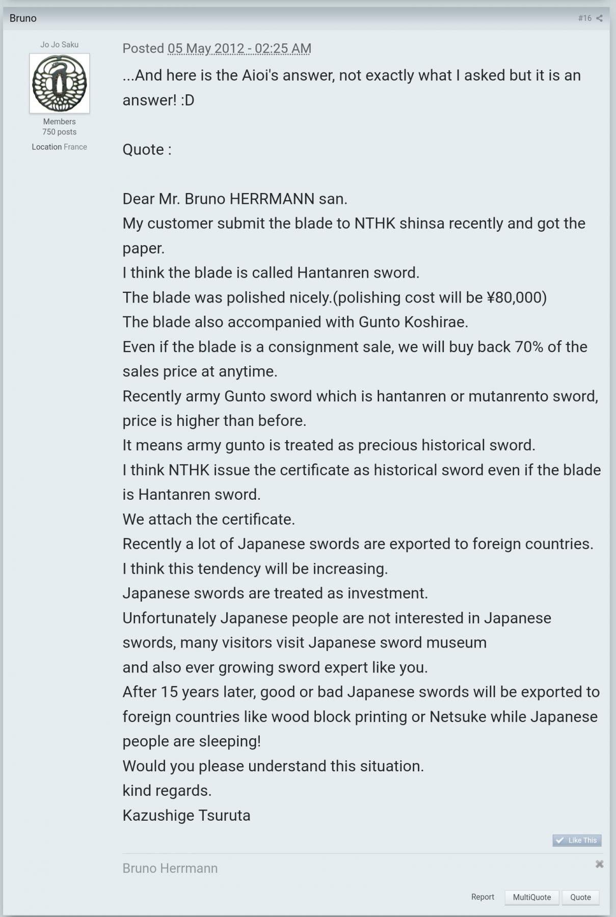

Bruce Pennington Posted April 29, 2019 Report Posted April 29, 2019 Found a similiar discussion from 2012: http://www.militaria.co.za/nmb/topic/9526-showato-in-Japan/Someone actually got a response for the team: It verifies what we've learned here, that they are papering for "historical" reasons. He lamented the fact that "Japan sleeps" while these precious items are being shipped out of country to collectors abroad. 1 Quote

16k Posted April 29, 2019 Report Posted April 29, 2019 Okay, so I read this thread, the other one (unfortunately, the pictures are long gone) about a Showato being accorded papers and the reply by Tsuruta san associated with it. Then I reread George Trotter’s translation of Ohmura on Hontanrento. And it leaves me with a question. If the sword in question was non traditional, oil quenched, with a Showa or Seki stamp, how could it have been labeled Hontanrento? Quote
Beater Posted April 29, 2019 Report Posted April 29, 2019 On 4/29/2019 at 6:02 PM, vajo said: hontanren-to (true hammer forged swords). Traditionel made swords.No, Tsuruta San said Han not Hon. I think, as in Handachi mounts, it means partial? Han-tanren = abura yaki-ire-to. Partially forged from mill stock, some folding, differentially hardened using oil. Does have a hamon although it is nowhere near as active as a water-quenched sword, but lacks hada. Quote
vajo Posted April 30, 2019 Report Posted April 30, 2019 Hantanren-to are oil hardned not traditionel forged swords. Why should get such a sword papers? 2 Quote
Beater Posted April 30, 2019 Report Posted April 30, 2019 On 4/30/2019 at 5:06 AM, vajo said: Hantanren-to are oil hardned not traditionel forged swords. Why should get such a sword papers?Please see my earlier post on this thread above. I am equally dumbfounded. The answer to your question however, appears to be, because they, whilst having no art value, have "historical value and are documentation of the war and conflicts from the past." Using that explanation, I can see no reason why any gunto cannot now also get papers. This is a very odd decision indeed. Personally, unlike those who detected the Japanese were lamenting, I suspect they are in fact rubbing their hands together as this will stimulate business, at a depressed time for Nihonto, and fuel the inexplicable rise in interest (and prices) for certain gunto. I hope Mr Bowen, who elicited the response from the authorities, will seek further explanations in how this "historical" criteria will be applied in the future, to other types of non-traditional gunto. 2 Quote
