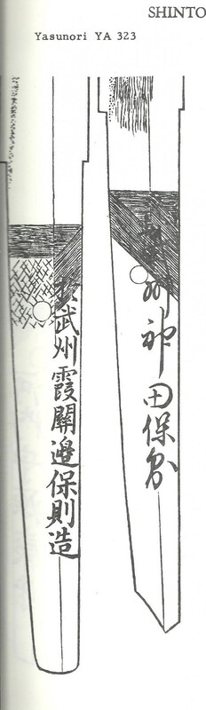

HI guys, Need some help with a hard one
Thanks to Bazza and Steve M for their thoughts {Second character on the rhs is SHUU, the first being the province?. there is horimono on the blade so one of the lhs characters I think reads HORI DO SAKU ("also made the carving").}
but not much on the rest at this point :-?  thoughts ?
I put mine as a spoiler. Somebody who wants to take a crack should give it a go without looking at my spoiler because once you see a kanji character as a certain character, it is hard to stop seeing it that way.
武州神田囗囗造之
干時雕同作
Bushū Kanda ?? kore wo tsukuru
Toki hori dōsaku
I am unsure of the ones in red. I am fairly sure of the province and location. The final line also seems pretty clear. I am interested in the idiosyncracies, but that is a topic for when we have figured out who made/signed this.
His first name kanji is certainly "Yasu"
To me his name looks like Bushu Kanda Yasunori tsukuru kore  1764-1781  Hawley (1981) YAS 690.
I haven't looked the lead up, just thought I'd mention it so you can have a bit of fun following it up...hope I'm not leading you astray.

Hi Ian,That's what I was looking for :beer:  not much chance its gimei but wonted to get something to compare it too :thumbsup: don't have the book so if one of the members has it and can post or PM with the page that would be great. Again thanks guys :clap:
Here's the oshi from Shinto Benji Oshigata p.143. Amazing that a 250 year old book can be so helpful. BTW YA 323 is in Hawley's old blue books 1976, the 'new' number (brown book 1981) is YAS 690.
Let us know what your research uncovers,
Regards,
Hi George, Thanks mate, you're a legend, :thumbsup: owe you a beer next time you are down this way :beer:  I will let you know what info comes up :) Now that I Know who he is :clap: Yasunori did some good quality horimono and IMHO has skill in cutting that interesting mei :thumbsup: :thumbsup:
You are most welcome Jim....certainly looks like a good potential item. Hope you uncover some good info..
