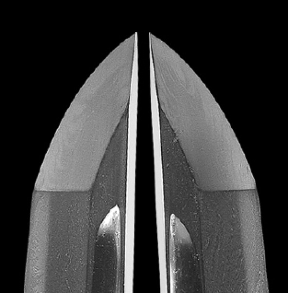

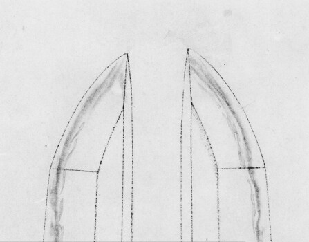

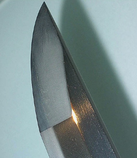

Darcy, thank you for the detailed summary. In this connection and due to Tsuruta-san's hint to check the hamon inside of the kissaki area, I like to add some pics.
Pic 1 refers to a Juyo Token Katana attributed to Yamato Kaneuji. The description says "The nie is particularly asserted in the boshi and forms flames consisting of hakikake.....and most typically exemplified by the boshi, indicating that this blade is undoubtedly a work o the Yamato school.
Pic 2 Quiz 4
Pic 3 Taima Boshi

I agree with you, Andy's Kaneuji ad Ricecracker juyo Taima shows strong Hakikake.

The example of Yamato KANEUJI you are presenting (Engl. Token Bijutsu No.18, for those who want to look it up) is a little tricky for reference. It is shortened quite much, rather atypical, with an attribution by Hon'ami Koson (not always reliable), and Dr.Homma, who wrote the comment, didn't feel perfectly comfortable:
"Among Kaneuji's signed examples we have never come across any other examples exemplifying this type of workmanship, but theoretically this attribution is quite agreeable." (a polite way to express doubts)
Yamato Shizu (referring to shodai KANEUJI while still working for the Tegai group) made his blades in a very conservative style. This becomes particularly obvious when looking at sugata, hamon and boshi, and is in accordance with Tegai-style at the end of Kamakura-period. His workmanship is far superior and quite different to the one we are trying to pin down in this funny game (for it is not proper kantei, but this could be another thread). If the blade we are trying to identify, were "Yamato Shizu", it would be the work of later followers.

it's not the Ricecracker Taima, btw, that sword has been sold formerly by Darcy.
The kissaki of pic 3 belongs to a Katana in my collection, it's attributed Taima Juyo Token.

The reference to Yamato Kaneuji pointed especially to the flame like hakikake, the ura side of Quiz 4 bears very close resemblance to that flame like hakikake.

It is the boshi of this particular blade, which is very atypical for Yamato Shizu. Not because of the hakkikake (one would expect), but because of its size (almost ichimai and completely out of proportion). Yamato Shizu boshi at its best is a small, conservative and elegant yakizume (including hakkikake). Owning both, Yamato Shizu and Taema (both Juyo Token), I'd wonder if the sword in question was attributed to one of these schools. If it is so, it would be at the lower end of their quality scale.
In fact, it looks like Dr Homma would have been more confortable with a Kanenaga attribution.

Jean,
I don't feel competent at all to classify this Yamato KANEUJI, for I have never seen it first hand, but comparing oshigata, description and photos with all I know and ever saw of Yamato SHIZU, I think I know quite well what Dr.Homma felt when appreciating this blade. There are swords, which give you an immediate impression of what they probably are and during closer examination all features continue to confirm this impression. Other swords you don't feel sure about, starting by elimination and end up with the most probable attribution without feeling perfectly comfortable in the end. It cannot be confirmed anymore, but Dr.Homma's comment at the end gives me a notion of the second kind of procedure. Nevertheless the sword must be of high quality for it ranks Juyo Token.

May be, but in most cases it says less than a good oshigata. I'm not very good (nor ambitious) at taking pictures of blades anyway. My "Yamato SHIZU" is depicted in "Juyo Token nado zufu" vol. 24. (attachment) and in Dr.Homma's "Kanto Hibi Sho" vol.I, p.475. If you insist, I will provide you with pictures, but you will probably be disappointed. In this case PM me.
This boshi shows perfectly what should be expected of Yamato SHIZU (Dr. Homma calls the whole blade an exemplary study piece for Yamato SHIZU). It is quite different from the Yamato KANEUJI for reference and the "Kantei"-sword in question. This, I think, should bring us back on the original trail (Tsuruta-san's quizz).
