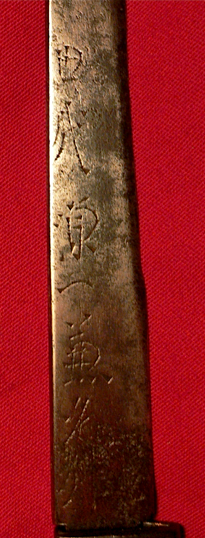

Just received a nicely mounted mumei wakizashi I purchased, and am hoping someone can find the time to translate the kogatana for me. All help, as always, is much appreciated!

At first sight and without checking books:
"Noshu Seki (no) Magoroku go dai ? ? ? Fujiwara KANEMOTO kore o saku"
Fujiwara KANEMOTO, 5th descendant of Seki (no) Magoroku, made this.
In most cases, these inscriptions on kogatana blades are merely decorative and no real signatures.
reinhard

So you are saying that it is a bit unusual that this one is signed, or that the signature shouldn't be taken seriously?
5th generation Kanemoto would place this in the 1st half of the 1600s, correct?
Noshu Seki (no) Magoroku kyu-dai sue Zenjo Fujiwara Kanemoto kore o tsukuru
濃洲関孫六 ä¹ä»£æœ« 善定藤原兼元作之
I also read the generation as 5th at first, but it seems to be 9th judging from other information.
Thank you as well, Moriyama-san.
What does this indicate about the period of manufacture? I'm assuming the kogatana blade really tells us nothing about the rest of the koshirae, as a blade from any period could be inserted into a new kozuka...unfortunately none of the other pieces are signed. It's a nice set with a sakura theme; matching kozuka, fuchi/kashira, tsuba, and menuki.
Is it common for kozuka to have ware, or is the one in mine indicative of a "tired" or poorly made blade?
As for the kogatana, Zenjo Fujiwara Kanemoto seems to have been working in the first half of 1800s.
Signatures on kogatana blades should not be taken too seriously in general. Though many famous names are found on them, most of these masters did not have the time nor the ambition to work on decorative blades like these. Drifting into speculation, I guess some of them were made by co-workers as a side-job; some of them were made by agreement by other smiths specialized on these kind of blades.
1800's seems about right for period of manufacture for this koshirae, too. A kizu in the kogatana is untypical.
It is widely accepted that the signatures on kogatana are usually symbolic, but obviously some are genuine, and I was just wondering if anyone has ever seen a kogatana (not kozuka) receive official papers to a smith?
I doubt it..which is why I expect that one will never know if a signature is genuine or not.
...so, probably not a very "good" kogatana? I really like the rest of the koshirae, though.

There are very few kogatana blades predating ShinSakuTo worth talking about. Apart from the one by KIYOMARO mentioned by Moriyama-san, there is another by KOTETSU as well (Shinto Taikan, vol.I, p.30). The vast majority however is not worth investigating any further. While the hada is usually muji-fu and the hamon very simple and pittoresque, the mei is very different from the ones found on swords. As I said, this is very speculative, but it seems unlikely, that masters like Tsuta SUKEHIRO, Inoue SHINKAI and KOTETSU (whose swords costed a fortune during their lifetime already) worked on kogatana blades personally. Nevertheless it seems possible to me, that less prominent kaji, struggling for maintenance, made kogatana blades as a side-job.
Jacques,
Just being signed, this doesn't mean they were actually made by these smiths. Tsuta SUKEHIRO is recorded to have made 1'620 swords in 25 years (5+ per month!). It is hard to imagine he spent his spare time by producing tiny, merely decorative blades.
Tyler,
This kogatana is perfectly allright. Most of them rusted away by now for obvious reasons and yours seems to be in pretty nice condition. There's not much sense in investigating any further. Just enjoy it for what it is now.
John,
Many contemporary kaji make kogatana blades as a side job. Amongst them some very well established masters. Their life settings however cannot be compared with those of smiths during Edo-period.
I wrote this because: Kogatana blades were neglected by NihonTo scholars for a reason. There's not much to say about them. Giving them a status they don't deserve and starting investigations where there's nothing to investigate, the board will soon be flooded by requests concerning the authenticity of kogatana blades and the copying industry will gladly find a new field of activity.

Going through my books, I noticed a gap between yondai Magoroku and Zenjo Fujiwara KANEMOTO (9th generation) you mentioned. There must have been 4 generations in between, which are poorly documented. Do you think it is possible, that the 5th generation KANEMOTO was named Zenjo already?

Comparing your picture with Tyler's, I realized we made the same mistake at first. Taking kyu for go was due to the angle his pictures were taken from. They should have been made full frontal like yours. Domo arigato gozaimashita.
