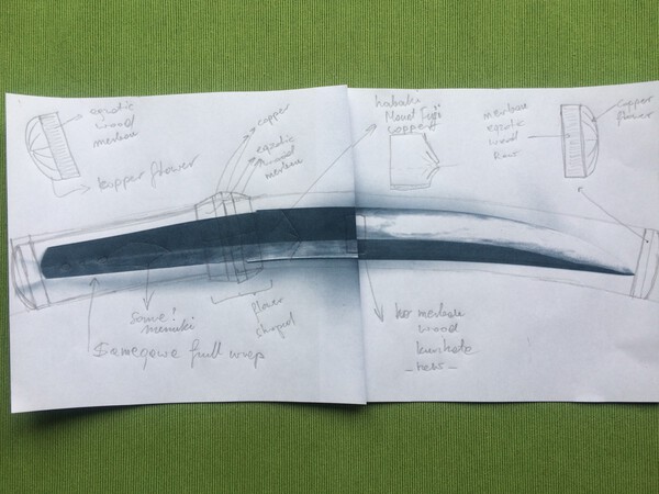

Artur DrogaMiecza Posted February 7, 2019 Report Posted February 7, 2019 I bought a blade with habaki, so I need to make everything else myself. Koshirae: I decided to make aikuchi with buffalo horn fittings with flower motif 1 Quote

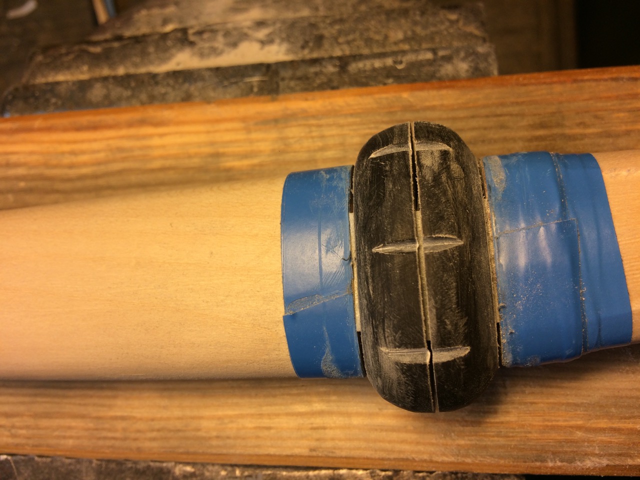

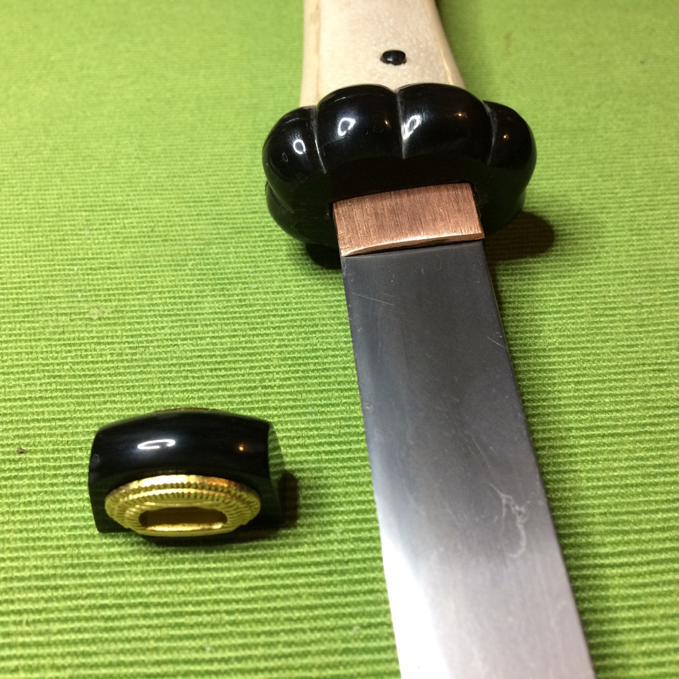

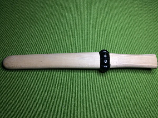

Artur DrogaMiecza Posted February 7, 2019 Author Report Posted February 7, 2019 I like buffalo horn a lot. It's simple and elegance material, easy to work with. I cut out nakago-ana and koiguchi holes, fitted the lines so that there were no gaps. Then I rounded it up, and I have marked the place where the flower petals will be... After polishing: 3 Quote
