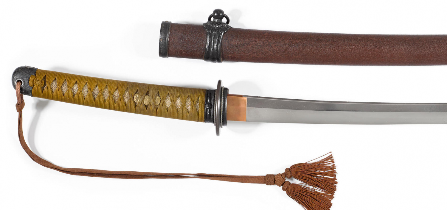

george trotter Posted June 3, 2019 Report Posted June 3, 2019 Just surfing the net and found this Type 3 (Rinji Seishiki) with silver mon that was in a Bonhams Auction. Seems to be special order fittings, Gendaito blade by Noshu Kaneshige dated 2/19. Mon is described as 'wreath'. Only one photo from the side. The site allows a large magnification and looking closey it certainly does seem to be a flower type mon (maybe kiku?). Have a look on http://www.bonhams.com/auctions/22965/lot/74/ (click on pic and click again to look closely) Certainly seems to be the SECONd mon we've seen on a Type 3. Regards, Quote
Bruce Pennington Posted June 3, 2019 Author Report Posted June 3, 2019 “this "desperation" officer's sword.” Really? So “desperate “ it’s in high-quality “non-desperate” koshirae!!! Ha! The lengths people will go to, to spice up the sales pitch! 1 Quote
george trotter Posted June 3, 2019 Report Posted June 3, 2019 “this "desperation" officer's sword.” Really? So “desperate “ it’s in high-quality “non-desperate” koshirae!!! Ha! The lengths people will go to, to spice up the sales pitch! Yeas Bruce, I noticed that too...some desperation sword...did you see the price?. You didn't comment on the mon...Did you enlarge the pic and have a look at it? Even though you can only see the side quarter of the mon it is clear that it is definitely the real thing...a mon of a flower or something! This makes two proper mon seen on the Rinji Seishiki (Type 3) now. I think we can accept that they do exist. Regards, edit to add picture from Bonham's site Quote
Bruce Pennington Posted June 3, 2019 Author Report Posted June 3, 2019 Yes, and I believe I’ve seen it once before. If I can find it, I’ll post it here. Honestly, there’s no reason a guy who has a mon wouldn’t put it on a Rinji as well as any other. Like Nick says, they’re all gunto. 1 Quote

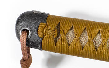

george trotter Posted June 4, 2019 Report Posted June 4, 2019 I managed to copy the pic in closeup...not the best but you can see the "flower" edges of the mon. 1 Quote
