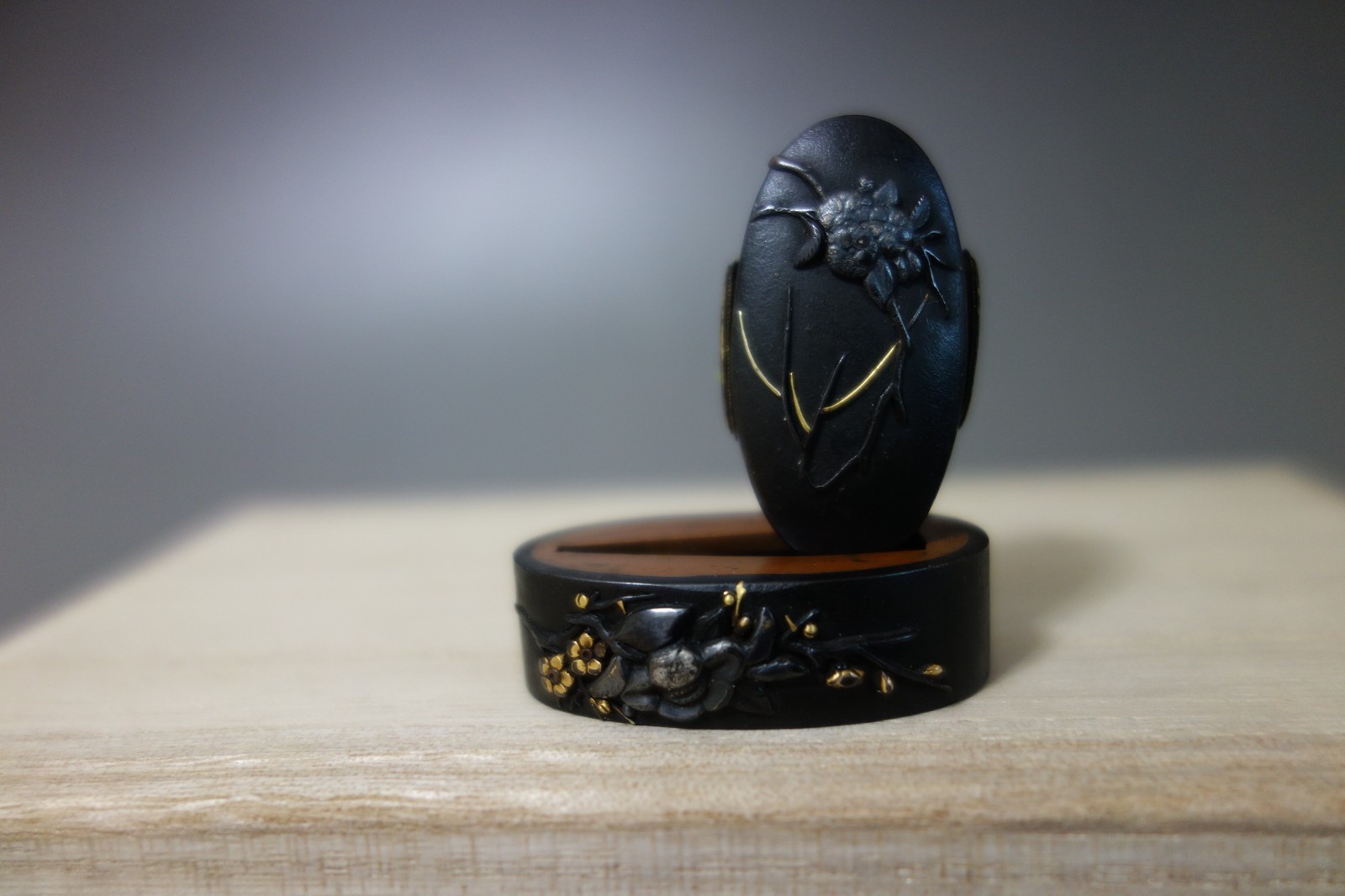

Am I correct that the first example here is cast, maybe carved? I do not see any inlay marks nor on the inside marks to bump the section consisting of the branches and flowers upwards to be worked.

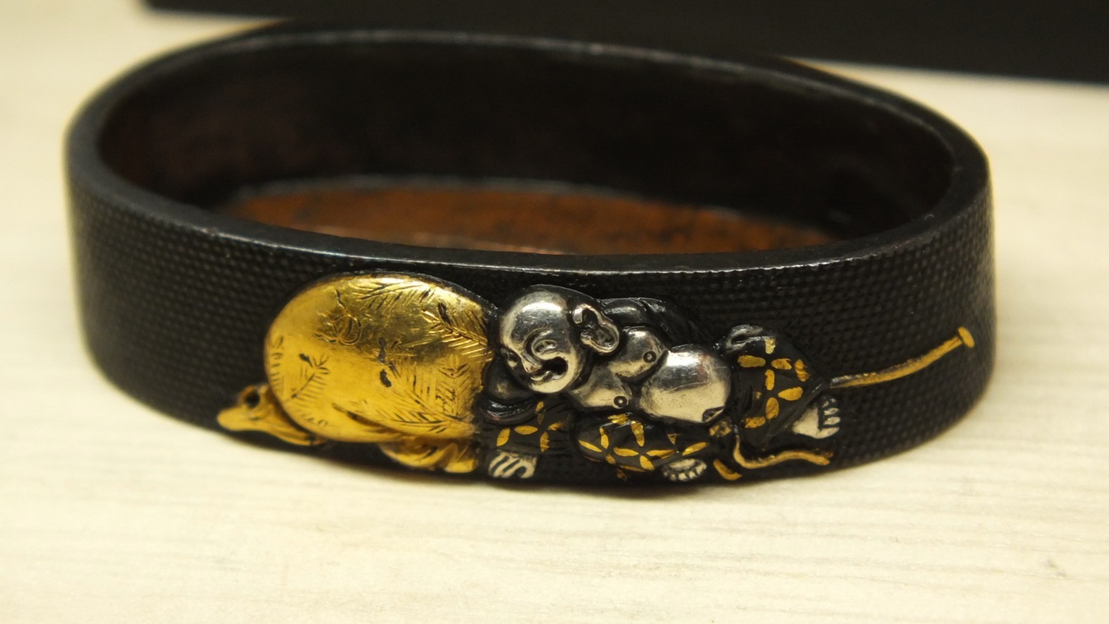

Then there is this piece, which I am pretty sure is inlays and carving, and appears to be of a higher quality then the former?
I would say the first is higher quality, and then defer to the experts to school us on technique!  my guess is the "soten" piece has no inlay but plate guilded (?hira zogan?).
Interesting. How come you think the first one is higher quality? I'm a greenhorn at this so any input is appreciated. Personally I find the first one a bit cluttery versus the Hotei one, although I enjoy it too.
Maybe it's the not stellar photos versus for example this better photographed one, showing among other things the blue hue of shakudo much clearer.

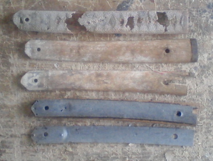

 What I have done in the past, has been to buy an old stripped tsuka core of the right size, open it up and recut the interior to fit the new nakago. Then buy in the fittings of the right size. Not perfect I know, but you do end up with something that looks OK, Funnily enough, when I have opened some of these up, I have found evidence that I was not the first to do that with them, and that it was done quite some time in the past.
I have also used original cores as a model or pattern when I have wanted something that I could not buy in good enough condition.... This is why I have a collection of original, but varied and sometimes poor condition tsuka. Shin Gunto are the easiest, but it works for others as well.
