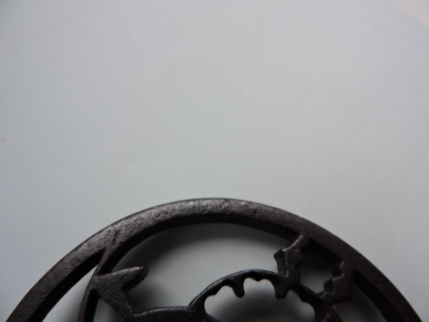

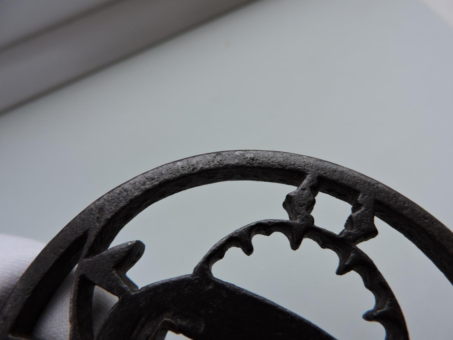

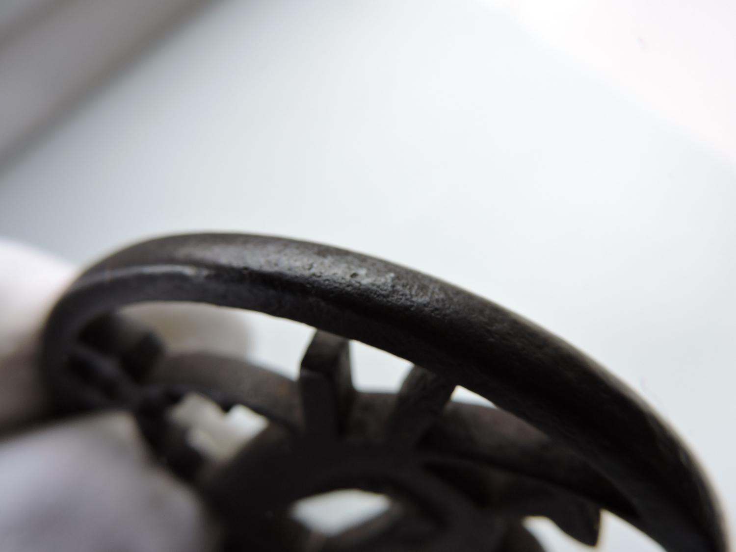

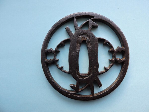

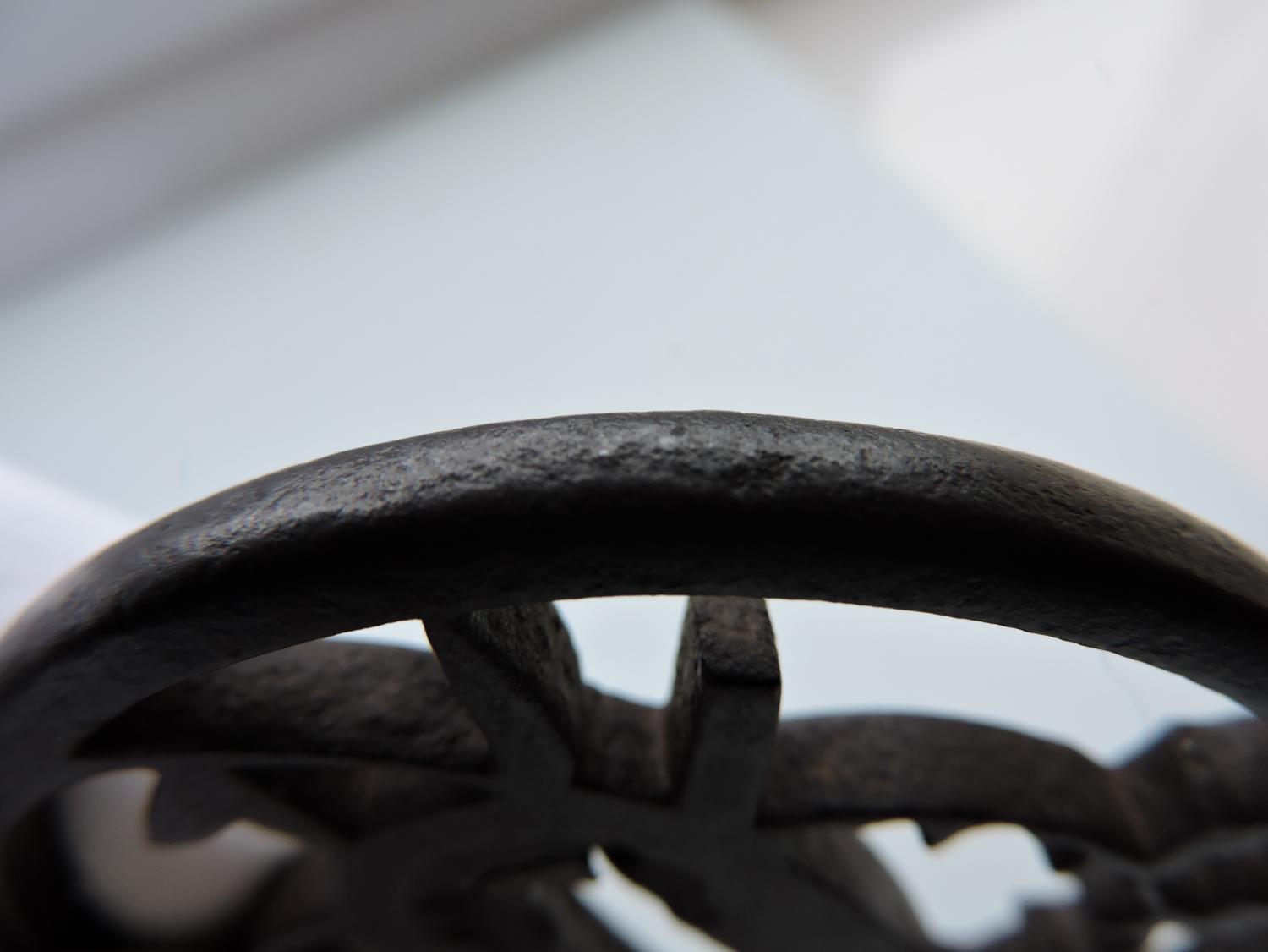

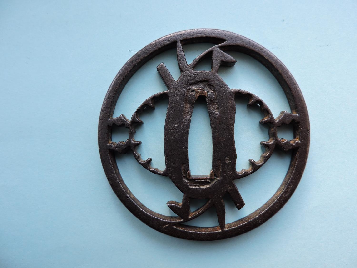

Last bag of bones for you, this time Kanayama, which are supposed to have lots.  I’ve seen pictures of  three Kanayama tsuba with tekkotsu described by the same author in the same catalogue as ‘extremely fine….typical of this school’, ‘strong’ and ‘exploding’ (the explosions being put down to carbon in the iron)  It’s the first time I’ve ever heard of carbon exploding, except in gunpowder!
I believe the tsuba I have once had a NBTHK TK certificate, now lost.  A similar tsuba is on sale with Seiyudo, so I’m happy with the assignment.  There may be some tekkotsu on this tsuba, but it is on the feint/fine side of the spectrum and difficult to photograph.  There are grey patches on the side of the rim, which are not prominent.  Maybe a few more years of rubbing against clothing would have exposed them more (according to some pundits).  There are some small specks on the rim.  If it has tekkotsu, they are not worth raving about.
Finally, I must apologise for a couple of my posts.  I don’t believe the Kuninao tekkotsu are genuine (I indicated they were not).  Nor do I believe the two etched tsuba can be considered as displaying tekkotsu.  Etching iron is likely to preferentially dissolve the harder iron, so the bits left will be softer iron.  Not that it excludes them from being described as tekkotsu, as Ford points out (and I have read elsewhere) there is debate whether tekkotsu are hard or soft iron.  I really added these to expand the debate, especially as when I get the chance to handle a tsuba up for sale, described has having tekkotsu, I often find it difficult to see anything.

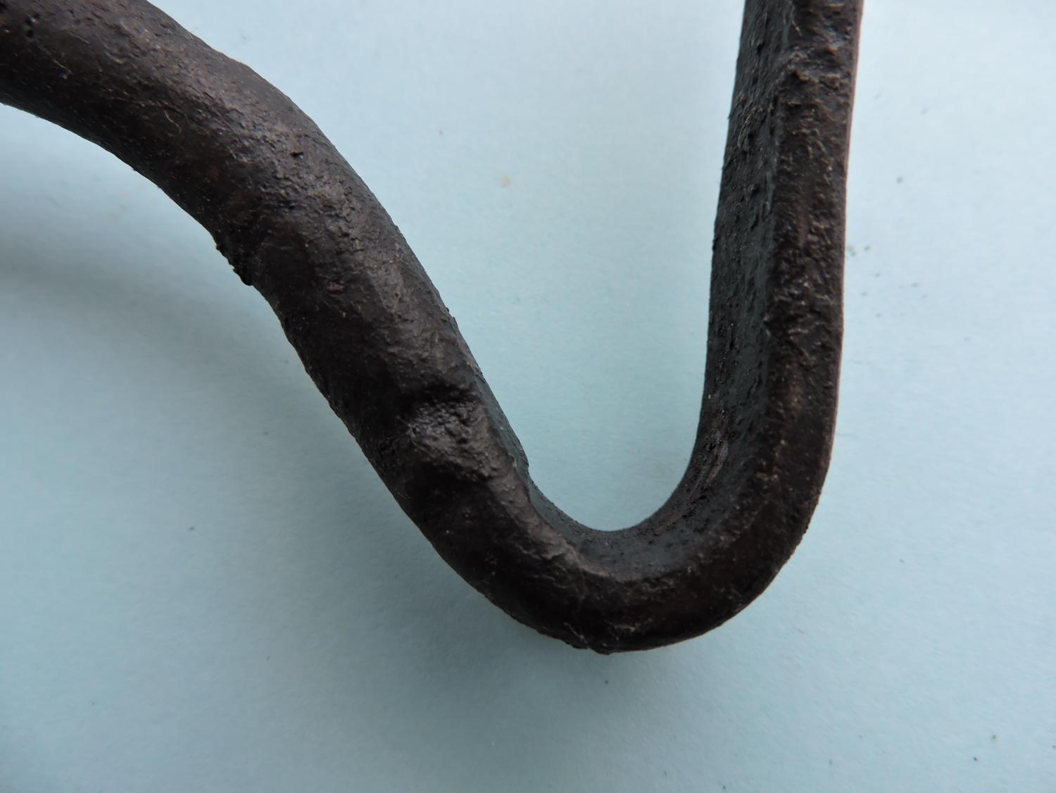

And finally, a pic of some fire rake that I made on a one day blacksmith course.  The material was modern homogenous mild steel.  I left the rake in the fire too long before the final quench and it got burnt.  I’ve seen worse lumps and bumps on tsuba described as tekkotsu, so buyer beware.
Best regards, John
(just a guy making observations, asking questions, trying to learn)
