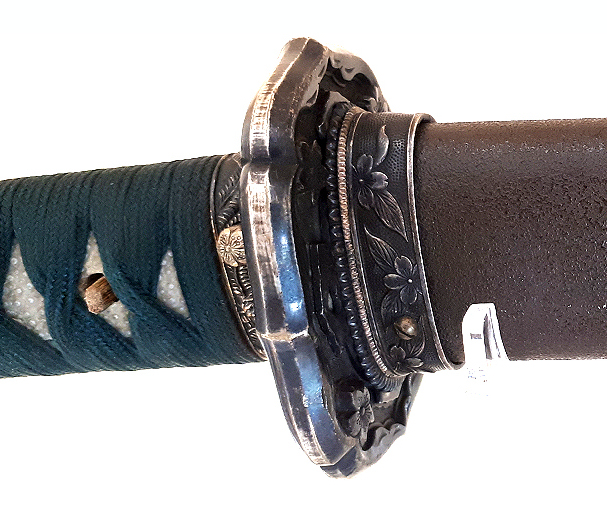

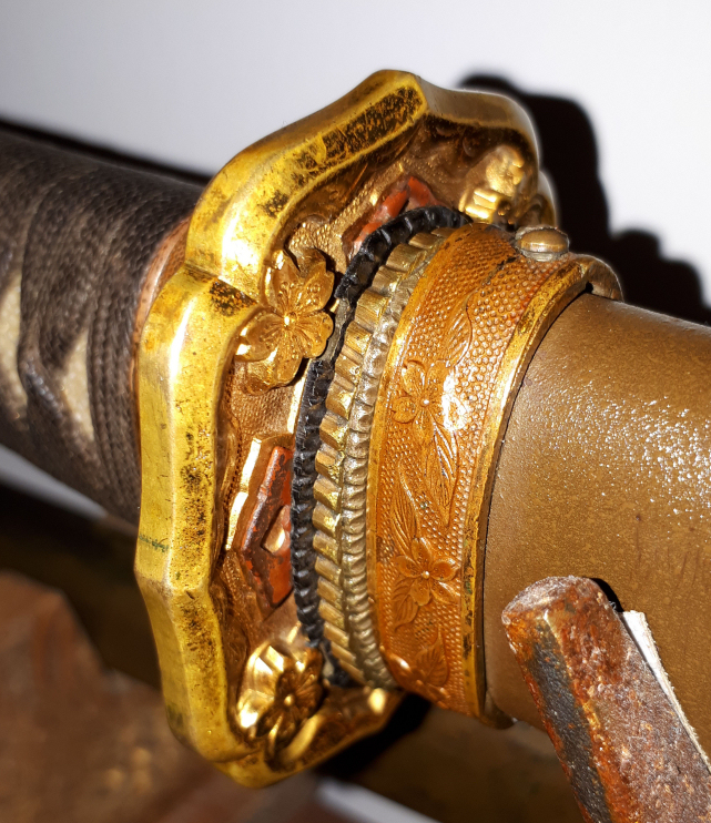

post-3496-0-74954400-1548271586_thumb.jpgpost-3496-0-05646900-1548271597_thumb.jpgpost-3496-0-44810900-1548271608_thumb.jpgpost-3496-0-55013000-1548271616_thumb.jpgpost-3496-0-43526000-1548272097_thumb.jpgpost-3496-0-95706400-1548272315_thumb.jpg
1. Army civillian Koshirae (no sword) Type 98 (silver plated fittings)
2. Kanenori Showa-to Type 98
3. Morinobu Gendaito Type 98
4. Kanemitsu Showa-to Type 98
5. Munemitsu Gendaito Type 3
6. Shingunto (ShinShin-to) Type 98
