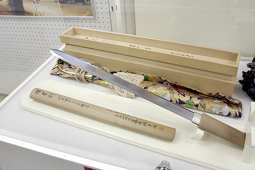

Nobody Posted August 5, 2009 Report Posted August 5, 2009 Sorry for rehashing this old thread. I accidentally found this sword today. The sword is named Insei-ken (隕星剣). It is made by Fujiyasu Masahira (藤安将平) in 1992. He is a sword smith in Fukushima-ken. The customer and the present owner of the sword is Mr. Ohno Hiroaki (大野裕明). He purchased 30 kg of Canyon Diablo meteorite for this purpus. The sword is a ken, and its blade length is 40 cm. Ref. http://www10.ocn.ne.jp/~space84/inseiken.htm Quote
Brian Posted August 6, 2009 Report Posted August 6, 2009 Fantastic find Moriyama san! The mind boggles at how much 30kg of meteorite must have cost Brian Quote
