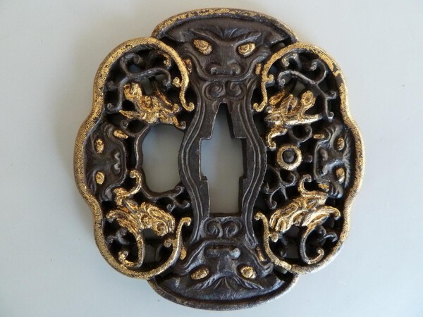

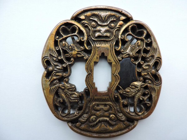

JohnTo Posted January 23, 2019 Report Posted January 23, 2019 Hi Guys, Grev asked for examples of non ferrous Nanban tsuba. Here is one, together with an almost identical one in iron. Both have animal/demon masks at the top and bottom (the iron one has them at the sides as well) and have dragons in the side panels. The brass tsuba has pearls in inome bori (boar’s eye, heart shapes) piercings at the side. The iron tsuba has some gold nunome and the rim of the brass tsuba may have traces of gilding. The brass tsuba has copper seki gane in the nagako ana, indicating that it was mounted, and a shakudo plug in one of the ryu hitsu (must have been quite an effort to have shaped that!). The Compton Collection had a similar brass tsuba (Part I, lot 100) which was described as a Canton tsuba from ca. 1600, with no ryu hitsu. Reading between the lines from various sources (I don’t have hard evidence) it would appear that this style of Nanban tsuba originated in China (Canton) and was exported to Nagasaki, along with Chinese craftsmen who set up shop there. From there they migrated into the adjoining Hizen area where the tsuba became more Japanese (e.g. nagako ana lost the square shape of these examples) and possibly kicked started the Hizen style sukashi (100 monkeys, etc). Best regards, John (just a guy making observations, asking questions, trying to learn) 1 Quote
