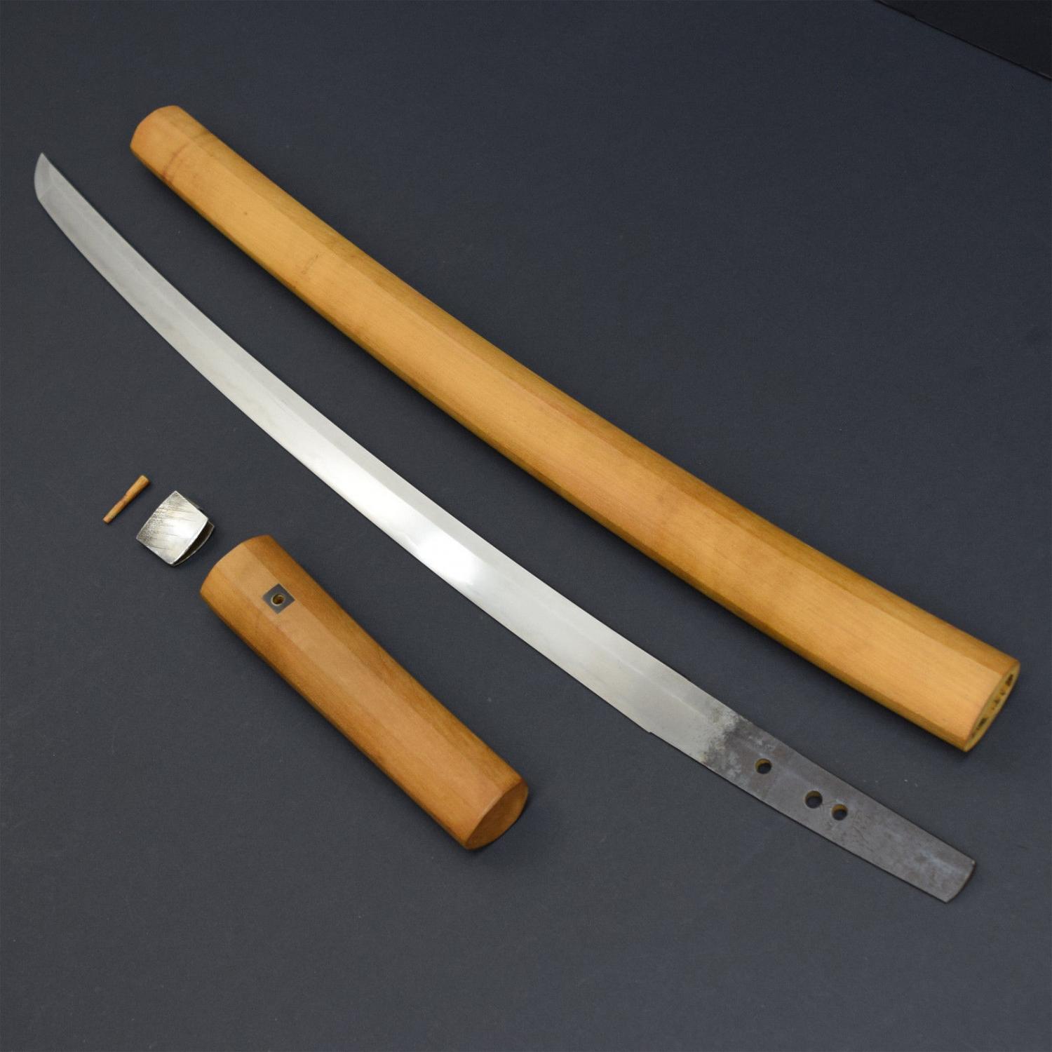

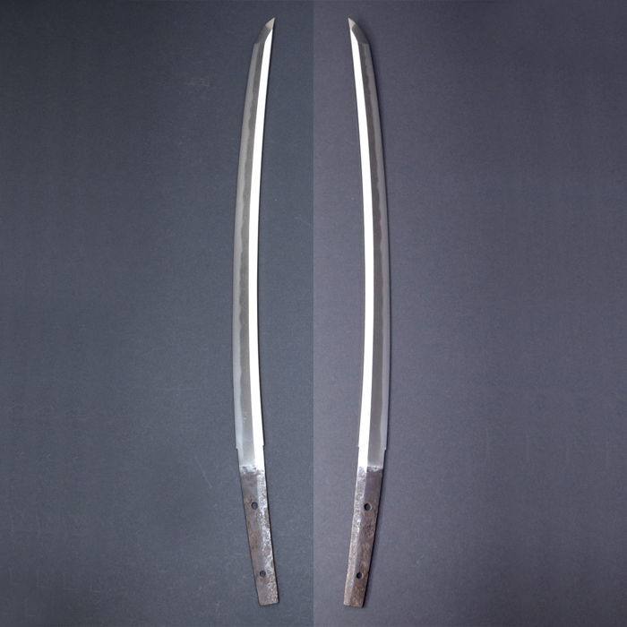

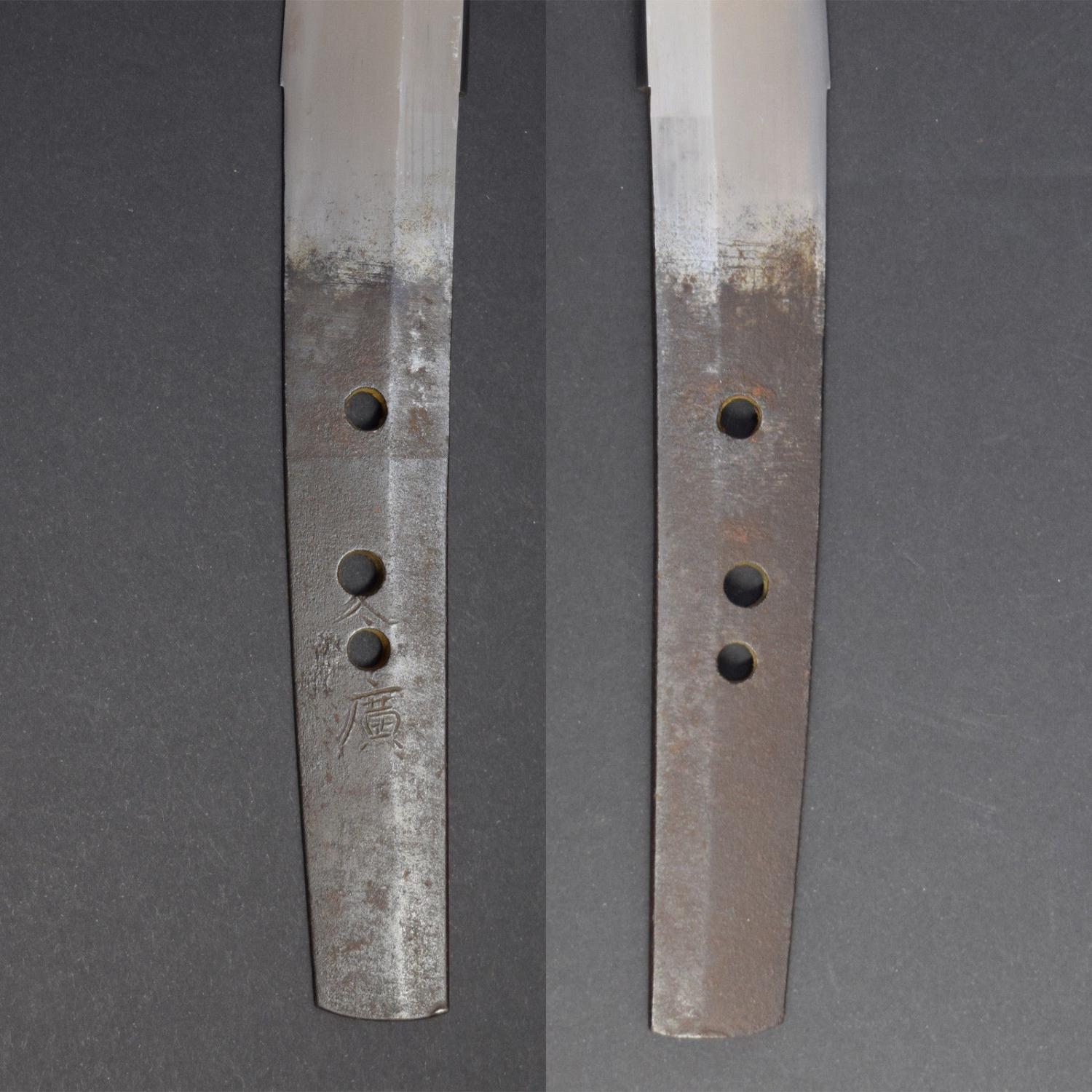

Ohtar Posted January 15, 2019 Report Posted January 15, 2019 i want to know the maker, i recived today and really liked very vell donne forge, muromachi era in my opinion, can you tell me something about the maker? i cant read kanji, and your opinion abouthis price? very apreciated i get it all clear but when i clean a little bit, next day the little inperfections see more dark like oxid old, not dangerous but you can see it more black in the little inperfections, otherwise i like a lot, can i clean this to make it clear again? thanks in advice. 1 Quote
Ray Singer Posted January 15, 2019 Report Posted January 15, 2019 Your sword is signed Fuyuhiro. There were a number of smiths of the Wakasa Fuyuhiro line during Muromachi and a few later. https://nihontoclub.com/view/smiths/meisearch?order=field_smith_start_era_value&sort=asc&type=All&mei_op=contains&mei=Fuyuhiro Quote
Ray Singer Posted January 15, 2019 Report Posted January 15, 2019 It is important that you not do anything in your own to remove the spots of corrosion you described. http://www.nbthk-ab.org/Etiquette.htm Quote
PNSSHOGUN Posted January 15, 2019 Report Posted January 15, 2019 Agree with Ray, don't do anything yourself. The polish on this sword is already perfectly satisfactory. Quote
Ohtar Posted January 15, 2019 Author Report Posted January 15, 2019 yes i kwew it, but the problem is the first day that comes i didnt see this spots so dark, and this morning i appreciate like if been darkest during 12 hours it can be posible, i looked a lot yesterday and today but im pretty shure the marks are darker than yesterday, thanks! Quote
Ohtar Posted January 15, 2019 Author Report Posted January 15, 2019 FUY42 Fuyuhiro Wakasa Kanshō (1460-1466) 冬廣 this one seems the maker is the only with the two kanjis alone, may be him? Quote
Ray Singer Posted January 15, 2019 Report Posted January 15, 2019 Eric, are you keeping the blade oiled? Quote
Ohtar Posted January 15, 2019 Author Report Posted January 15, 2019 yes i recived yesterday so not many time to oxid apeared right? maibe its paranoia, i use oil i read is usefull if you dont find choji oil is for guns, even leather, is red white and green the tube if i remember well Quote
Ken-Hawaii Posted January 15, 2019 Report Posted January 15, 2019 Any oil is better than no oil, Eric, but choji oil is preferred. Of course, choji oil is really plain old mineral oil with a "flavoring" of choji. Rust spots can grow overnight. Quote

Ohtar Posted January 16, 2019 Author Report Posted January 16, 2019 thanks a lot for the advices! whats your opinion about the quality of the blade? what is a got price to buy it, im a collector but still triying to understand the little details, regards! Quote
PNSSHOGUN Posted January 16, 2019 Report Posted January 16, 2019 If you got it for under $1k USD you did ok I suppose. Quote
DRDave Posted January 16, 2019 Report Posted January 16, 2019 I think I'd value it at more than that. What are the dimensions? Also interesting that in one photo, the habaki looks copper, and in another, silver. Same habaki? Quote
Ohtar Posted January 17, 2019 Author Report Posted January 17, 2019 sorry the first picture is other of my collection , the other photos are form silver habaki one, the size i think is Blade length:50.7cm/ 19.96 inches Curvature: 1.3cm / 0.51 inchesTotal length: 73.0cm/ 28.74inchesWeight: 747.0g Quote
Ohtar Posted January 17, 2019 Author Report Posted January 17, 2019 then i real do a great buy, almost half of it, plus shipping of course Quote
Marius Posted January 17, 2019 Report Posted January 17, 2019 On 1/17/2019 at 4:41 PM, Ohtar said: then i real do a great buy, almost half of it, plus shipping of course Eric, It was a good buy, no doubt. You have a real Japanese sword which has't cost you arm and leg Keep in mind though that you have bought this wakizashi on eBay, from a Japanese seller ("katana-boutique"), who sells tons of low end swords. You have to assume that for those $500-600 that you have apparently paid it is gimei (fake signature). Your sword has a signature of a rated smith but no NBTHK papers so it is almost certain it is gimei. This is not tragic as 99% signatures on unpapered nihonto are fake (correction: og unpapered nihonto coming from Japan through eBay and other online sites). But you haven't hit the jackpot and you should be aware of that. Quote

Ohtar Posted January 21, 2019 Author Report Posted January 21, 2019 for me one of my better blades, is forged almost perfect, the 3 holes one cutting the signature seem 3 diferents mountings so its old and why gonna erase a part on the signature on porpouse making a hole in it? i gont care if its gimei, the forger where ever who donne, donne a really good joob, its very well polish and beauty, i dont know many about the celebrity forgers, but of course so many donne blades many years, so 99% i thing its a little bit exagerated, i have mumey with paipers too, i trust them too Quote
Marius Posted January 21, 2019 Report Posted January 21, 2019 Eric, I understand you are unhappy with the statement that this blade is likely gimei. If so, submit it to shinsa (just joking). If you are happy with it, good, just enjoy it. That is what this hobby is for Before you comment my statement as an exaggeration, please read it: "99% of signed blades AND coming out of Japan AND via eBay or other online sites. That narrows it down, no? Of course you are free to think you have a shoshin blade (one with real signature) but if you want to collect and study nihonto, deluding yourself is probably not the best way to go. BTW, do you now the saying: mumei cannot be mumei? This means that ANY genuine nihonto that has no fatal flaws and is in an acceptable state of polish, will get an NBTHK Hozon. And yes, there are masterworks which are mumei. Nobody has made the suggestion here to remove the signature, or am I missing something? Again, just enjoy it for what it is. And a word of advice, as you seem to be rather new to this wonderful hobby. You might want to: 1. spend the money to buy books 2. study good swords in hand (going to Japan, to shows, et) 3. learn from other collectors (many good and knowledgeable people out there) After a while you will move up in your purchases, if money allows (this is not a cheap hobby). Oh, and please avoid statements like "forged almost perfect". You are not at the stage yet to say anything more than that you like a sword (neither am I, for that matter, after 15 years of collecting). Please accept it as friendly advice even if it sounds a bit patronising and harsh. Humility goes a long way when you are a "newbie". 2 Quote
