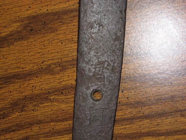

This piece came out of an estate sale in the NE US a couple of years ago. I bought it because I thought it was neat, hagire and all. I have been told by various "experts" that it is: Koto, shinshinto, priceless, worthless, fake, and even that it was a kabuki theatre prop. The man who guessed that it was used in theatre actually was very knowledgeable and methodical, and had good reasons for his guess (which is all he said it was...) but I think there is too much labor evident for this to be it.

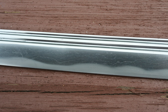

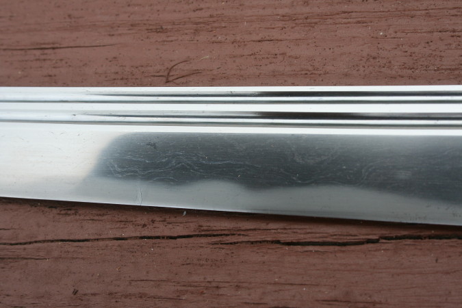

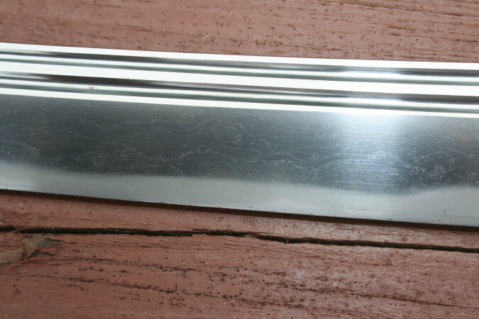

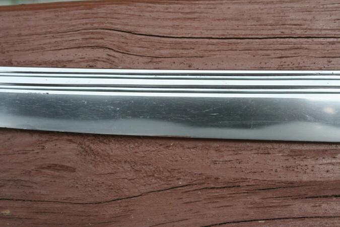

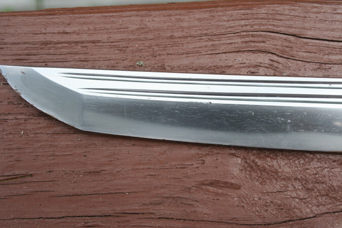

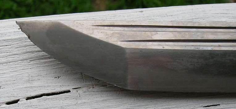

The "hamon" is lifeless, showing no nie or nioi, no activity...may have been applied by a polisher. However, the hada is beautiful, and the Futasuji-bi is well cut (to my eye, anyway). There are a very few small ware, and of course the hagire, but other than that it seems very healthy. What is puzzling is that if it wasn't very special to someone, (ie it's a shinshinto or a theatre sword), why would it have been kept with the hagire and hamon issues and not just tossed away? Could it be that it used to be a "good" sword and it was perhaps damaged by fire - which would "kill" the hamon - and later cleaned up by a polisher and kept as an heirloom? Why not make it a (very) O-suriage wakizashi and retemper it so as to get at least some use from it?

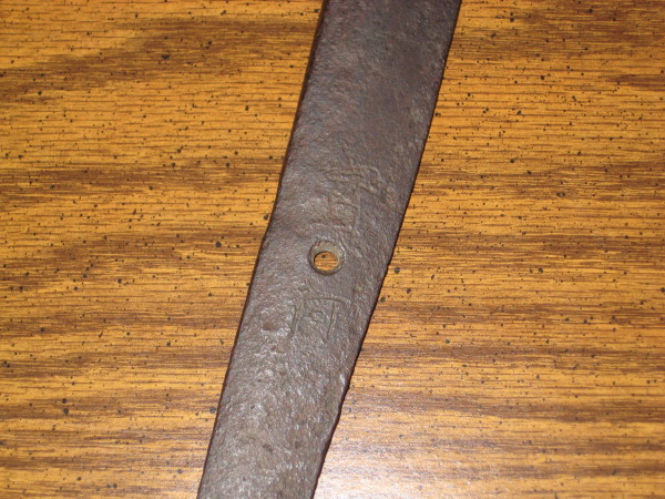

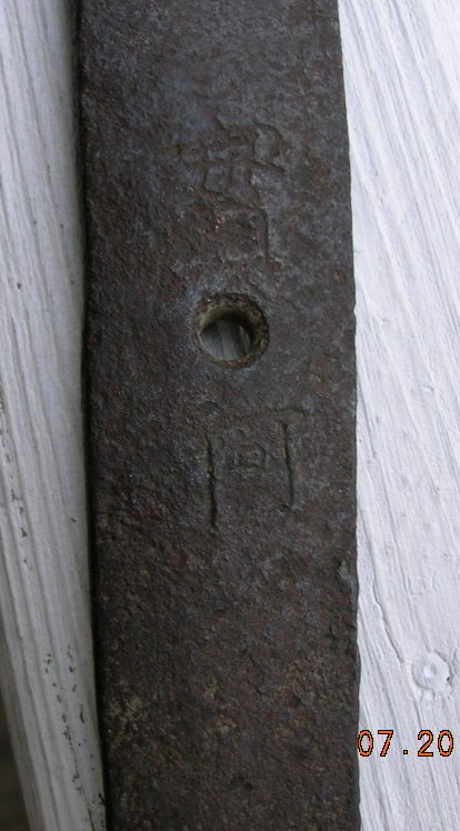

I have attached a couple of pics of the mei in different light - the darker one tends to make the nakago look more deteriorated and rough than it is. Can anyone read it?

Hi, Sorry I forget your real name, Although the pics are poor showing any hamon, something is showing up. Are you saying an etched hamon-like creation? The mei looks like ?-nata, Kiminata. Need the pros for this one. The hi are crisp it seems. So, a bad polish doesn't help. More pics in better lighting might display something. The sugata looks promising. John
Hi John,
I don't think it's the photos...there really is no life in the "hamon"...perhaps, if it was exposed to heat, the "outline" of the original hamon remains but all of the activity is gone...I have a re-tempered wakizashi and the area on it before the new hamon picks up looks lifeless like the tachi.
Don't think it's etched - perhaps stoned like when a keisho polish is applied?

The hi look much too well cut to not have been a decent sword at some stage.
The sugata is really lovely..that classic tachi shape. Fire damaged swords tend to have a lot of masame in the ji I think. Grey? did a good article in the JSSUS newsletter recently on what to look out for.

Another thing is the spacing of the kanji. Almost as though they were placed deliberately around the ana, and not before.

Very interesting sugata; I love it. Jitsua is a big name; the pieces in my references tend to be Juyo Bunkazia and Bijutsuhin. One tachi, in "Token Bijutsu" English volume 22, has the Kanji for Jitsua spaced widely on either side of the original mekugi-ana.
It's my understanding that the steel of early blades is softer, less brittle than that of later periods (Kamakura as opposed to Sue-Koto or later). This would explain why the kissaki has been dented, not chipped.
Jitsua worked with high shinogi, wide mune, and itame hada, dense, whitish, and with an underlying mokume. Hoso suguba (narrow) and Ko-Midare, and activity isn't expected. The color of the ha is black and there is a little bit of dense nie. (Thanks to Harry Watson's translation of Nihonto Koza.

This sounds O.K. so far, but what is actually irritating me is the very shallow curvature of the blade. The sword discussed by Tanobe-san is a shortened, but still signed, JuBi with nagasa 68.8cm and sori 2.3cm. Another shortened, but still signed, JuBi in the Kurokawa institute has a nagasa of 69.8cm and sori 2.6cm. The Juyo Bunkazai in the Atsuta Jingu has a nagasa of 83.7cm and a sori of 3.8cm. A feature all three blades have in common is very thin sugu ni komaru-boshi.

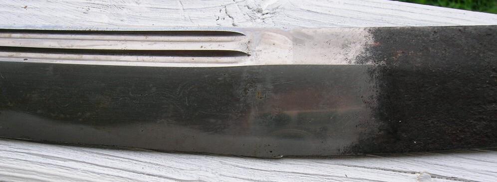

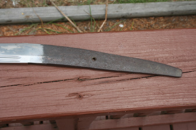

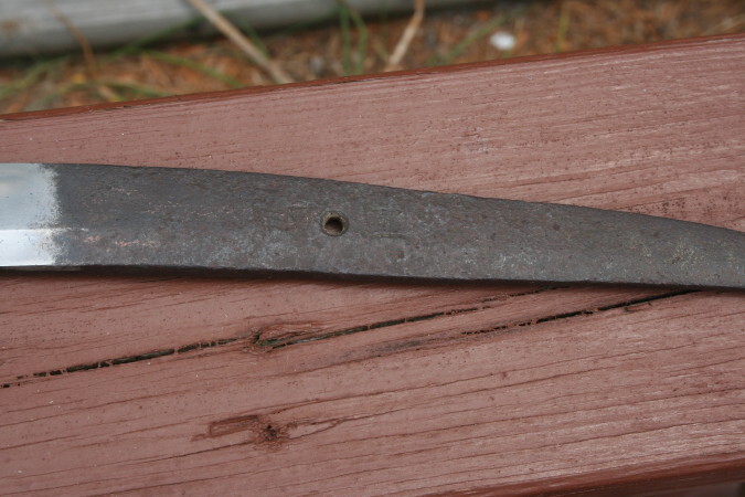

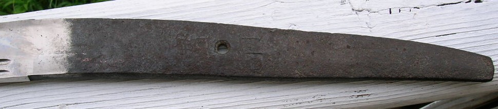

Retempering is a possibility that would explain the atypical curvature, the inactive hamon, and the ha-giri. How does the nakago feel: smooth and waxy or coarse and dry?
Grey
The nakago does feel smooth and "waxy" - a good description I'd not thought of...
As for retempering, wouldn't there still be some sort of hamon visible? This "hamon" doesn't show nie, nioi, or an outline when pointed toward the light. Isn't it possible that if for whatever reason the owner determined not to retemper the blade, they might have had a polisher apply a "hamon" for the sake of appearance? Or, perhaps the blade had a keisho polish before the fire; got hot enough to "kill" the hamon but not scorch the metal...would the outline of the keisho over the original temper not still be visible?
Also, Reinhard's comments about the sori - if the blade has lost its temper altogether, much of the curvature the original tempering imparted would be lost, correct? As a result, the sori of this blade would have been greater before the fire (if that's what we assume happened).
One nice thing I have noticed (photographic distortions permitting) is that if you follow the line of the nakago, from about 2 inches past the mekugi-ana the nakago kicks back. IE the curvature does not continuously follow its line. This is a typical feature on tachi that were adapted to be worn as katana.
If the nakago is smooth and waxy feeling then maybe the sword wasn't caught in a fire and maybe it hasn't lost its temper. Swords that have been burnt usually have a coarse, dry feeling nakago (unless they have been shortened after retempering to remove evidence of the retemper). They also can have fire scale, an uneven built up flake-like deposit. A good polisher, however, can make anything look right.
I recently owned a very early tachi that had completely lost its hamon to fire. Because it hadn't been retempered the curvature hadn't changed much if at all. This might be a possibility for your tachi.

Grey's description of saiha and fire damage is correct. To add to that, the condition of the nakago usually deteriorates quite badly as in your case, becoming rather pock marked etc. Photos are hard to judge, but it looks rather flaky of the photo. The following is serious by the way, but try smelling the nakago, to see if it has been adjusted or re-patinated using chemicals etc. Also, rubb your finger on it then lick your finger to see if you get that chemically taste or tingling.

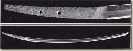

Here are two nakago taken form a recent article by Tanobe sensei on saiha. They are both by Yasutsuna. The one on the left is ok, the one on the right is saiha. BTW saiha or fire damage brings the same results to the nakago as the original patina is lost.

No chemical taste or smell. It also feels smoother than it looks. Took some new pics as a couple of the ones posted earlier make the nakago look more rough than it actually is. The second set I posted initially were taken on the kitchen table under a plain white lightbulb...the ones today were outside - partly cloudy and kind of overcast.
Also, you are correct about the "bent" nakago...I hadn't noticed it before, but it's not the photo. Nice catch.

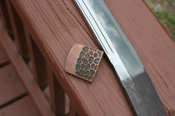

I'll also post some good pics of the hada...and for anyone who's interested, I'll throw in one of the habaki. :)
