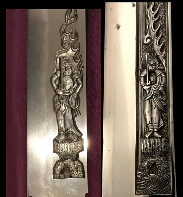

vajo Posted January 11, 2019 Report Posted January 11, 2019 Hmm the seller is a well known Nihonto dealer. Some show me the blade if i would be interested. I didn't like the sword. The horimono looks impressive at a first look. On a second you find much things that are not so nice. The mei didn't fit to Shigetsugu. Why the experienced seller doesn't compare his mei with the slough page he shows? Compare the two pictures. The left one is from a Shigetsugu Tanto of SwordGuyJoe (i hope i can show it here) and the second is the ebay offer. Two totally different carvings. Shigetsugu was a master of horimono. In the left there are so much details and effects. The right one looks more abstract. Quote
