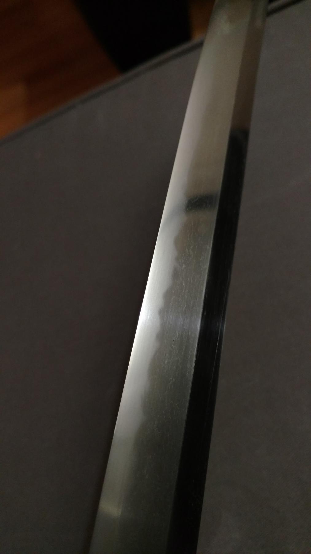

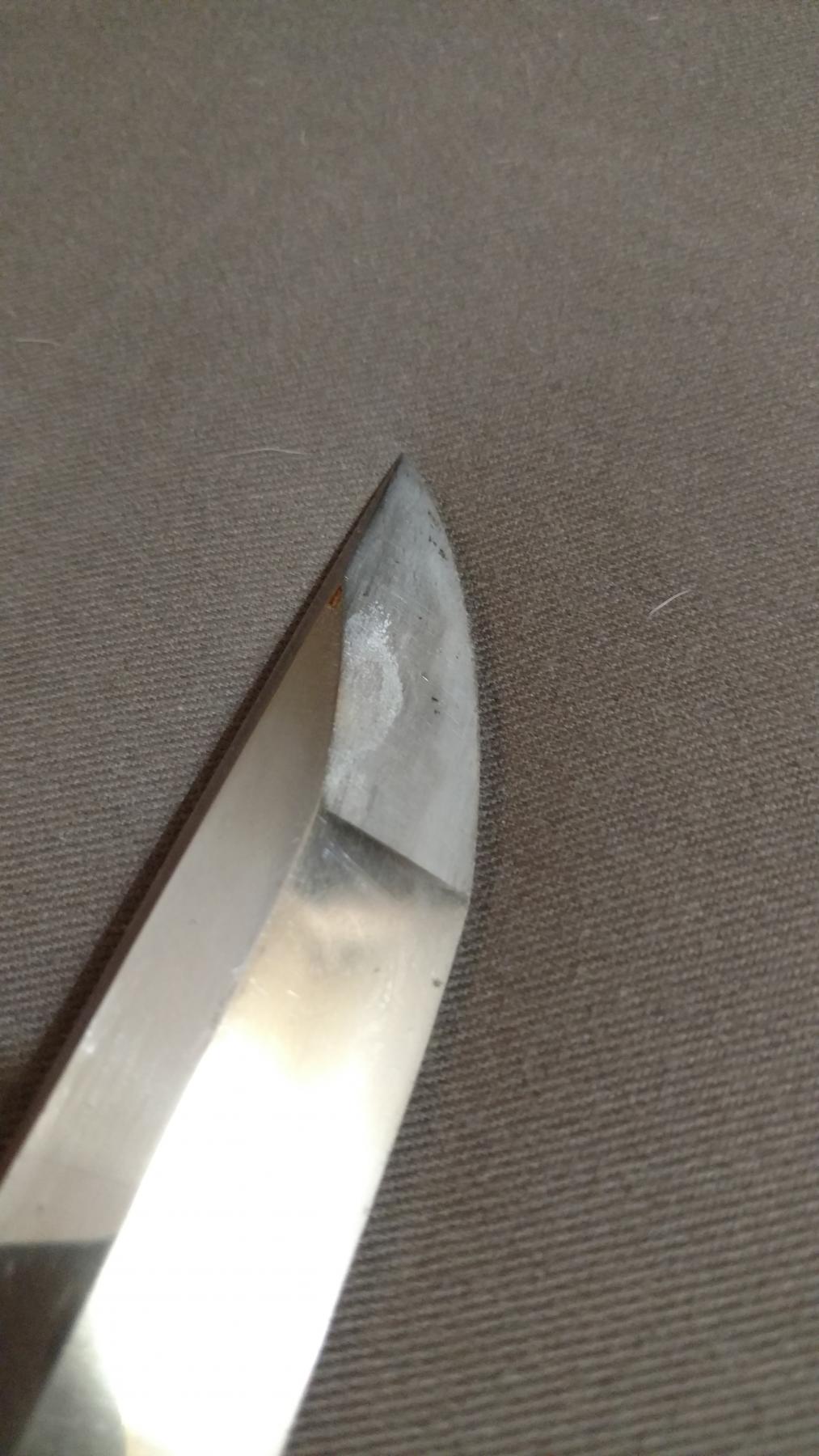

The Hamon and Boshi for Kanemoto are the easiest identifiers, so take plenty of photos of the edge and tip of the sword in lighting that highlights these areas clearly. Sunlight, downlights or a strong LED light, some acrobatics with position and you will be able to capture it.
Thank you for the advice. It turns out that I am an abominable photographer. I have attached some new ones that I tried to shoot; two on both sides. But I'll see if my husband can do better tomorrow.
Your photography is better than a lot of newcomers. And, I am even more convinced that your sword is worth keeping and preserving.
There is a what looks to be a horizontal weld opening near the tip in the shinogi-ji, and a spot of rust also near the tip, but I wouldn't freak out about these.

Your sword does not need a new polish, there isn't any serious rust or damage and the current condition is very good. Preserving it as is with a light coating of choji or similar light mineral oil on the blade and following the guide Grey posted will ensure the sword remains a family heirloom for generations to come.

That's interesting, because another fellow told me that I should have it polished before having it formally identified. He also mentioned the polish could be concealing the true hamon. (Remember I'm a rank amateur at these things!)
Posted (edited)
Hello,
Before proceeding to a full polish it would be wise to figure out more precisely what it is that you do have and, perhaps more importantly, what you don't have. A good first step would be to have a qualified polisher look your sword over and give you their thoughts, help you identify and explain if there are any problems. If all appears fine, the next step (suggest) would be to ask a polisher to open a window on the sword. Which is where a short segment of the sword is fully polished. This would provide you (along with any future buyer) with a peek at how the sword will look finished, and at the same time give the shinsa team a clear image to help them determine/confirm who done it. This will also help you in deciding how to proceed going forward, or not.

Andrew, congratulations for the nice sword. It is in well condition and the koshirae looks very nice (i like that kind of saya very much).
Your sword dont need a polish. You can see all what it will show. Take good care of it.
